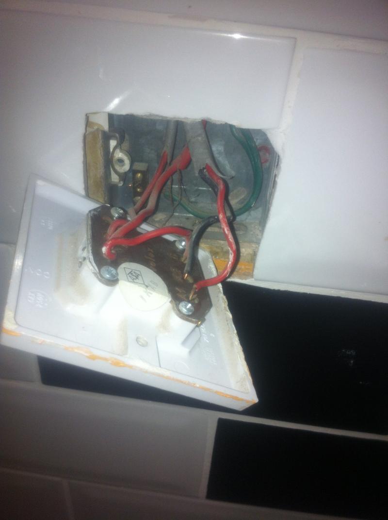

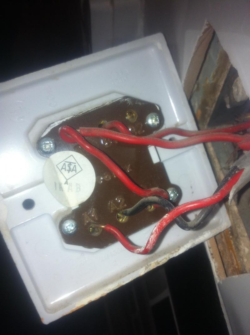

ok, I want to swap a "2 gang, 2 way" to "1 gang 2 way"
on my 1st switch, here is the config (Uploaded pic):
A B1 B2
A1 A2 B
on my new switch (1gang, 2way), its:
L1, L2, L3
On my 2nd switch its a 1gang, 2way: (this one controls my left light only for some reason??)
Com, L1, L2
i'm changing this one to a 1 gang 2 way also. L1, L2, L3

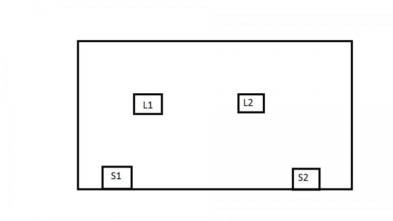

S1 = 1st switch
S2 = 2nd switch
L1 = Left light
L2 = Right light
So basically I want both lights to go on and off together with either switch. How do i go about doing this?? thanks.
It's not possible by altering the switch wiring.
You will have to connect the lights together in the ceiling.
This MAY be possible by just altering the wiring but it depends on the routing.
Pictures of the light wiring may help.

hi yes that is correct. I will try and upload a few more pics of the light wiring within the next few days. thanks.
