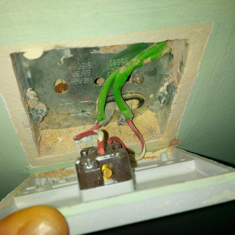

I bought a dimmer light switch with metal faceplate and went to swap it out for the old rocker switch but noticed the installed rocker has two red wires and no earth so I cannot use the new dimmer so I'll swap it for a plastic one.
On the old switch I cannot see anything to indicate COM or L1. Does it matter which red goes in COM/L1.

I echo the above comments on a standard one way rocker switch it will not matter which terminals you use for the perm/com live and the switch live/L1.
The switch may appear to be upside down, it will just require spinning around.
If a metal switch plate is desired, double check the sheaths of either cable if singles or the one sheath if a twin. They have in the past been cut back and they can be extended via connector in the backbox. As previous post even if an earth core is present it will require to be confirmed that is actually connected to earth, there is a good chance if one earth core has been cut back others will have also, so you would have to remedy them all, to get continuity.
Note: If you do fit a dimmer for rocker, follow the manufacturers instruction on lamp types that can be controlled and the way the com and L1 should be connected.
The wiring could also be enclosed in metal conduit, that "could" provide the earth connection. That's why i requested pictures!

I've attached a picture but I'll probably go with advice from. The above.

The green sleeved wires are your earth, connect an earth to these and then your switch earth terminal.

The picture shows two green sleeved conductors that are terminated to the backbox, so the cores are there, they now need to be proved that they are earthed. So continuity tests are required.
If you have one solid/rigid lug on the backbox, then the switch plate does not require earthing, but belt/braces I would.
But looking at the backbox, I do not believe your dimmer will fit to it, as the backbox is too shallow and requires replacing with either a 20mm or even a 35mm.
That's the earth all right.
We often advise you to check that the earth wires are in fact connected to earth, though not something a DIYer can necessarily do successfully.
Spacers are available to go between the switch faceplate and the wall, to save you sinking in a deeper box. These are usually plastic, so a plastic switch may be best.
The spacers make the switch look a bit naff, but will do until you redecorate.
