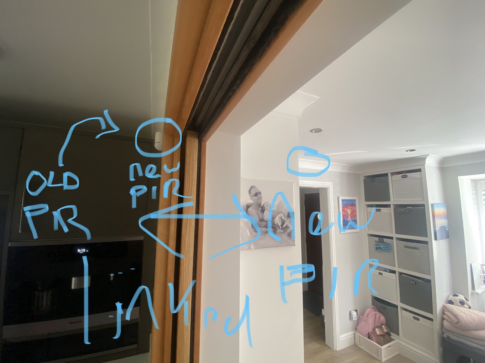

Thanks for taking the time etc to help me with this, but that doesn’t work but trouble I have is these Two PIR are both wired into the wall in seperate rooms but back to back but there’s a bespoke bookcase been built around it, so I can’t confirm if I’m running the 2 wires onto the next one or not.

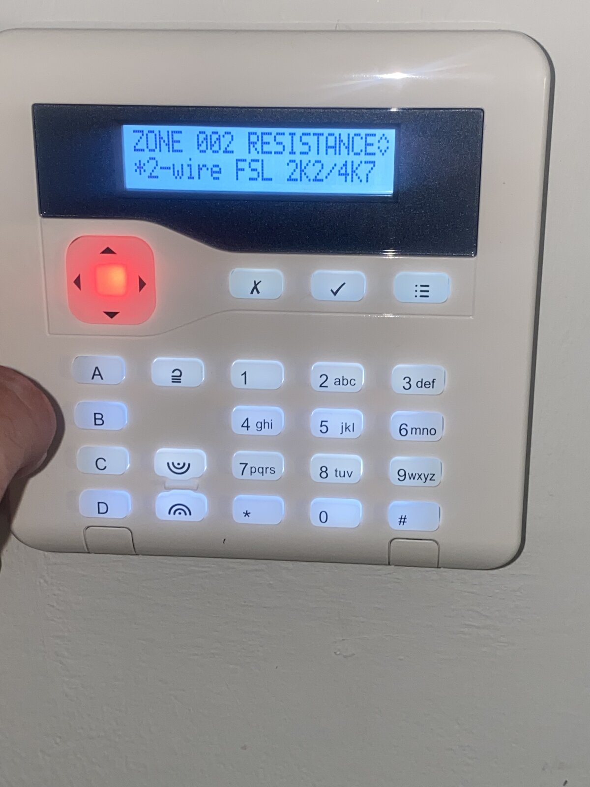

It seems to be a power issue with them not a tamper, I’m getting 0v but there’s a signal on the lines so it’s connected ted to something

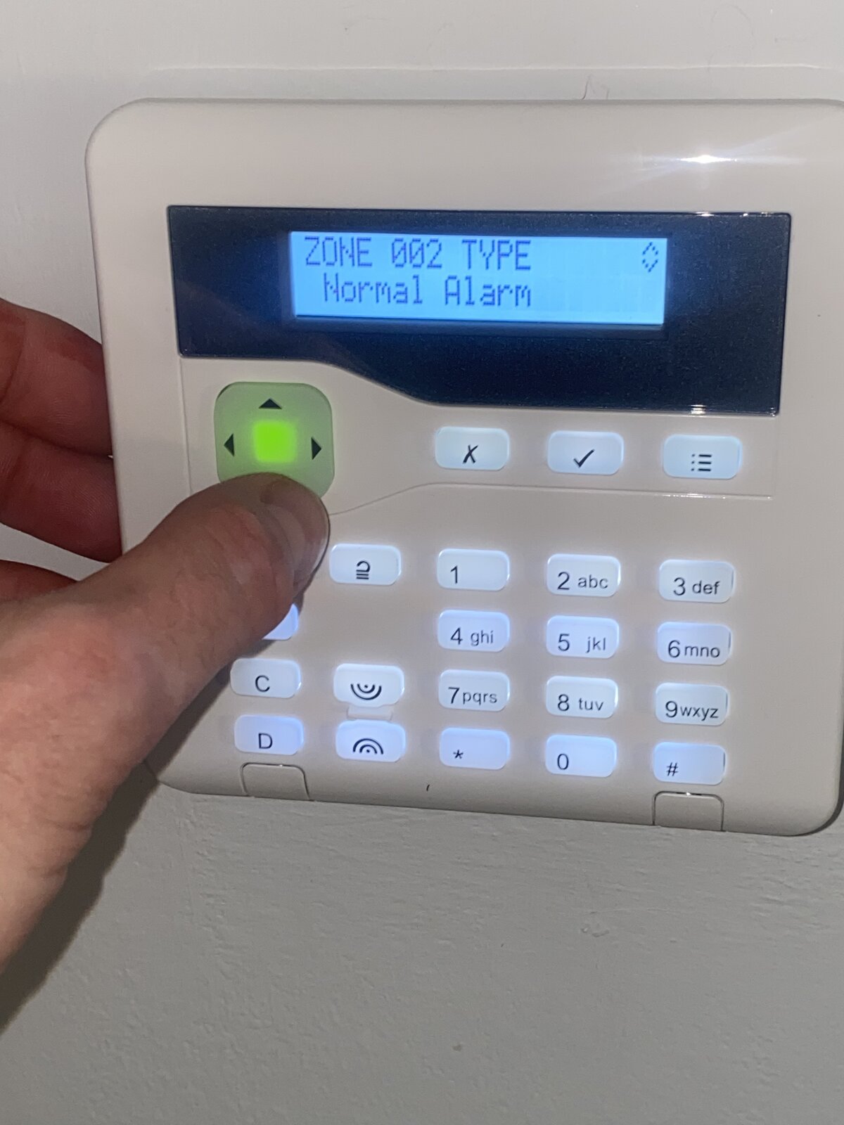

Also confirm that programming is correct for the zone being used on control panel.
If all the above is correct then post photo of each detector wired, and how these cables are connected to panel.
Yes I do and I’m looking for resistance or voltage? Here?

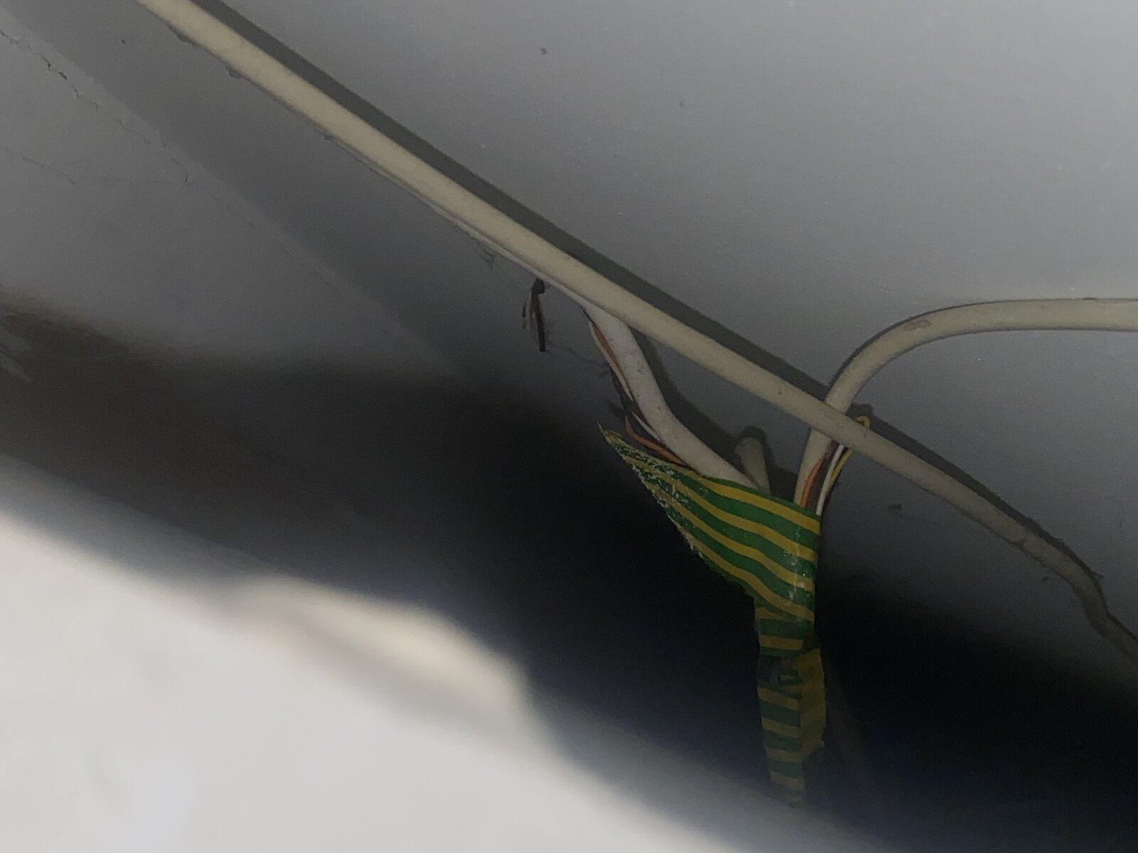

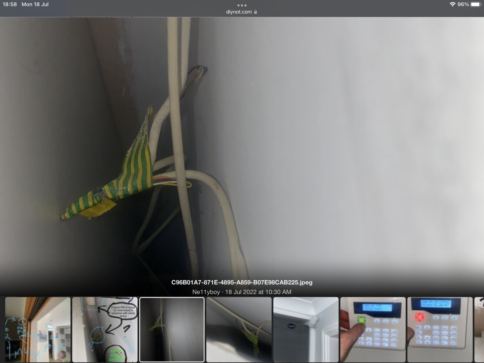

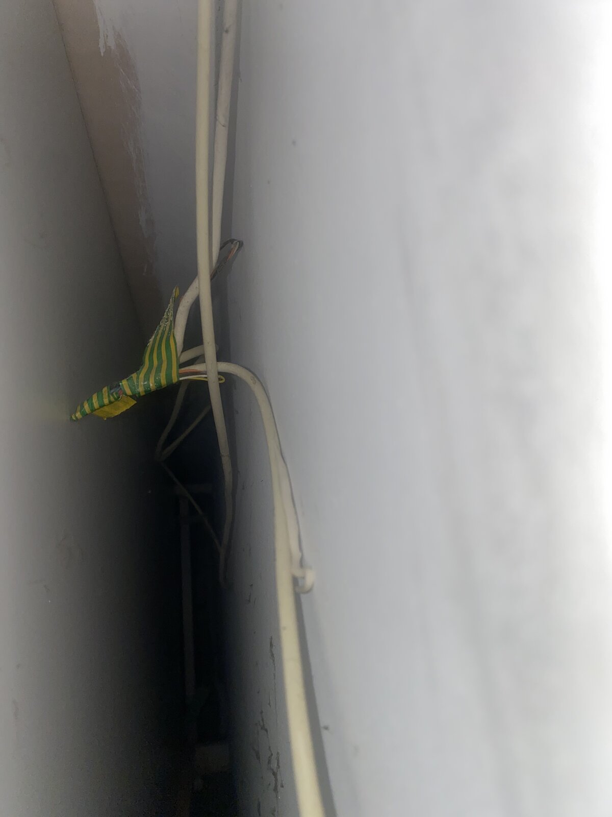

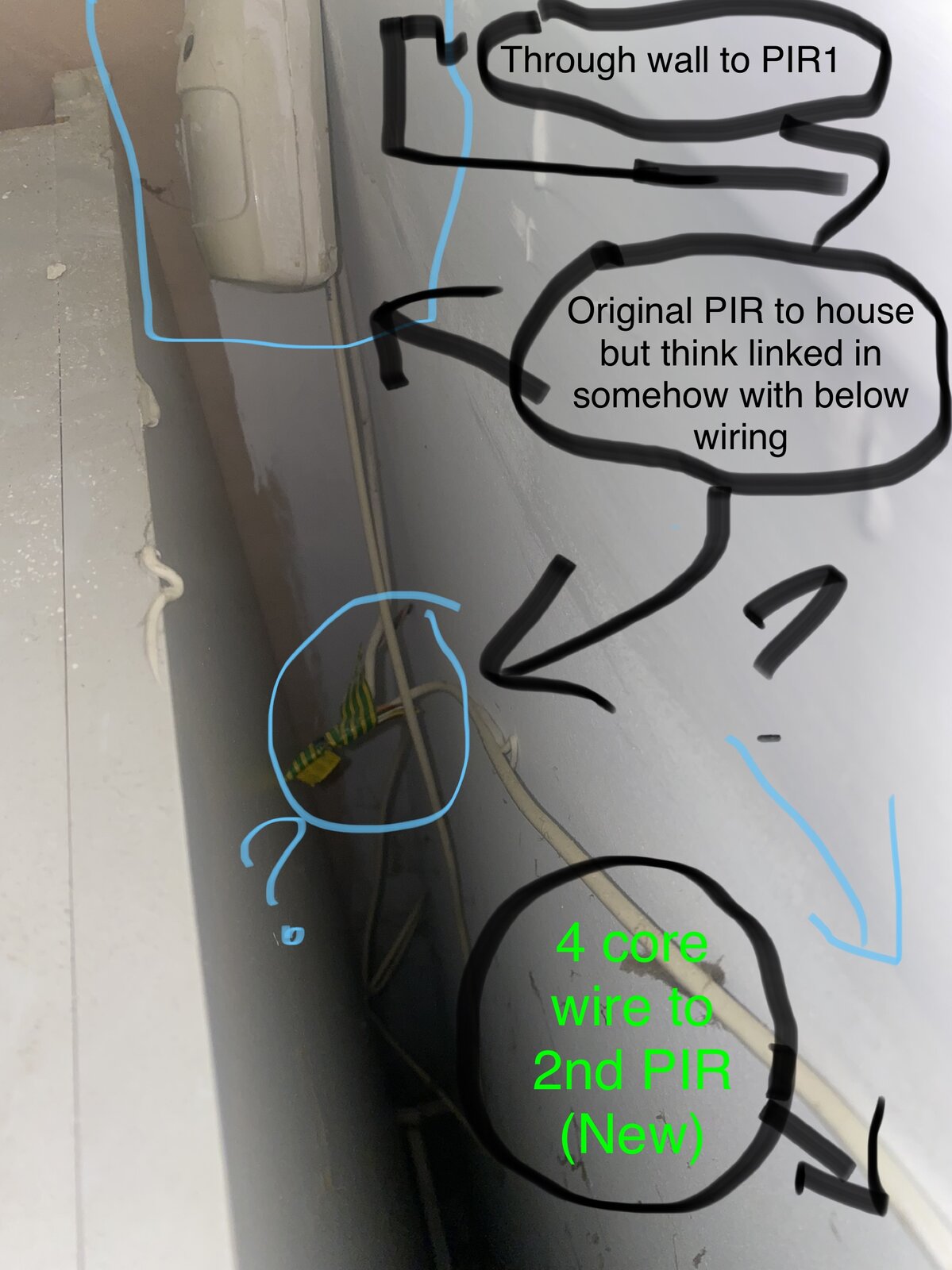

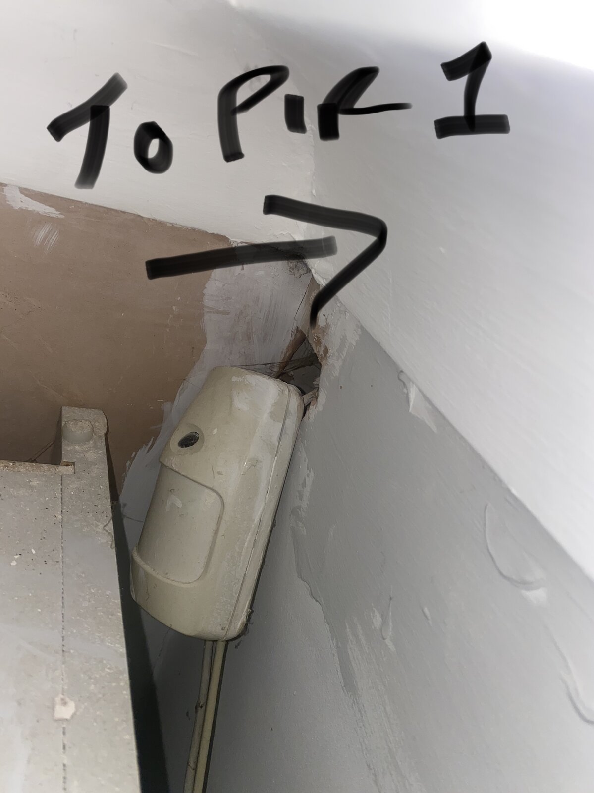

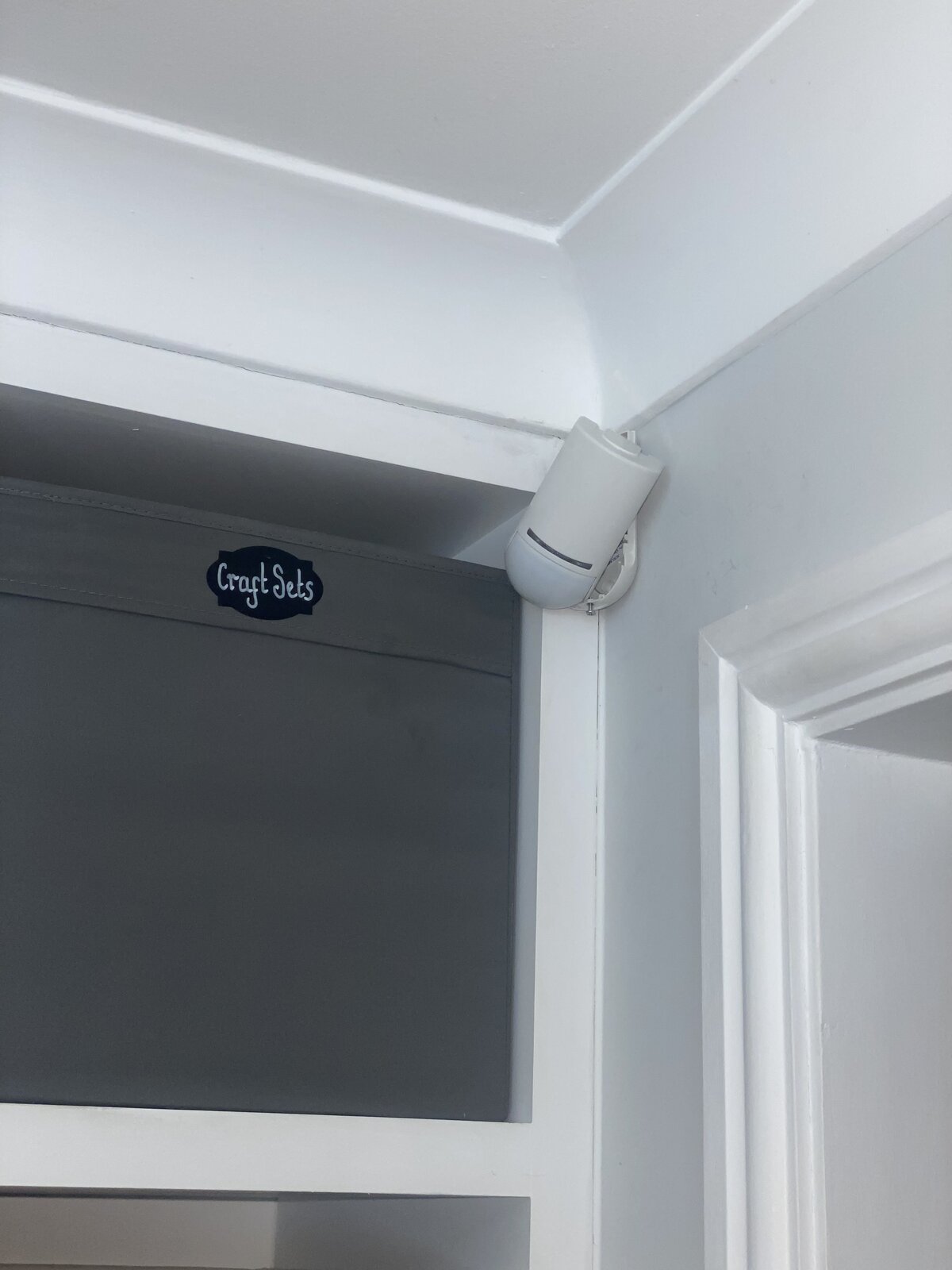

I’m pretty sure when they wired this section up we had an issue where the PIR in the kitchen was left in the corner, kitchen fitters built the cabinets and when the alarm people came they couldn’t get to it, so they spured off the one in the next room which is right behind it.
Would they have used the OLD PIR for anything or left it redundant?
Or use as like a junction box?
Taken some new photos, so you can see what I mean and small diagram, thanks again pal,
This one does feel above my pay grade but I’m learning all the time……
Right pics of this HASH up
See if you have any clues?
So they are behind each other but hardly accessible and have this link of wiring with the old PIR I have just found….
Be good if I could speak to the installer but as I mentioned earlier, he’s passed away…..

Did the installer ride a horse ?
Any way how many cables in the one they have spurred off from ? And what are they ? 6 core ? 4 core ?
The problem you have is proving the cable and the joints are poor.
What about fitting wireless expander unit and fit wireless PIR'S in new positions.
Looking at the the old PIR'S they need replacing anyway.
Think he had a mask and the horses name was Tonto
What Acessable is 4 cables at both PIRs
red
Black
Yellow
blue
back at the panel however, there is 8.
so I’m guessing they cut off the remaining ones at the PIR
they we’re wired with only using the 4 above originally.
They are brand new but the one in the corner is an old one but looks like they used as a junction box
