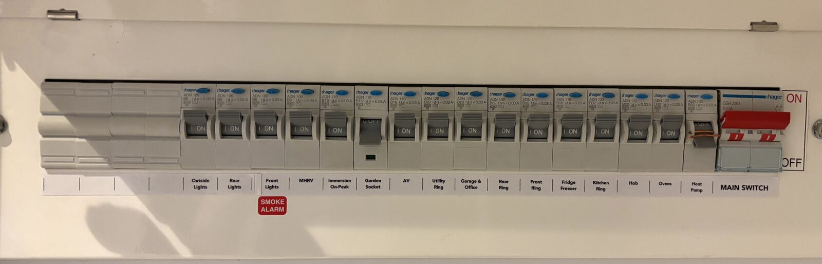

2 rcbos per room
I guess it depend on outlets. My living room has 5 sockets so a ring in that context would make more sense, whereas the utility room only has one so a radial is more sensible.
A Ring Final circuit I was brought up on in my working life so no problem to me, younger electricians are not so keen on them, the outside world is not so keen either. Both the ring final circuit and the radial final circuit have both advantages and disadvantages in comparison to other. So which methodology you employ depends upon what benefits you want to achieve and the cost/work/convenience you aiming at

For your computer room i would suggest 2 circuits
Yay or nay ? One for lights, and another for socket ring. It'll be more cabling but any trips will be constrainted to a very small zone. Although the downside is of course more rcbos (20 in my case!)
Having lights on a lighting circuit, and wall-lights/table lights, on the plug circuit, ensures a room always has some lighting available. A reliable source of light, is usually more important than having sockets working.
a completely separate circuit for a fridge freezer has its merits as it only trips if that one dedicated circuit is tripped/out of commission and a socket from a nearby ring or radial can be used if that one dedicated circuit is out of commission for some reason.
You might want to give some kitchen sockets to one circuit and some others to other circuits to give some resilience in the kitchen if not because it`s likely to be the highest load area so you spread it.
You could even plan it so each room contains sockets on two circuits.
You might even have main rooms lighting on one or two circuits and wall lighting (or table lamps points) on 1 or 2 different circuits .
Of course it increases cable runs quite often therefore costs though so a balance of cost against reliance is need.
One such balance I achieved was a house on three levels therefore two staircases (door at each end therefore enclosed and dark.
I put the three different floors each on their own lighting circuit and because they wanted steps lighting like they`d seen in airports along with overhead lighting therefor both staircases had two separate methods of illumination and it was easy to wire each on two different circuits. So any trip on one lighting circuit meant they could still have some means of lighting for a bit more safety resilience. I had suggested considering emergency lighting in those two areas but they were not keen, of course it still relied on being at the mercy of a total power outage.

Last year, did an extensive revision, in fitting a new consumer unit, which gave the opportunity to add a few new circuits, and split a few up, and add RCD's. We had sockets on two circuits, and lighting on just two circuits. One of the extra circuits, was a radial, for a freezer in the utility, and a fridge freezer in the kitchen. The sockets for which I deliberately decided should not be on RCD's, and the sockets for which were tucked well out of the way, and marked 'fridge/freezer only'.
I never liked the idea, of fridges and freezers, being, as they were, on a shared ring, with the rest of the entire ground floor, which also supplied a spur for garage, hut, plus multiple outdoor sockets.

IMHO unless you have a very special and rather unique need to do this, then it is rather a pointless waste of time and materials. As suggested, I have increased my circuit ways recently, from around 10 ways, to 18, but that has been a matter of necessity, and something which has been on the cards to be done, for a number of years, plus including RCD's to cover all circuits - except the fridge and fridge/freezer, plus a separate dedicated circuit for the latter. I wasn't happy with those sharing RCD's with other circuits, possibly tripping when no one was home to investigate.

Whilst renovating our bungalow, I had plenty of circuits put in. Partly to isolate faults more easily, but also as we were renovating room by room, it meant things could be kept live in various areas, whilst others were in bits.
