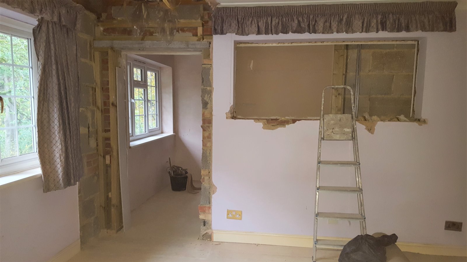

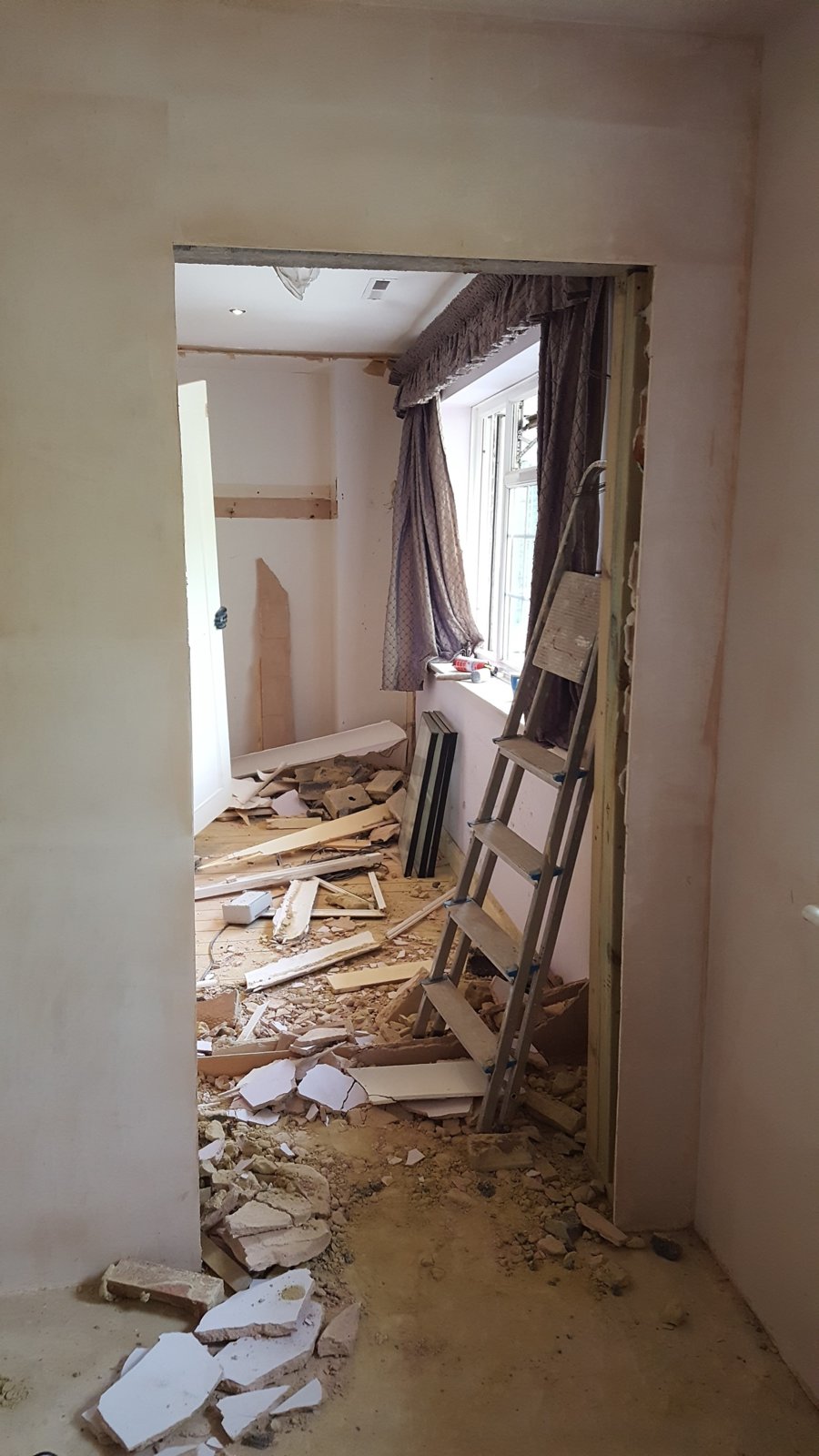

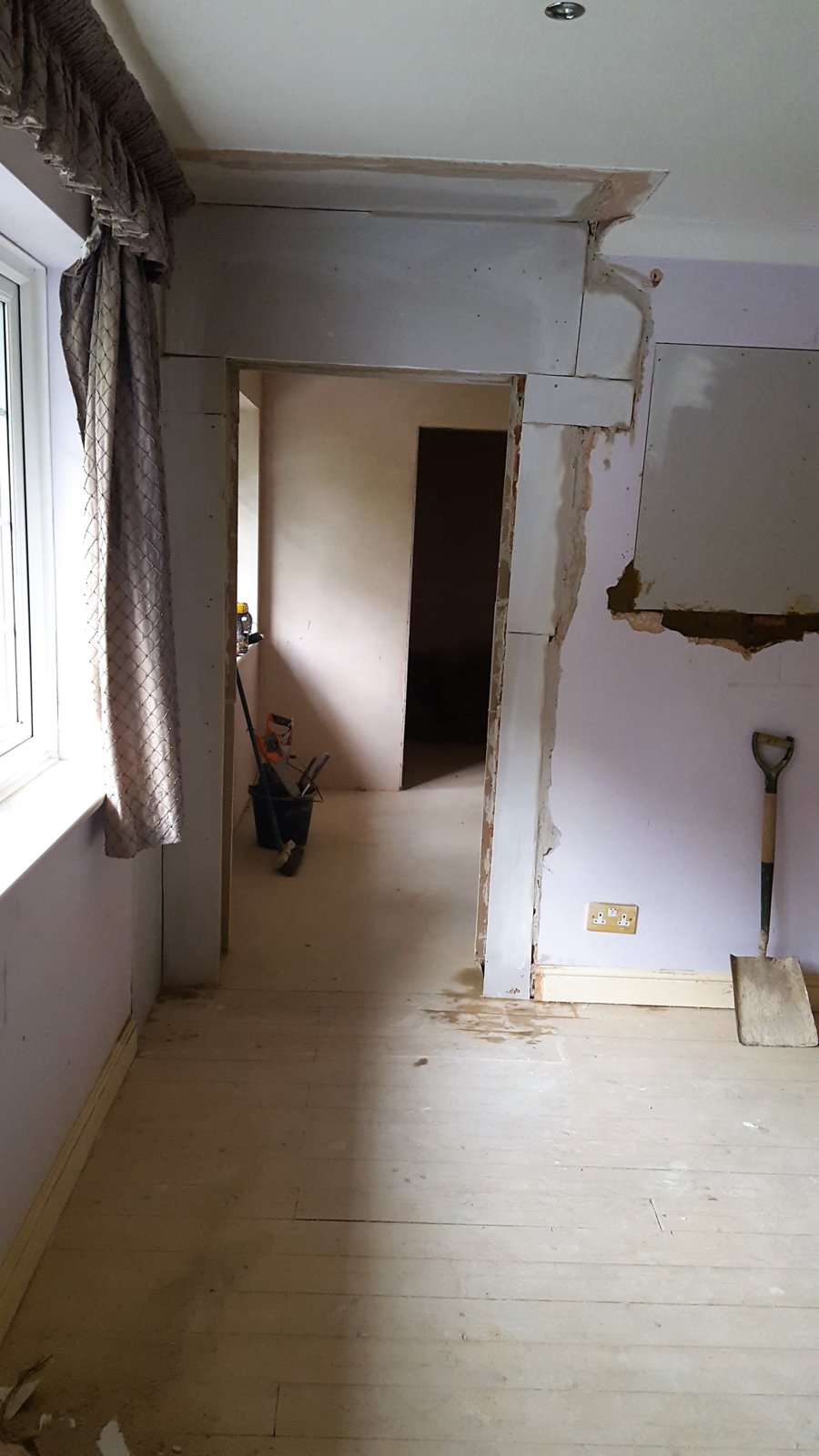

There's been a breakthrough! From the dressing room to the master bedroom. This is before windows, and plasterboarding...
The dressing room was boarded,
and plastered before breaking through.
The view from inside the bedroom. Before,
and after...
Starting to board the doorway. Looking through to the dressing room and wardrobe.

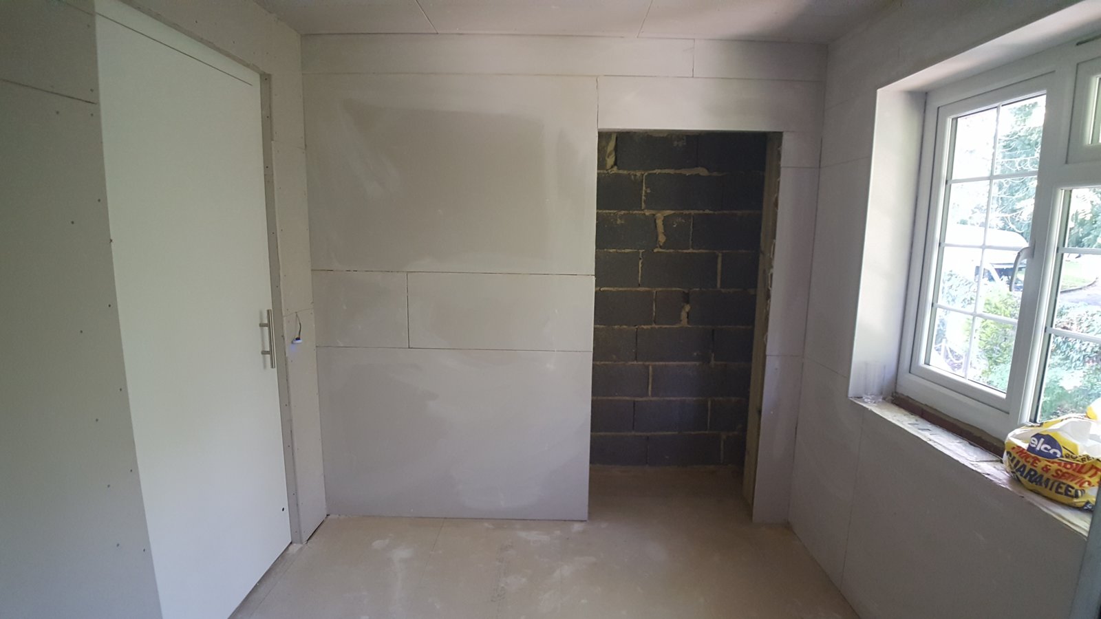

We are using a pocket door system for the walk-in wardrobe. Basically, this is a sliding door that slides into the frame of the stud work. The door stud work frame is an off-the-shelf product. In this case by Rocket Pocket doors, who are quite a bit cheaper than the market leader, Eclisse. You guessed it - the budget is running out!
The frame and studwork are then plasterboarded. Thy provide the screws to go through the plasterboard into the horizontal metal supports. If I'm honest, the metal framework once boarded is not as strong as the timber stud framework. But as this is only a walk in wardrobe, it's not going to get bashed about, so shouldn't be a problem.
The door will be hung later.

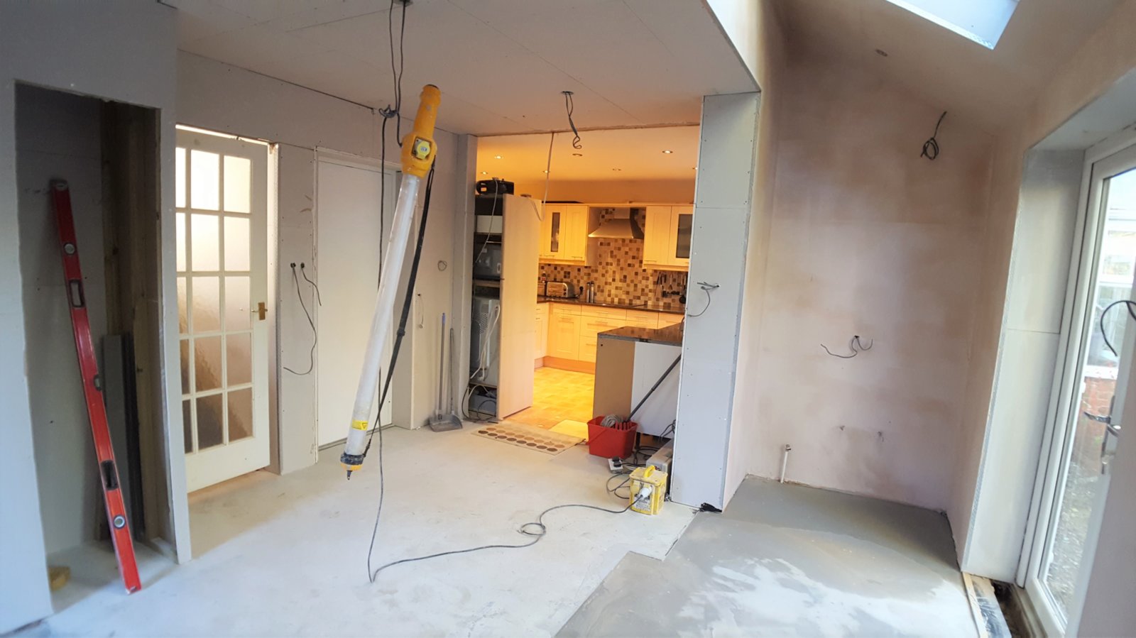

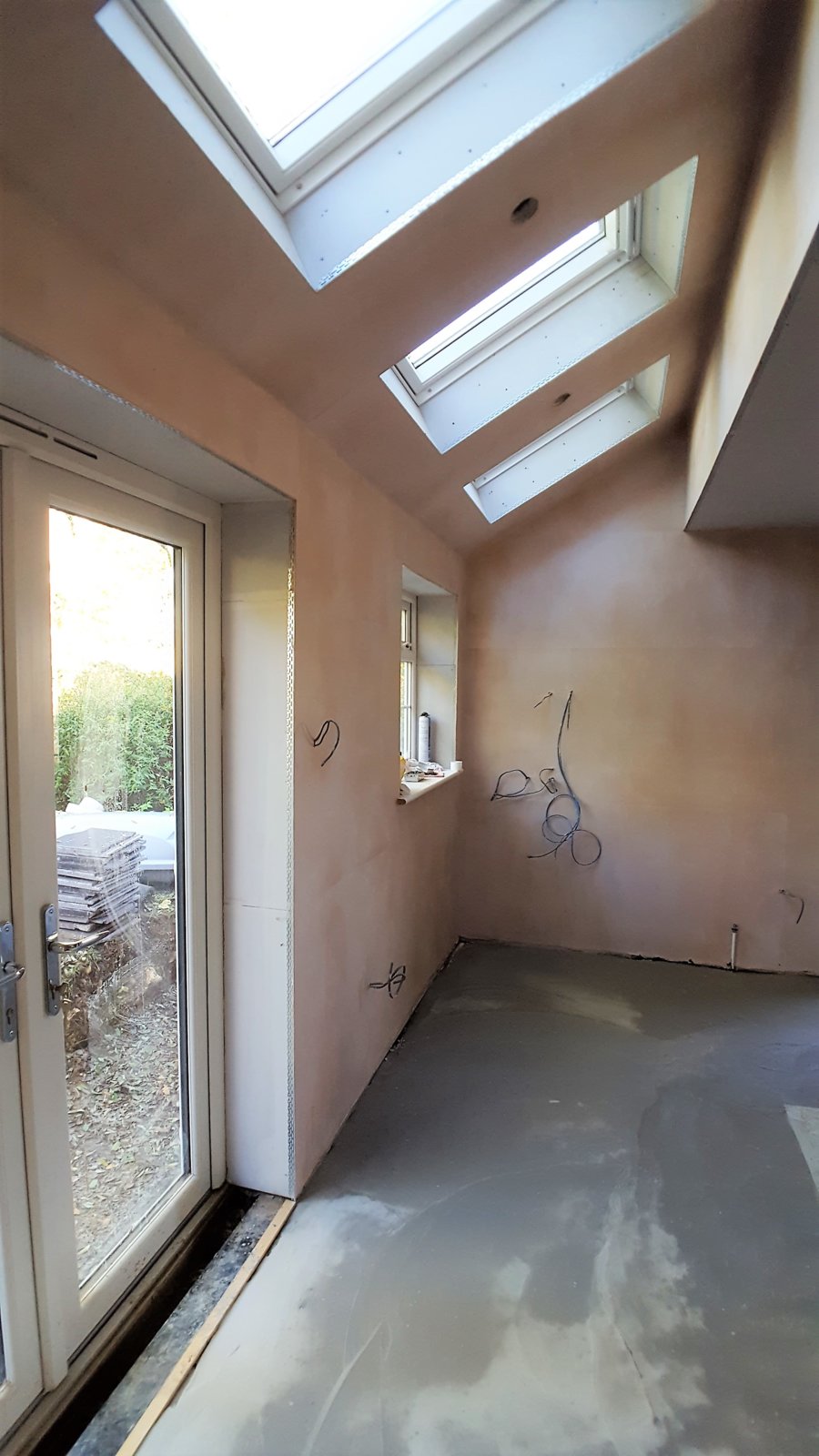

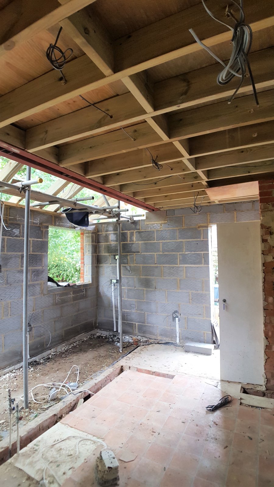

Here's an update of progress with the kitchen/breakfast room.
The first thing to note is that when we knocked down the old utility room, we were "wowed" by the space it opened up.
Before roof, floor and plasterboarding... You can see the outline of the old utility room with the lino.
And after windows and doors...

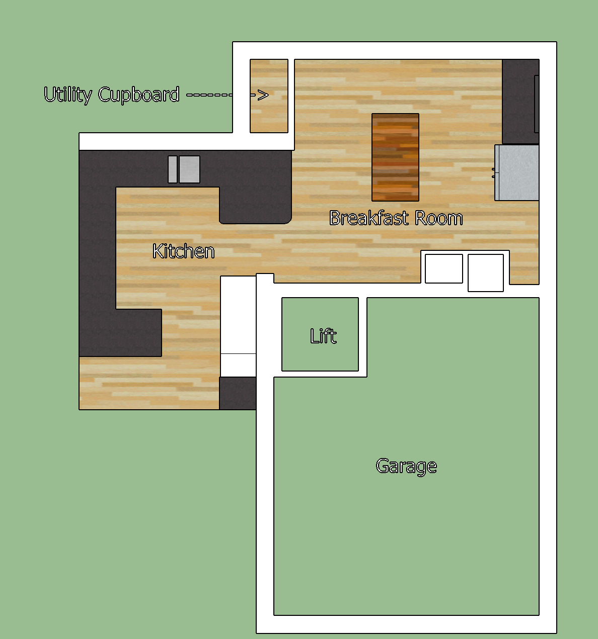

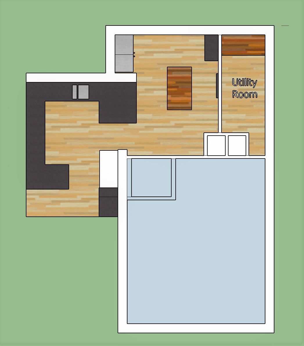

So, we had a rethink on the layout. The original plan was to split the room in two, creating a separate utility room.
But, the openness felt so good we had a rethink, and ditched the separate utility room in favour of a "utility cupboard". This will house the washing machine and dryer behind closed doors and have space for storing laundry, powders, grundies etc...
This is how it's progressed.

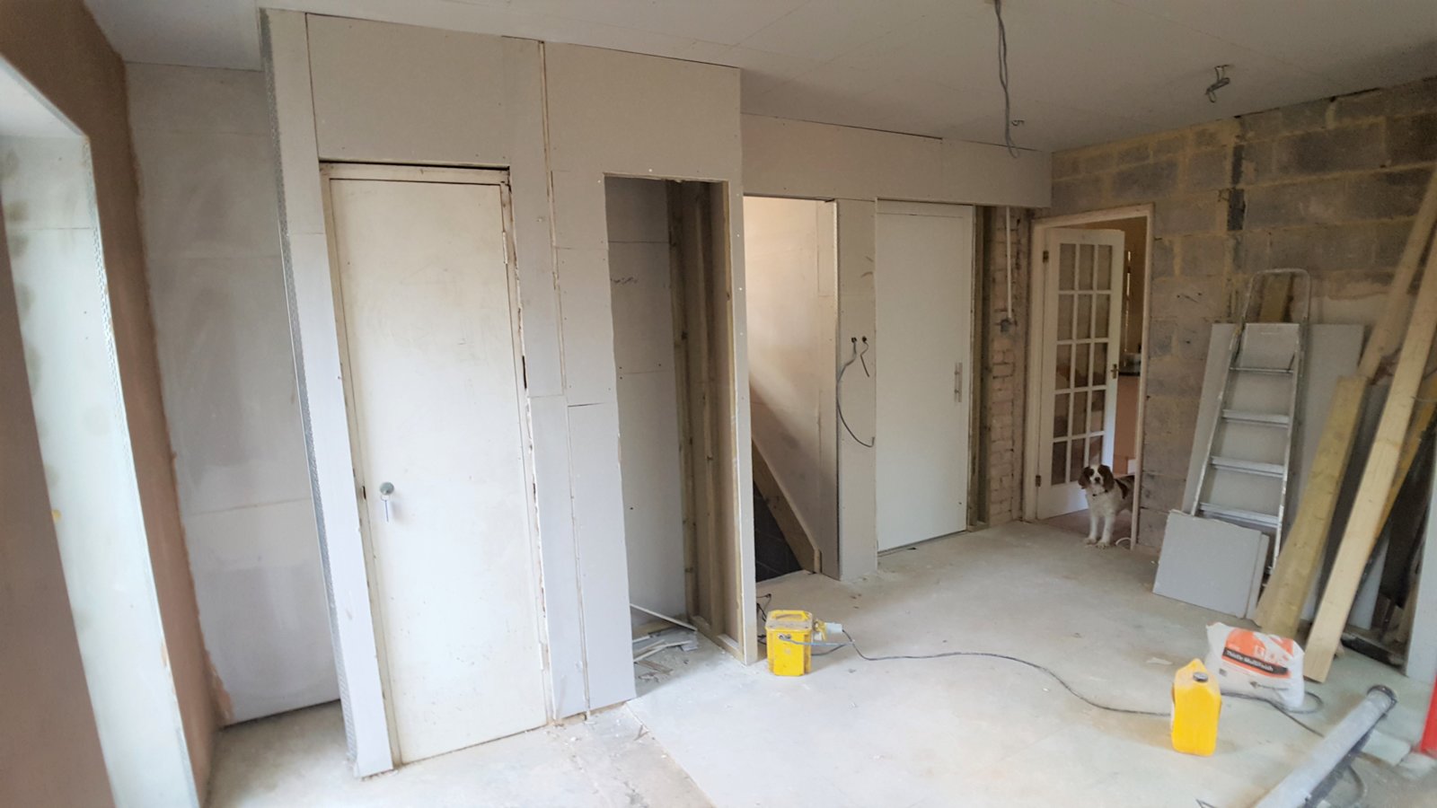

After the knock through...
If we find that not having a separate utility was a mistake, then we can always stick up a stud wall, where it was originally intended to go. There is already a water supply in place, and drainage too. Plastering will be finished today, and electrics tomorrow. Hopefully!

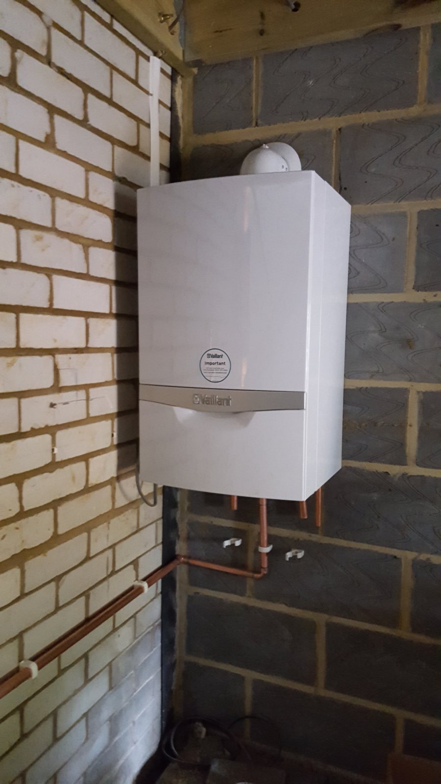

The £8k for the heating system is for more than just a new boiler. Our house was built in 1973 and was fitted with a warm air central heating system, both upstairs and downstairs. Whilst I like this system, it has some downsides - controlability - so we are converting it to be warm air downstairs and radiators upstairs, and relocating the whole system to the garage :
  • New system boiler - Vailant ecotec s637 c.£1.4k
  • New unvented hot water cylinder, relocated to the garage.
  • 9 new radiators upstairs and associated pipework.
  • New Johnson & Starley "Aquair" warm air heat exchanger for the downstairs warm air circuit.
  • New zone based control system - Honeywell evohome.
I don't have a full breakdown on costs, but can tell you that the evohome cost £800, and the rads £900.
The picture above shows the Aquair unit (left), and the system boiler in the middle. There's still quite a lot left to do - ducting and pipework, and the evohome system isn't fully installed yet.
We don't have a condensate drain installed yet. But we do have a bucket!

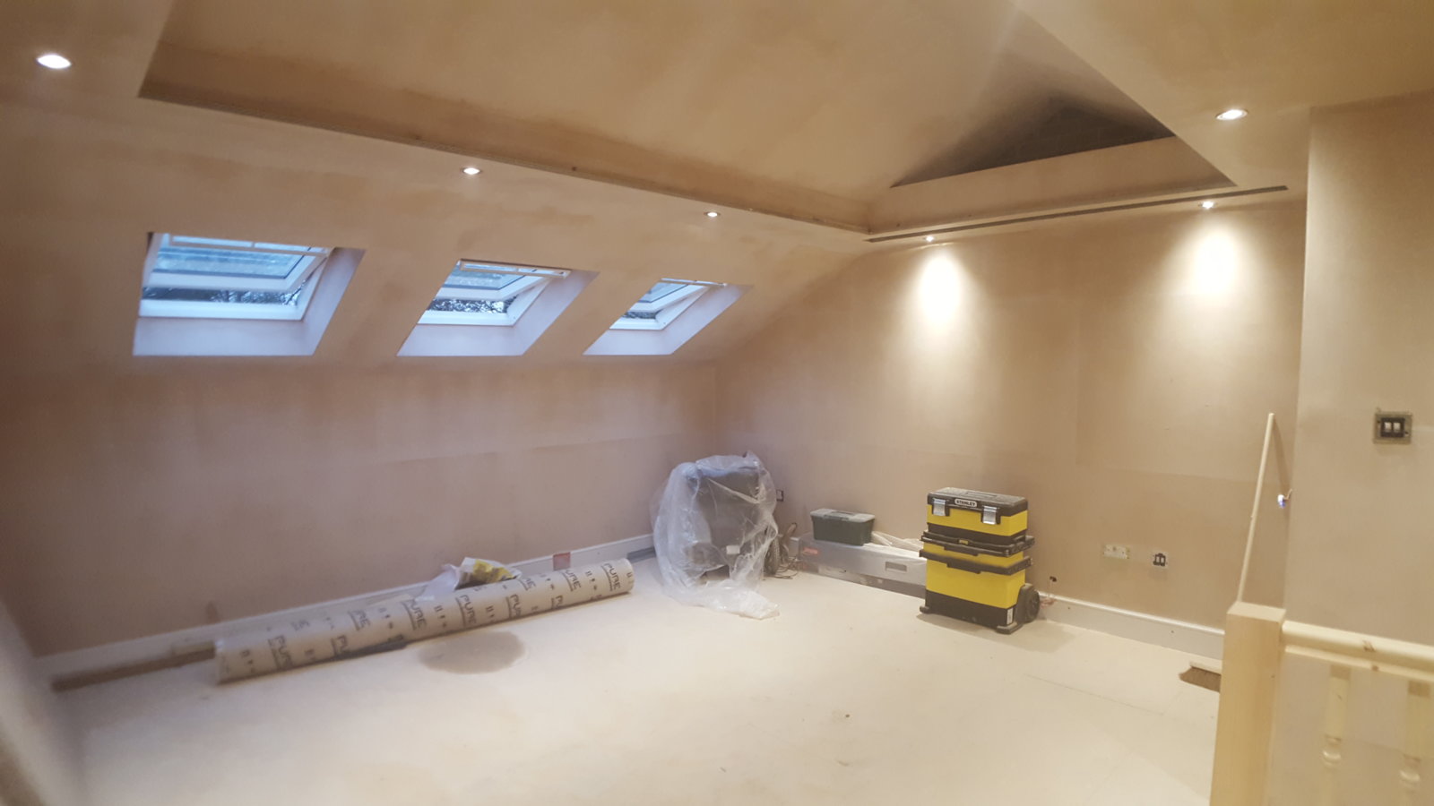

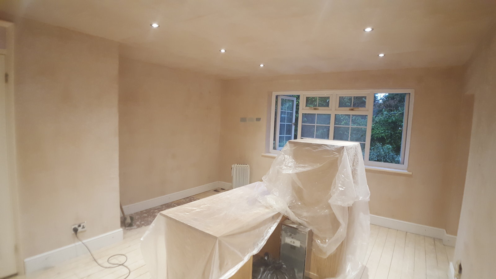

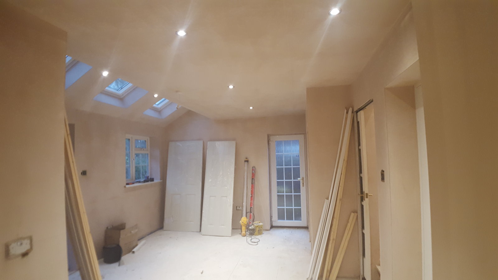

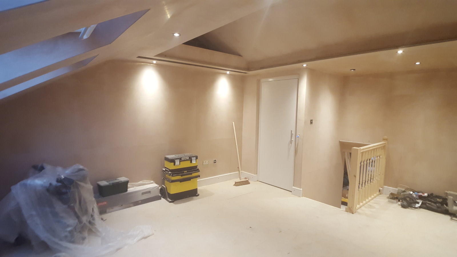

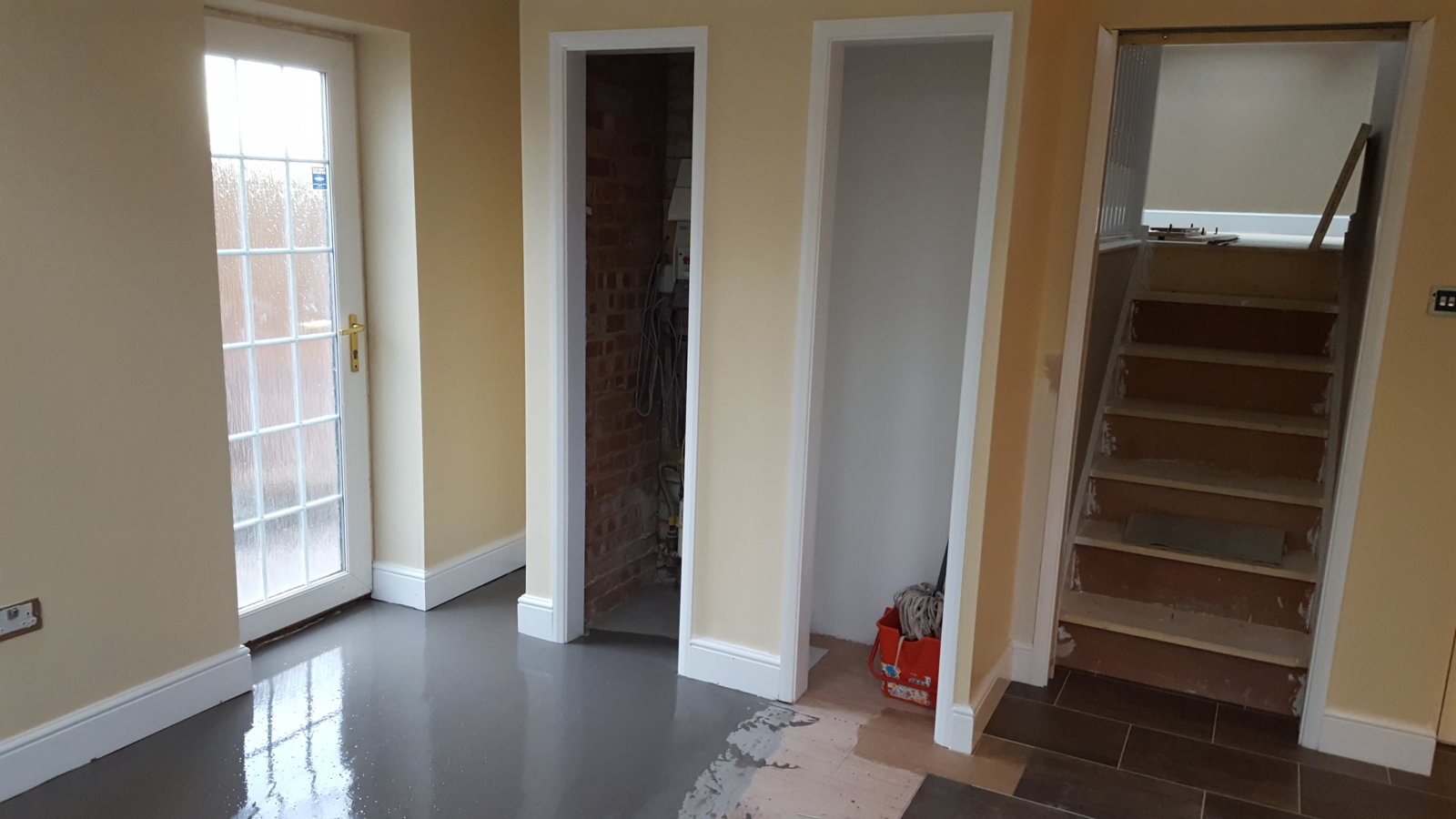

We have lights !
In the breakfast room...
In the bedroom.... (also with skirting board)
And, in the media room....
And stairs, too...

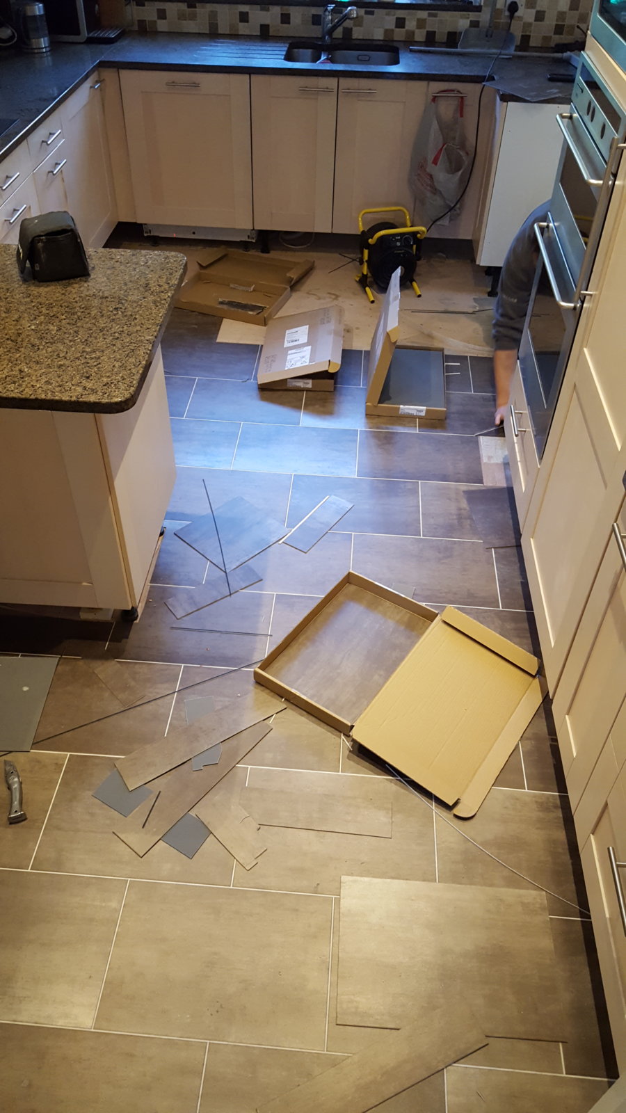

I have not updated for a while. Works have ground to a halt. Same old story - the builder has run out of money! Anyway, we managed to get most of the decorating and flooring done before Christmas.
Here's the flooring going down in the kitchen & breakfast rooms. Amtico Spacia Bronze...

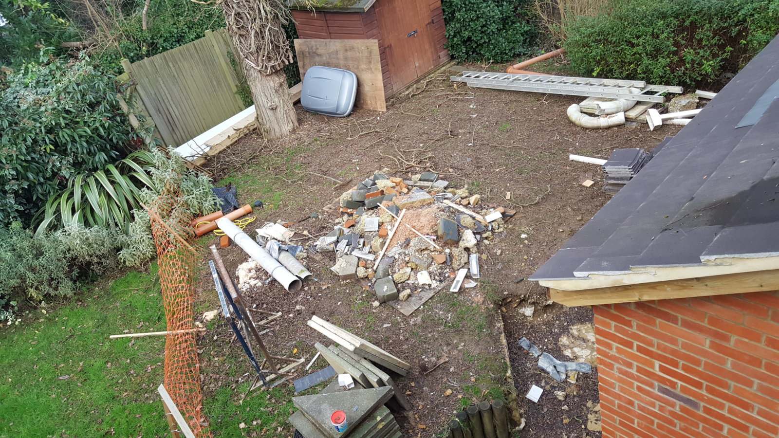

And here's the mess we're left with in the garden.
We've got another set of builders starting soon to finish off the project:
Garden clearance and patio
Garage ceiling insulation and boarding
Soffits, fascias and guttering at the back
Odd jobs inside
Probably about 3 weeks work.
