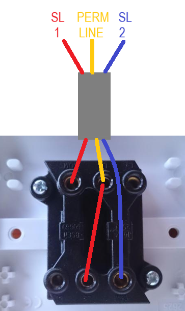

What is weird is red and black to a terminal, black and grey to a terminal.
What is weird is red and blue to a terminal, black and yellow to a terminal and a lone red on it's own.
What is weird is not having red and red to a terminal.
What is weird mixing wire colours in a terminal when they don't have to be mixed.
What is weird is wiring a 2G 1W switch like this:
