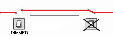

The reason for all this is that I've got a WiFi switch which doesn't require neutral, but doesn't support 2way switching.

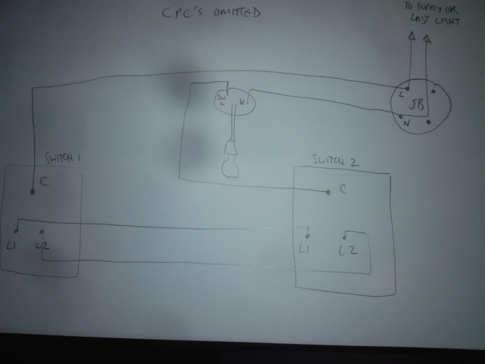

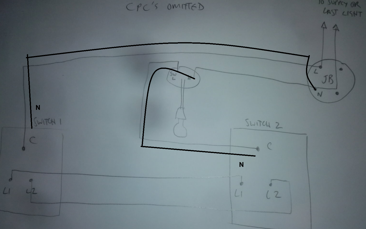

Far better to bite the bullet and get a smart switch that does cope with 2 way switching - Google gives me several but they all require a neutral. Depending on EXACTLY how your existing setup is wired you MAY be able to use one of the snipped-off BLACK cores to acquire a neutral (remember it doesn't matter which switch you replace). You would have to be careful to avoid borrowed neutral here - in a modern install with multiple RCDs that'll cause all kinds of bother as well as being very bad practice.

Here's potentially 2 ways to get a neutral to either switch

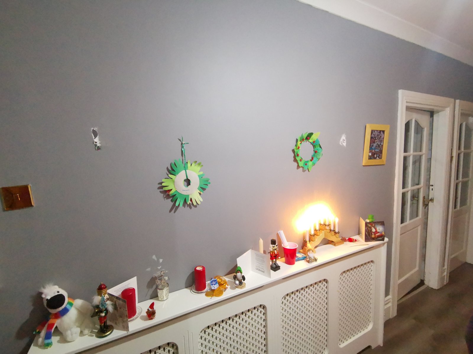

Thanks for the comments. This hallway has no legitimate need for two switches. They are less than 3 meters apart (both on ground floor), I would fully agree regarding my landing light, and I don't intend to replace that one because of the genuine benefits two switching delivers here.
The 2nd switch is between the two doors.
