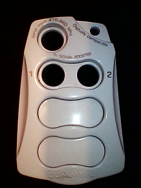

Recently got a 2nd hand booster to supply a couple of TVs yet when plugged into one TV with around 50% signal and 100% quality on its own without the booster, the booster is reducing the signal quality to around 60%. The led lights on the booster so I presume there's no issue with power.
Is that the norm for a booster of this type or is it merely faulty? ...... I'd presumed a signal booster would provide near 100% for both signal and quality.

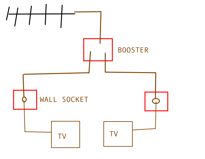

Aerail lead plugged into the booster and the two cables out to the TVs. I do however have suspicion that some older cable already in the wall down to the ground floor is not the best. Its not screened. The cable I've used to the other TV is WF100.

In my opinion the booster is faulty. For the price of a new booster, I can get another log periodic aerial provided its at least 0.6m from the other.
The cable runs layout in my fine art below,

Those aerial distribution amp's are probably among the worst made.
Screened by aluminium sputtered on the plastic case. Cheap components, so the smoothing caps fail = hum = extra noise = signal becomes rubbish, despite the red light being on. They also amplify 21 (470 MHz) to 68 (860 MHz) inclusive when we need to filter off 49 and above nowadays to reject mobile phone interference adding noise.)
ATV aerials recommends getting rid of unscreened wallplates and using f-plug cable joiners. He also favours Blake/Proception amplifiers with proper metal screened insides.

@DIYspanner Still need a postcode or the numbers from Wolfbane's prediction tool to have an idea of the outside field strength, then deduct 10dB for the roof materials, add 7dB for the log gain, deduct 2dB for cable and termination losses --- and see if it is between 45 and 65 dB.
At least the amp was in loft near the log... And I'd keep antennas at least a metre apart to avoid interactions between them.

"outside field strength, then deduct 10dB for the roof materials, add 7dB for the log gain, deduct 2dB for cable and termination losses "
For mine, it works out @ 55db. The field db is 60 and for the relay transmitter the aerial in pointed at and a log periodic, which I have, is recommended.
55dBuV terminated is bang on the middle of the ideal (45-65 dBuV)...
-4dB for a passive split = 51 dBuV
A passive metal screened splitter is only a few quid and may be worth trying... https://www.toolstation.com/2-way-splitter/p30919 for TV plug style or https://www.toolstation.com/proception-wideband-tv-satellite-splitter/p66100 for F-plugs
Even a cheap plastic cased Y splitter if you have one in "the man drawer"...
Then a low gain screened DA like https://www.toolstation.com/proception-amplifier/p85614 with TV plugs or for F-plugs
+8dB for a low gain DA = 63 dBuV.
(NB 2 way DA: the amp inside is +12dB, 4 way DA: +16 dB before the passive splits. Extra noise added: inevitable but there should be minimal degradation if the aerial to amp cable is reasonably short 1-3 metres?)
