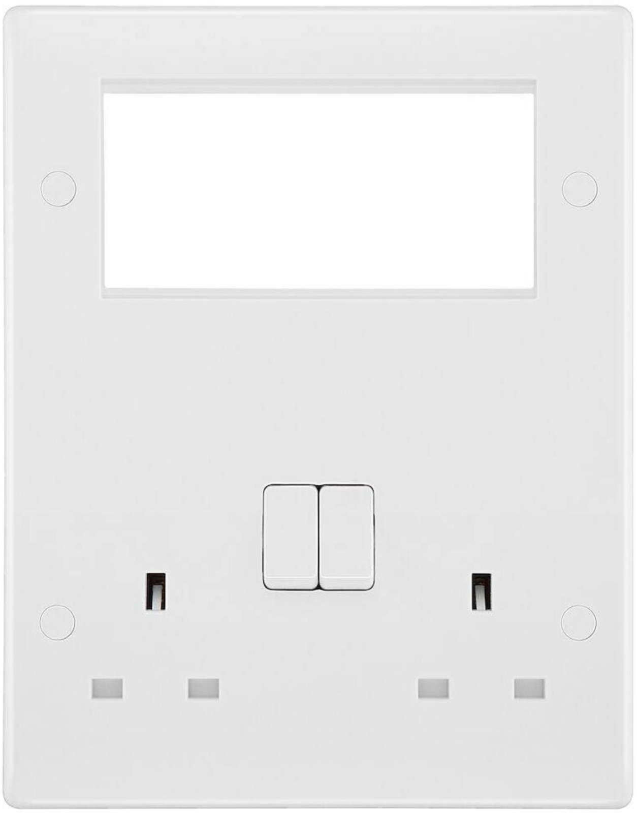

Still - I'm glad I didn't think about it enough before posting, as downloading the full catalogue tells me about this
which is what I was going to make out of modules. I knew that there were these combination/multimedia plates around, but I'd only ever seen gargantuan ones.

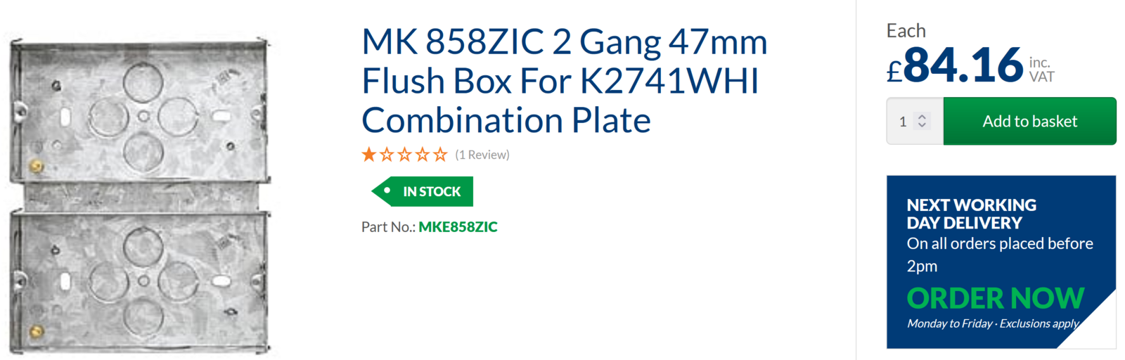

Just seen this re the equivalent MK product.
I think laughs are being had.

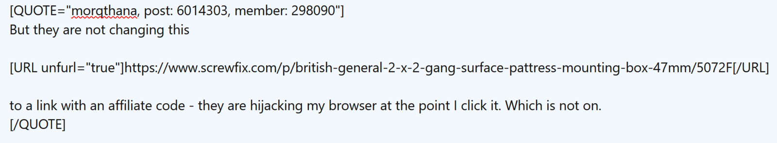

Well this is interesting.
I just pasted the link into my post, and this is how my post ended up
Flameport's looks like this
A different format. My link works, his doesn't.
My theory is that MK hope that specifiers will only compare the "basic" products and won't notice the high prices of the more unusual products until it's already too late. Either that or they think the kind of people who buy media plates are the kind of people who will specify MK no matter the cost.
