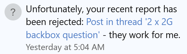

Screwfix part number 5072F, as this forum is currently destroying links to that place.
They still aren't working.
I reported it, and all I got back from the Moderators was:
So if they are still broken for you, could you also report it?
Plus anybody else affected. If they get multiple complaints they might look into it.

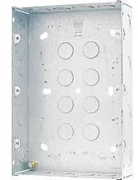

That is a triple row grid box.
Unfortunately BG don't give screw hole locations for their boxes or plates, but the overall height of the plate is.
single row - 86mm
Dual-row euro - 186mm
Dual-row combination 13A/Euro - 186mm
Dual-row grid - 147mm
Triple-row grid - 207mm
With such a large discrepancy in overall plate size, I very much doubt the screwhole locations match up.
