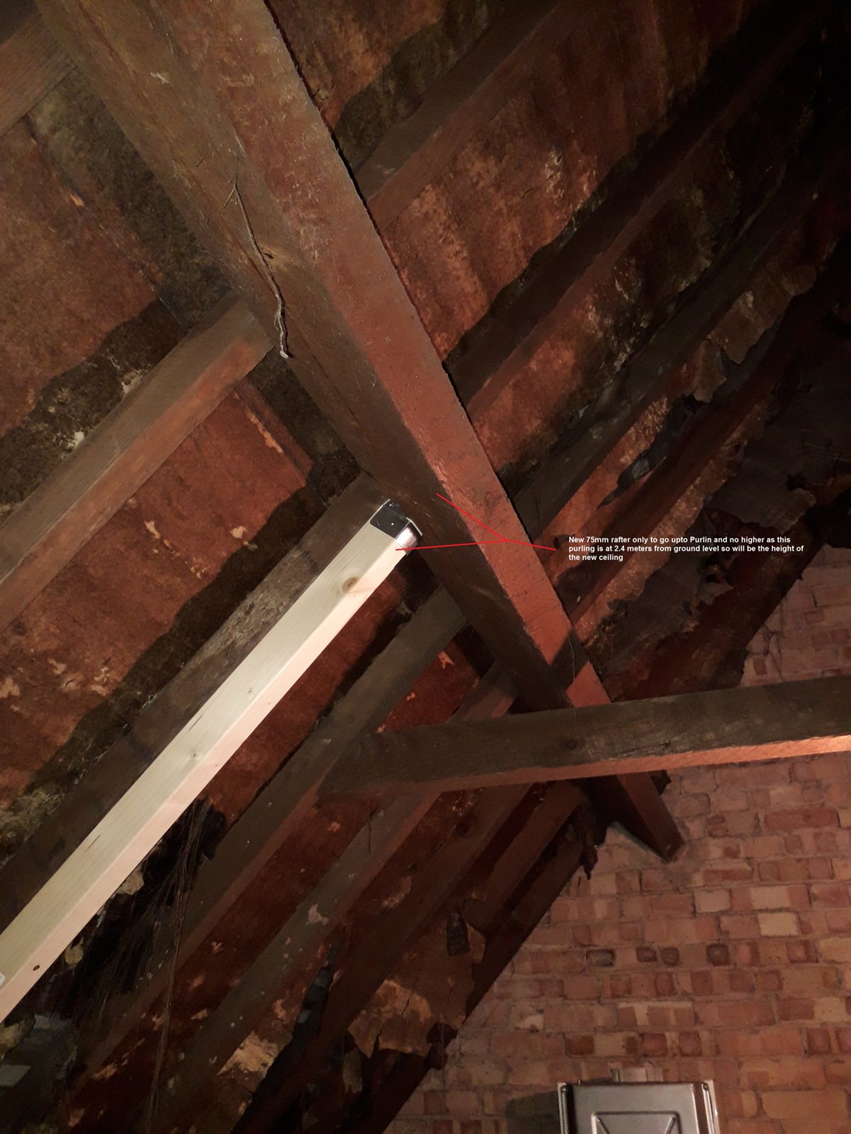

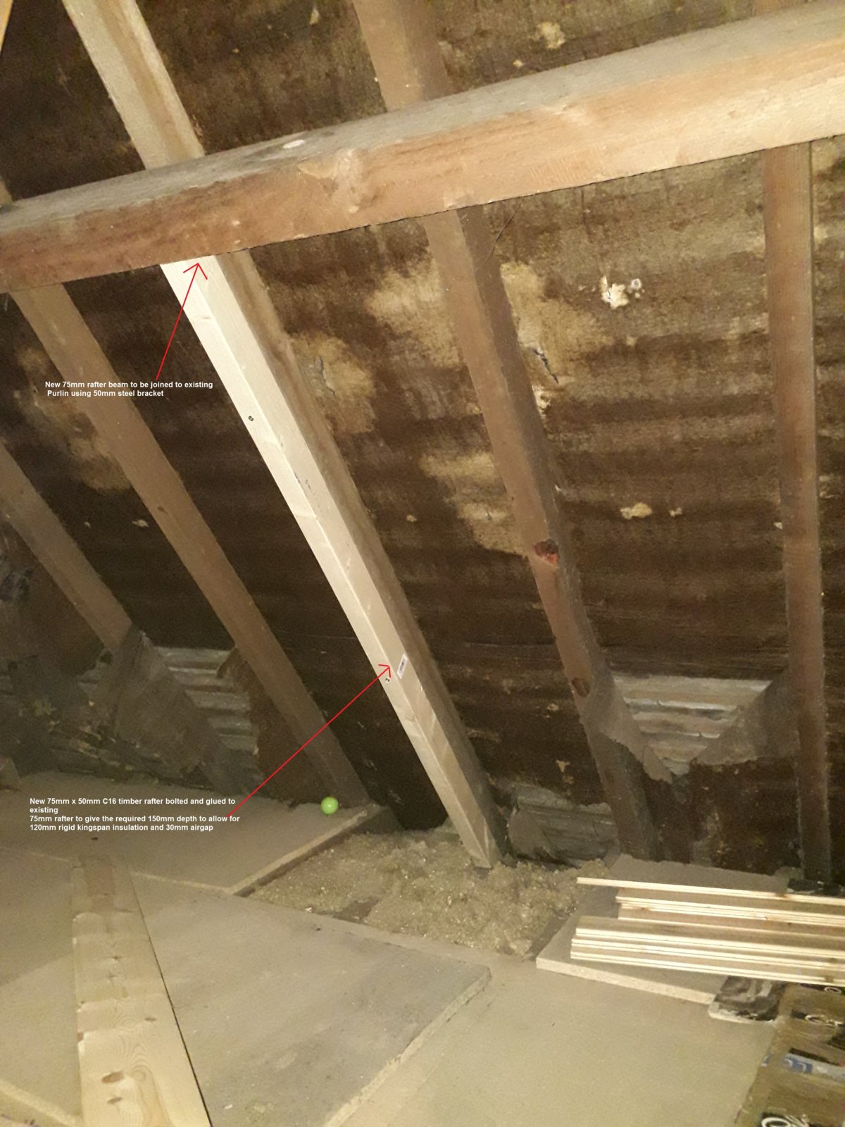

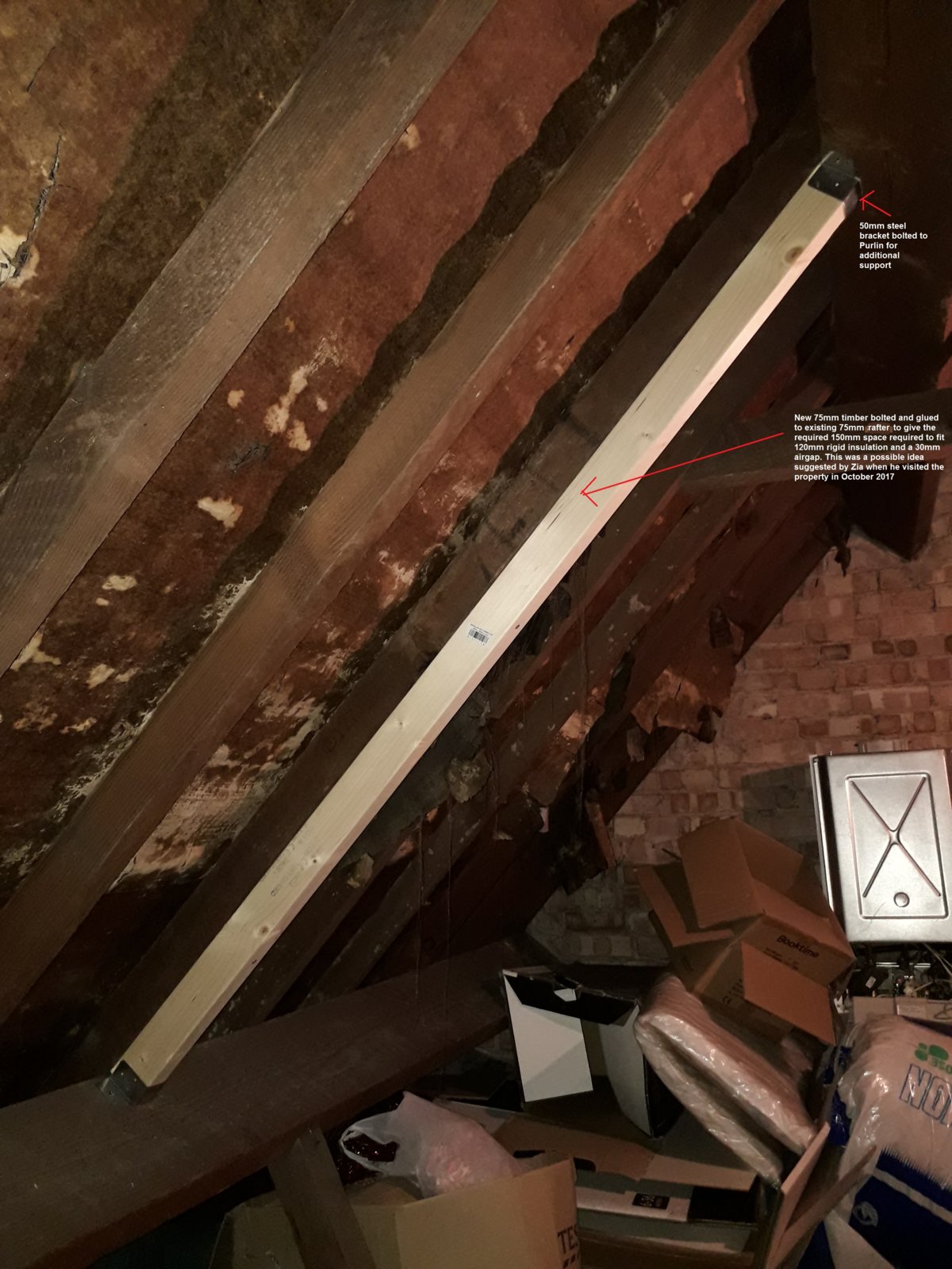

Glueing/screwing and extra 3 x 2 on to of the existing in an attempt to get a 6 x 2 won't give anywhere near the strength of a 6 x 2. This is because the glue joints will be far from imperfect. Also there's an issue with the time of year. PVA glue needs a minimum temperature of 4° C to cure properly (as does PU glue) - below that point it often chalks out and fails - and it's the cold timber in the rafters which will give the most problems at this time of year. PVA glues are not gap filling so if there are any issues with the existing joists (e.g. wind, bow, surface imperfections including one or more surfaces which are not planed) it won't work, or if it does it won't work well, and any dirt or contamination will also reduce the glue bond. 2in width (probably 44mm in reality) is really too thin to bolt together vertically, and in any case the bolts would have to come through the roof coverings. If you are lucky you'll get the strength of a 4 x 2 or a 4-1/2 x2. BTW wood glues aren't toxic - if they were I'd have snuffed it years ago

Ive decided to get a couple of 2x3 and actually add them to the ceiling rafters to show what i mean. I have given a description on the pics of what im referring to, same as i sent to my structural engineer who advised when he first visited this was a possible solution.
Btw The large purlings will stay in place. The diagonal props willbe removed the the purling will be supported by verticle studs which will sit on top of the new steels that will sit directly below the purlins.
