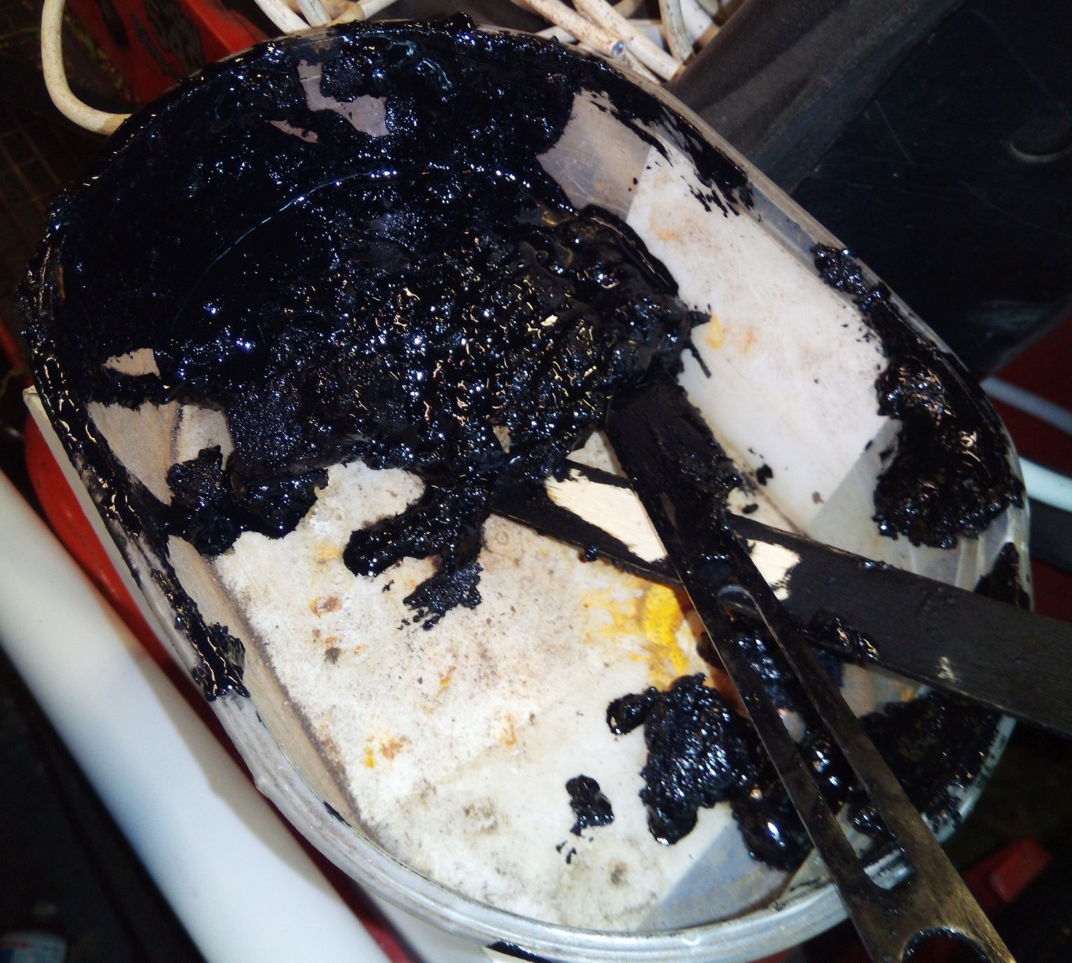

A couple of years ago, I was given my sister's 140,000 mile, 2001 Freelander 1, as she was going to scrap it, having had it fail its MOT on (among other things) smoke. I took the inlet manifold off and sure enough, it was as you describe. She hates revving engines because she thinks it "hurts" them. I was scooping this gunge out with a teaspoon, lollipop stick, you name it!
Sadly, I never got round to taking a photo before I started, but there was a lot more than this!
That, on its own, (well, and a couple of good thrashings up my hill at 4500 revs on a wide open throttle), was sufficient to get the smoke readings way down to something a lot more respectable:
20,000 miles later, I took the inlet manifold off again, and there was no build-up of sooty gunge. I appreciate the previous lot was 140,000 miles worth, but I thought it was encouraging.
