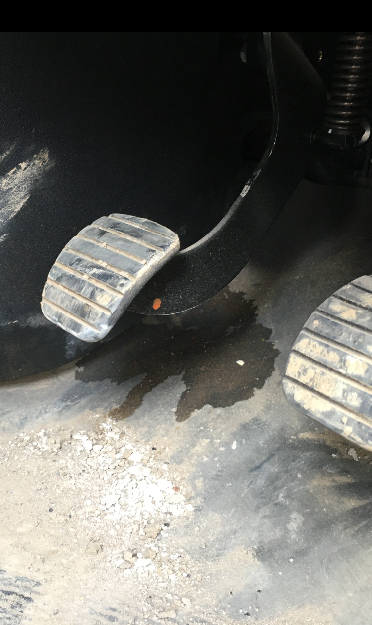

gigz Joined 7 Oct 2006 Messages 9,822 Reaction score 4,980 Country 2 Mar 2020 #1 Anyone any idea what this is ? Its under the clutch pedal, hasn’t really got any smell to it so not sure what it is.
Mottie Joined 27 Feb 2017 Messages 54,652 Reaction score 13,598 Location Essexshire Country 2 Mar 2020 #2 If you have a hydraulic clutch, I’d say it was brake fluid from a leaking master cylinder.
B Burnerman Joined 7 Feb 2008 Messages 26,551 Reaction score 5,947 Location Northumberland Country 2 Mar 2020 #3 As above, the Vivaro has a hydraulic clutch so there's a chance its hydraulic fluid leaking down from the pedal box area or maybe coolant from the heater. The heater fluid will smell quite strongly when it is hot. John
