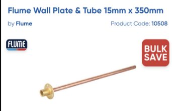

Why doesn't anything like this exist:
...but which accepts a 22mm inlet pipe and has a 3/4 thread for a large garden tap? All I can find in this size is wallplate elbows, but I want a straight-through-wall type.
With or without the copper pipe pre-soldered doesn't matter.
Everyone would usually just have a 15mm feed with a 1/2". For a larger tap I'd just use a 22mm to 3/4" compression or end feed on the end of a 22mm pipe and then just wrap and mortar it into the wall leaving the tail.

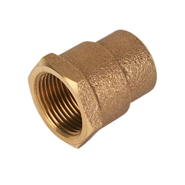

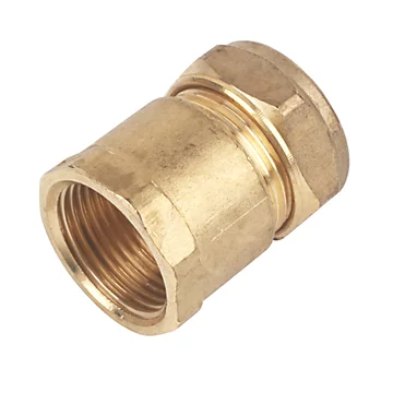

View attachment 408561View attachment 408562
Would be a bit nervous about hanging heavy buckets , knocking it etc if it's just hanging off the end of the copper.
This doesnt look too bad. Would a 22mm compression nut fit 3/4" BSP male?
