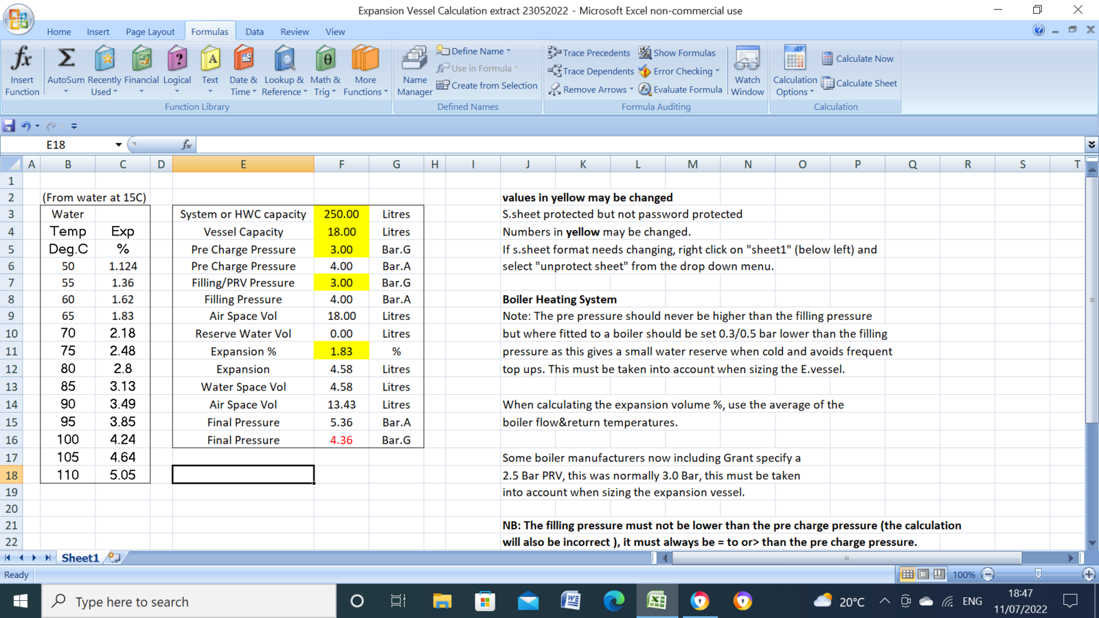

Heating 250L water from 15C to 65C results in a expansion vol of 4.58L (1.83%). With a 18L EV, sssuming a PRV pressure of 3.0bar and with the cylinder properly precharged to 3.0bar will result in a final pressure of 4.36bar or 4.46bar if precharged to 2.8bar (recommended by some, to prevent water hammer).
It would require the precharge pressure to fall (leak, or improperly set) to 1.4bar to lift the expansion valve at 6bar or the PRV pressure to rise to 3.84bar to lift it.

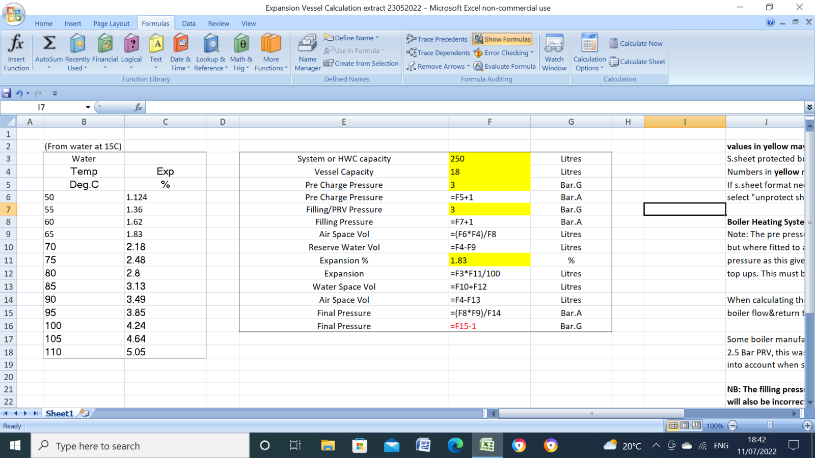

They are all related in this simple spreadsheet, can't post my actual one but you can see the calculations here if you want to build your own.

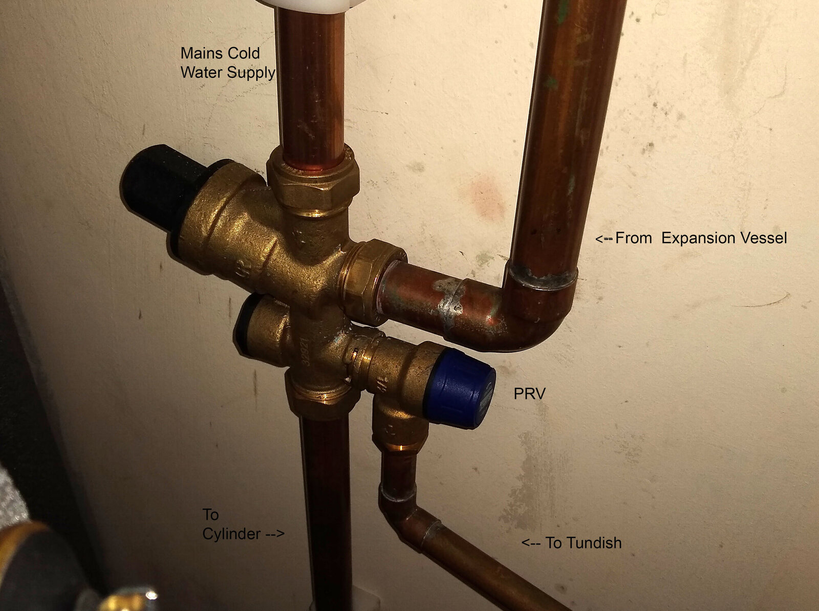

Where exactly from (if) the inlet group set is the EV connected, if connected (incorrectly) like the one below then effectively no EV and the expansion valve will expel the expansion volume every time the cylinder re heats but will only drip while the cylinder is re heating.

The expansion is tee'd in after the pressure reducing valve
