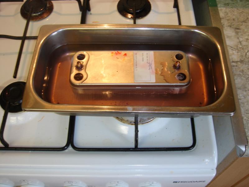

You really need to acid clean the plate...just flushing it through is not necessarily sufficient. I use Kamco FX2, fill the plate and rock it to expel any air. Simmering it in a bath of water on the hob gets the acid to work faster. Of course it's hazardous, you have been warned.

Gasguru - thank you, I will try that, but not this week as I'm away this weekend and whilst the other half is fine with limited DHW no heating (should things go wrong) would not sit well...
