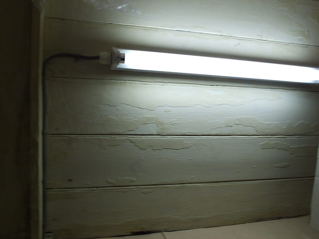

Hi I just wanted to check if this would be ok :?:
What I wanted to do was put in a 2ft Tube in the cupboard under the stairs, which would be running off a FCU with a 3 amp fuse in.
The way I was going to do it was:
To have a surface mounted unswitched FCU running as a spur from the socket in the dinning room (which is on the other side of the wall, of the cupboard), by using a piece of 2.5mm T+E, going from the back of the socket through a hole in the wall and into the back of the FCU.
Then to run to length of 1.5mm T+E from the FCU to a 20amp 4 terminal JB.
Then I was going to run a length of 1.5mm T+E from the JB, to a surface mounted 1 Gang Light Switch.
Then I was going to run another length of 1.5mm T+E from the JB, to the 2ft Tube.
And I was going to put a 3amp fuse in the FCU, and clip up all of the cables using 1.5mm Tower Clips.
So would this be ok :?:
as its in a cupboard, maybe u can minimise work and "cost" by using a switched fused unit as the actual light switch ? just connect light to load side of FCU ... removes need for another switch, extra cable and joint boxes
everything else sounds ok though

Here are the pictures of how I did the light in the cupboard under the stairs
1) The 2ft Tube
http://i167.photobucket.com/albums/u125/mdbalson/PC040156.jpg
2) The 20A 4 Terminal JB
http://i167.photobucket.com/albums/u125/mdbalson/PC040157.jpg
3) The Light Switch
http://i167.photobucket.com/albums/u125/mdbalson/PC040158.jpg
4) The FCU
http://i167.photobucket.com/albums/u125/mdbalson/PC040159.jpg
The FCU is Spured off from a dining room socket, which is on the other side of the wall to which the FCU is fixed to.
The FCU has a 3A Fuse in it.
i agree with Jim2287, doing as he suggested would have been a much neater job.
I didn't do it that way because, there was a big hole in the wall which was going to the top of the backbox of the dining room socket, (which was already there), so I put the FCU where it is to hide the hole.
in that case you could have run a 1mm cable from the fcu to the switch then the light, and it would have still looked neater
