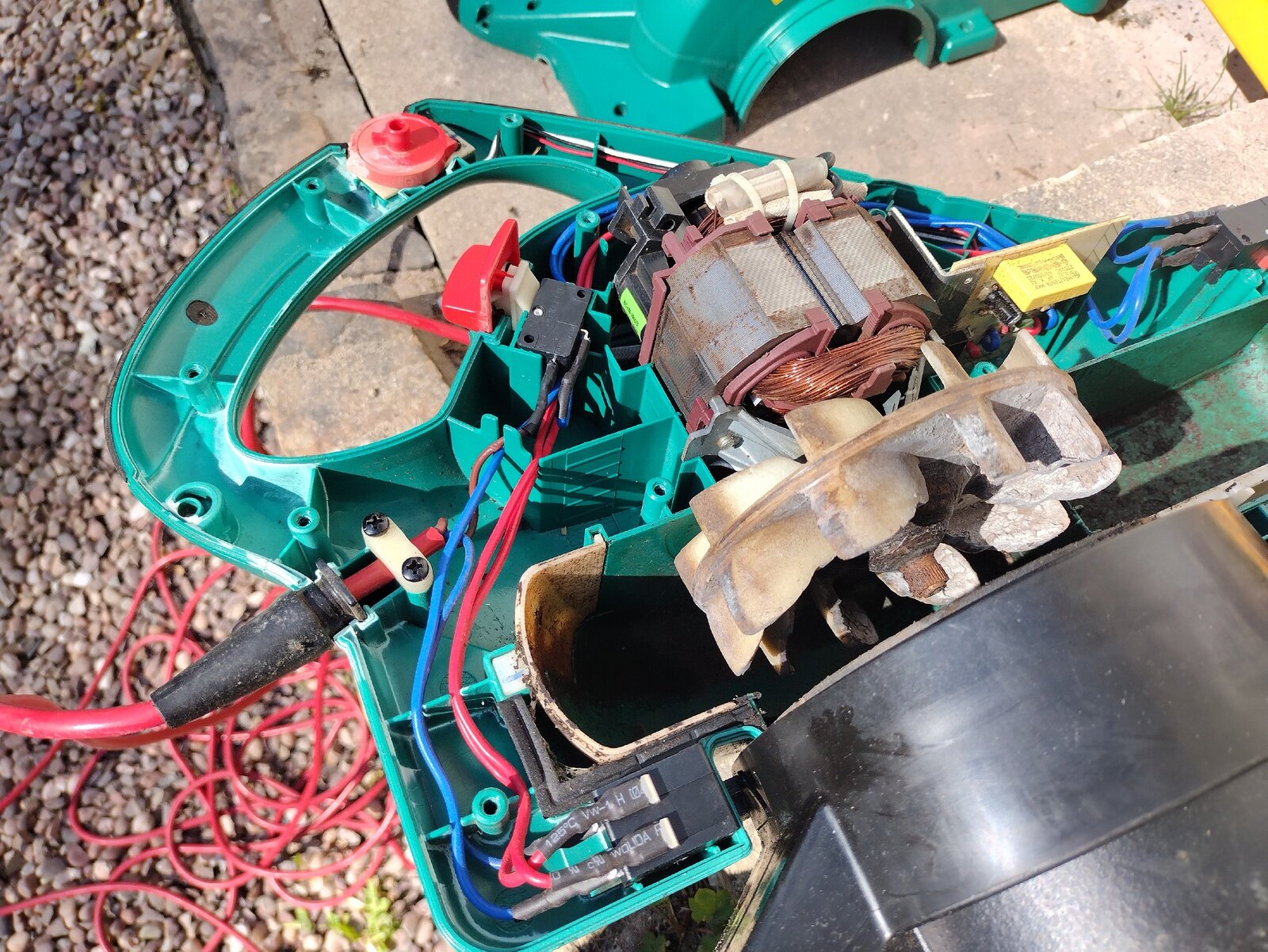

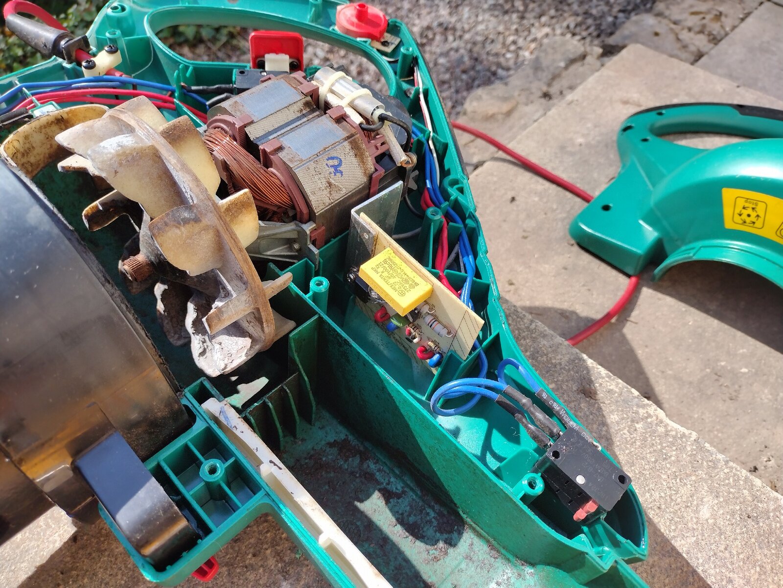

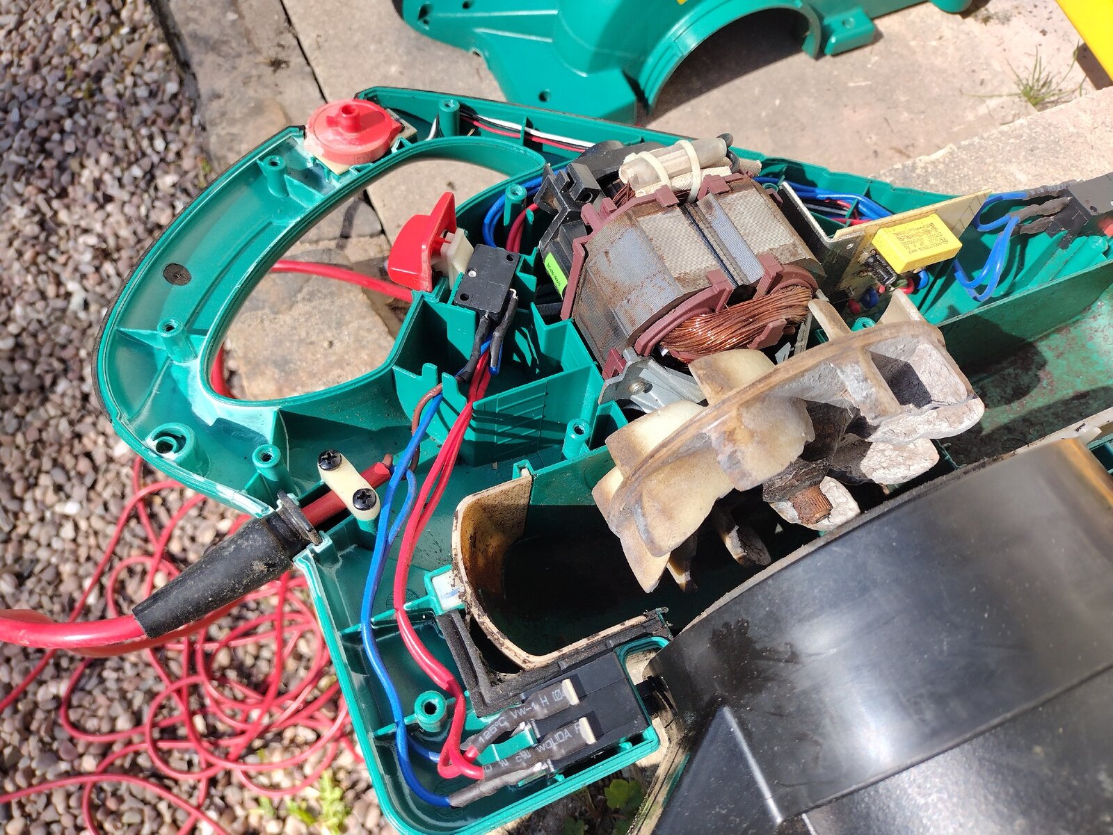

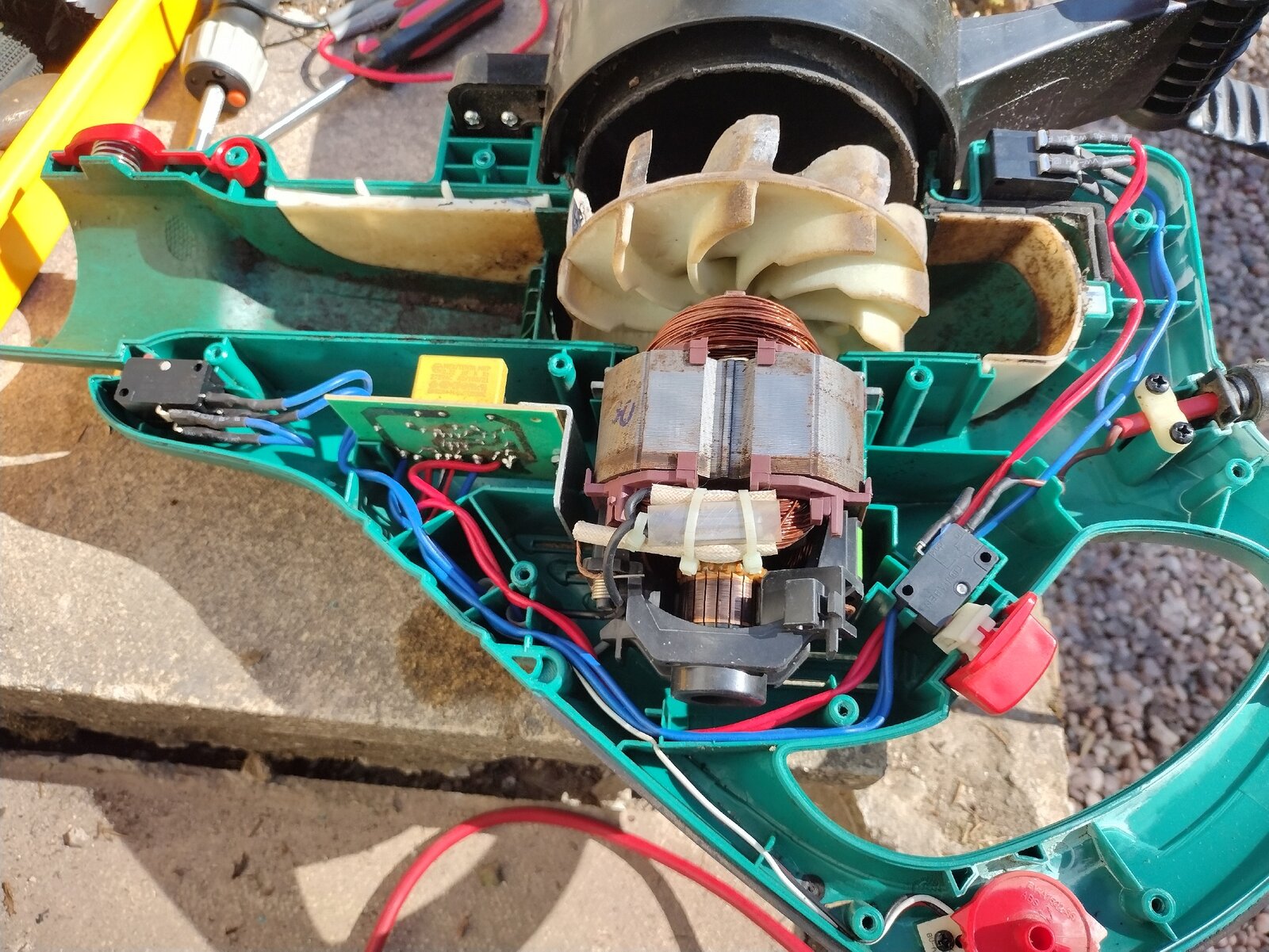

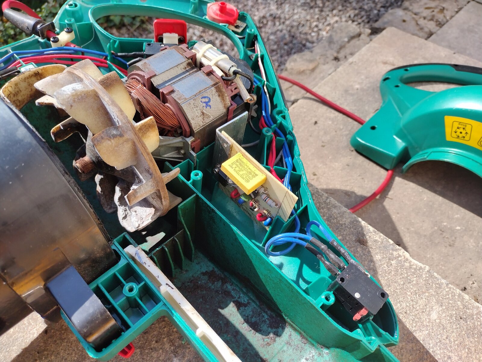

I've had the machine apart this morning and checked at various points for continuity with a mutlimeter, as suggested. All seemed well to begin with, and I think it has led me to “the problem”. I’ve put that in inverted commas because if it is the reason for no power, then it isn’t so much a problem but more a reminder to read the manual!!!
From what I can tell, there is a double microswitch where the bag connects. So without the bag connected = no power. As I was planning to use it as a blower rather than a sucker, I didn’t think I would need to connect the bag, and certainly didn’t think it would prevent the machine starting up. Of course I might be wrong on this, but there’s no continuity in the latter stages of the wiring until the microswitches are pressed.
I’ll put the machine back together a little later and see if I’m right. In the meantime, if anyone can confirm that what I’ve described sounds likely (or unlikely) then please chime in so I can carry out any further checks while still apart. I’ll post a photo or three of the innards for reference.

That “blade “ doesn’t look like it mulches the leaves?
I know little about leaf blowers but assumed that they produce a jet of air (blowing/ sucking) and what you see is a basic impeller on a fan.
i wasn’t aware that they physically masticate anything.
You might well be right there @Tigercubrider I've read that some machine mulch as well, and just presumed that to be the case with this.
EDIT: Apparently it does shred:
"vacuum, shred and compress"
"Longer working: 10:1 shredding means fewer trips to the compost heap"

The impeller on those blower/vacs also shreds any material that passes through it by serrations cut into each blade. Unfortunately when any green material sucked in is fresh the sap wets the blades & causes a build up of shredded material both on the blades & underneath the impeller & in the cavity. This can stop the motor running even when it appears to turn by hand.
They work as either suck or blow by removing the bag & fitting a supplied nozzle & vice versa.

The blower intake attachment requires the red knob to be fully turned in to operate the micro switch , it’s a pain , mine takes at least 20 turns to get it fully home .

All good and working great! Really helpful for removing the dust and loose debris in the deeper and harder to reach areas. So I'm giving the wall a good brush down first and then following up with the blower for one last clean up. Better than doing it all with the blower, not least of all with today's energy prices! :)
