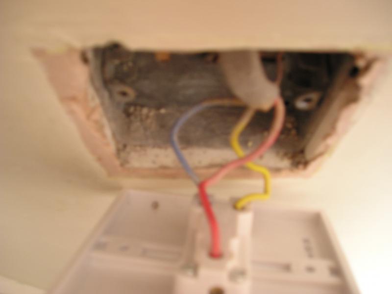

When the lighting switches were recently slackened off to allow for decorating, I was confused by the wiring. There is a 3 core and earth terminating in a 1 gang 2 way switch, but this switch only controls one light fitting. Why are there 3 (presumably live) cables entering a switch that only controls one light? (NB there are no other switches that control the light).

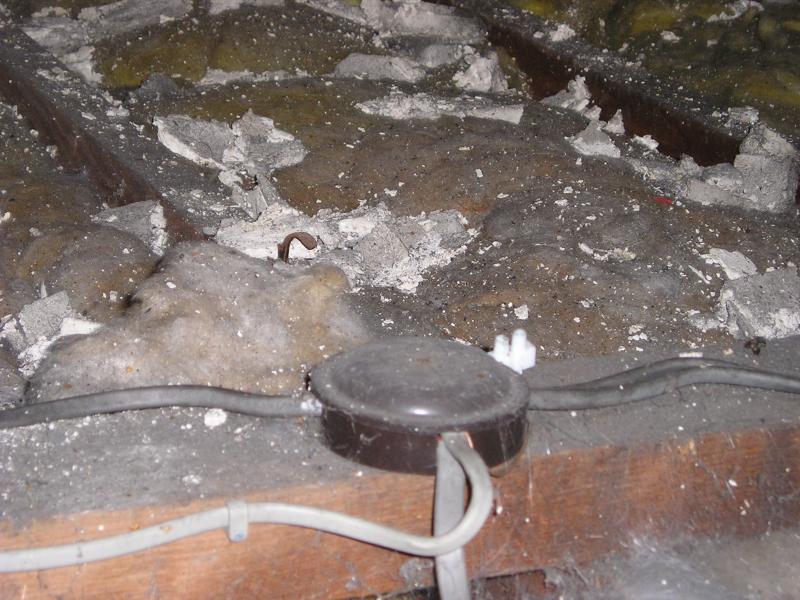

The 3 core goes up into the attic where it terminates in a junction box. From here is a feed for the ceiling rose which is simply one 2 core and earth cable which terminates in the ceiling rose. It appears that this junction box serves other lights on the circuit (and there are more of these junction boxes around the house serving the other lights) and I believe that the other switches in the house are wired similarly.

Definately 3 wires in there and all connected (NB lack off earth sleeving on earth to back box :( )! My parents have lived in the house for 20 years, and there have been no alterations to the wiring (apart from a couple of changes to new switch/sockets etc when redecorating). Also no switches in the attic or no other 2 way circuits apart from on the landing and stairs.
This switch is in a bedroom and was originally a dimmer which was changed a few years back. However no changes were made apart from a simple changeover of the switch. Other switches are wired this way in the house too so I think the dimmer was no different. I guess one wire could terminate amongst the others in that JB but all seems a bit over-complicated and pointless to me :?

actually was one other modification - the lighter grey cable at the front of the JB is 1mm2 two core and earth which goes to a wall light (with built in pull switch) on the landing!
Maybe the previous owner planned to make it 2 way one day so put the wire in for it. You will probably find one of the cores is not used and terminated in the JB. Nothing wrong using 3 core and earth by the way, however it is a little bit naughty not using earth sleeving!!

Check the junction box. Is either the yellow or the blue wire sitting in a terminal all by itself? If it is then, as others have suggested, it's been put in with a view to adding two-way switching - or a double switch - later or it's been part of a circuit long since removed. Either way you can safely leave it alone.
On the other hand, if both of these wires go off somewhere else you should follow them and find out what they do. :? :? :?
After the above posts, my guess is that the 3 core is for extending if required. This switch is in a bedroom but there has never been any pull cord switches in as long as my parents have lived in the house (20 years) and the house was only wired a few years before this. Btw the cables are all grey (no remenants left of the original 30s wiring). The house is a 30s semi and while the roof is still in good repair, it doesn't have an underlay under the slates and the attic is a bit dusty (and the cables a bit mucky). The white stuff on the loft insulation is the lime torching from the underside of the slates which has started to come away over the last year or so. And yes, it does need a bit more insulation up there! :oops:
Come to think of it, i believe there was a similar wiring set up in the lounge downstairs - when we moved in there was a main pendant and cabinet lights in the room which came off a double gang switch. The cabinet lights were removed shortly after and the switch replaced with a 1 gang switch (which now has the yellow disconnected in a choc block in the back box). When doing some unrelated work I found a junction box under the upstairs landing which had a 1mm2 twin and earth disconnected so I assume this is the old feed to the cabinet lights which were disconnected!
