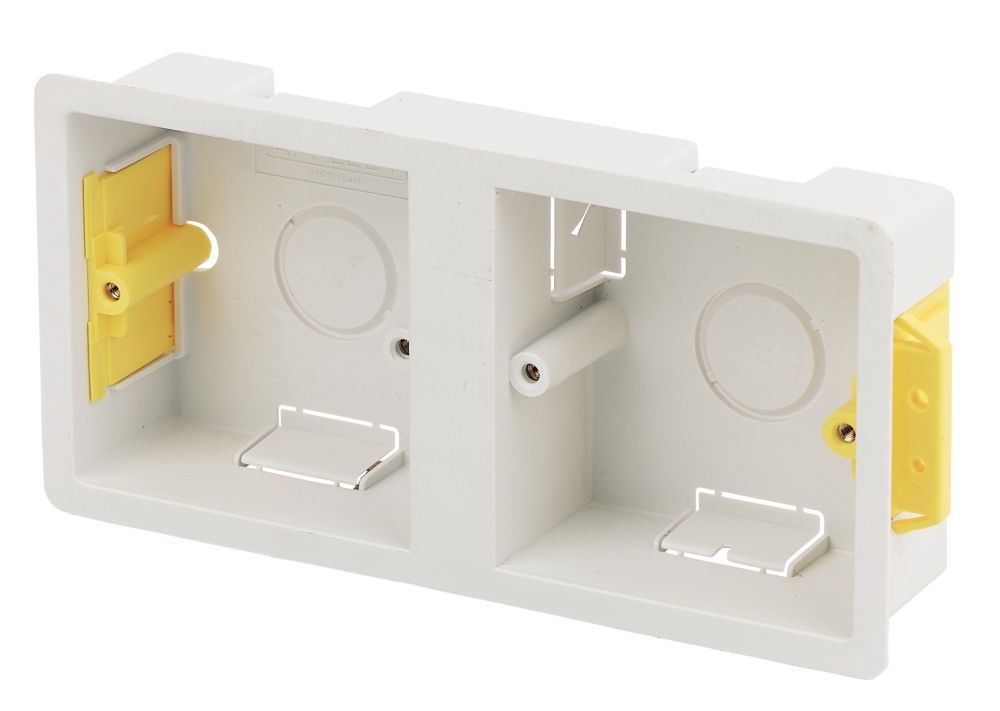

But the Smart switch you have needs a neutral, the non smart switches do not have a neutral, I have seen smart switches that do work without a neutral but only two gang not three gang and I have not found a slave that is part of a on/off switch, so with the make I use it would need a twin back box
ae235
and two switches to do what you want. And the switches are more expensive.
Sorry just seen the neutral in the pictures missed the black wires. However still not sure if it will work as you have 5 sets of lights not 3, please do say if it worked.
