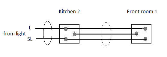

Hi There,
Firstly, just to let you know that I havent just posted looking for someone to tell me the answer without even looking for it !
I've spent ages reading up on the internet and looking at wiring diagrams but can't find my answer.
I've also looked at the how to's on here and couldnt get my head around it.
I live in a new build Taylor Wimpey House and wanted to replace all the light switches and sockets. I've done all of them all ok with no problems at all but I'm confused with my triple switches.
Firstly, I'm not sure If I'm using the correct terminology. I have 2 Triple Switches downstairs. I in the kitchen, 1 in the front room.
Each switch individually controls 2 lights and then both control the light in the hall way.
I've wired them up the same way that Taylor Wimpey did but its not working properly.
As individual switches they both work and turn on and off the 3 lights that they are responsible for.
The trouble is the light in the hallway.
If I have the light in the hallway turned on from the kitchen, then you can't turn it off from the front room but also one of the lights in the front room stops working (can't turn it on or off)
You then turn the light off using the kitchen switch and then you can use the other triple switch with no problem.
The way I have the kitchen switch wired up is (Which is how TW had it wired up)
Light 1 - (Brown wire ) in L1 - (2 * Brown wires + 1 * Brown wire looped into L2 for Light 2) in Com
Light 2 - Light for Hallway - (Brown wire ) in Com - (Black wire with Brown Sleeve + Brown wire ) in L1 and (Grey wire with Brown Sleeve + Brown wire looped from L1 for Light 1 + Brown wire looped into Com for Light3) in L2
Light 3 - (Brown wire looped from L2 for Light 2) in Com and Brown Wire in L1
The way I have the front room switch wired up is (Which is how TW had it wired up)
Light 1 - (Brown wire) in Com - (Black wire with Brown Sleeve) in L1 (Grey Wire with Brown Sleeve) in L2
Light 2 - (Brown wire and Brown wire looped in Com for Light 3) in Com - (Brown Wire) in L1
Light 3 - (Brown wire and Brown wire looped from Com for Light 2) in Com - Black wire with Brown Sleeve) in L1
Light 3 is the hallway light but I'm sure that previously Light 1 controlled the hallway light -
To be honest, previously I just swapped over the other light switches with not even thinking about anything, just making sure that I put the cable in the same place that they were in the old switch. I've know read up and understand about how a switch works but I'm confused with the wires that have been looped and so many brown wires!!! Also I have no idea why I have two black wires with Brown Sleeves in the front room switch - one going to Light 1 and one to Light 3
If you havent lost the will to live......Please help!!
