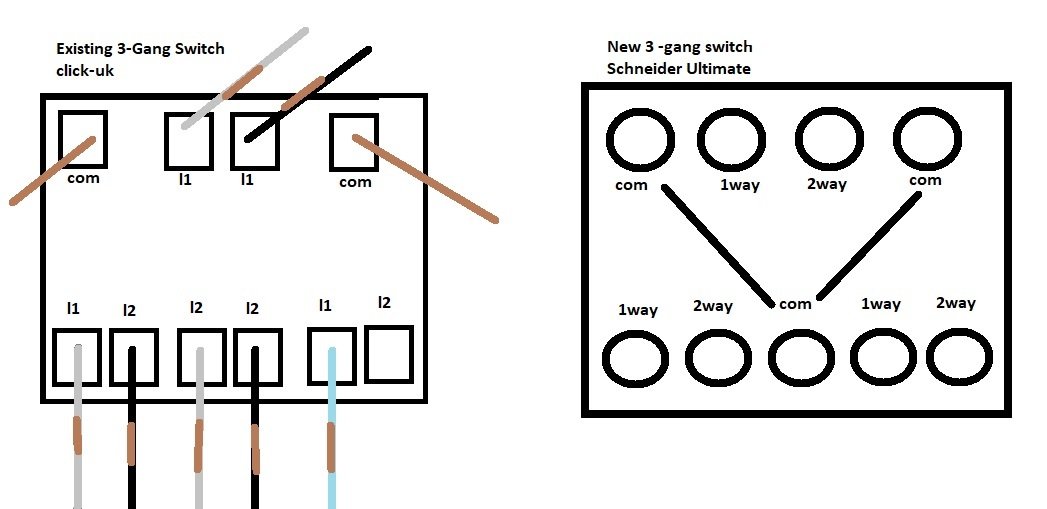

Hi all, i need to swap out an existing 3-gang switch and the layout on the reverse of the new schneider switch is different, please could someone ITK advise where the existing wires, colour coded on the diagram attached, need to go on the schnedier switch.
Many Thanks

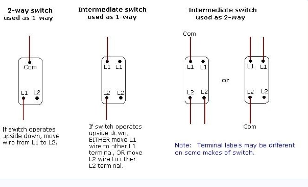

Looks like the middle switch is an intermediate on the old one and a 2 way on the new one so it wont work.
Left switch turns on the porch light (on/off), middle switch turns on downtsiars hall light, right sided switch turns on the upstairs light - theres a 2 gang upstairs that turns the hall light on/off and the upstairs landing light on/off.
Doesn't matter. It's not what they do but how they do it.
If you can find a switch to your liking that has three intermediate switches then you would be able to use it.
