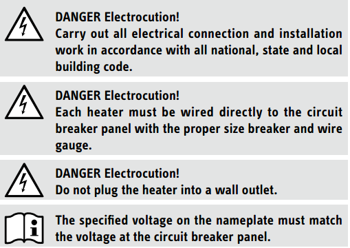

This from the only instructions I can find.
Albeit it is American and they only list heaters from 0.5 to 2.4kW.
http://www.stiebel-eltron-usa.com/sites/default/files/pdf/install-cns-e.pdf
Note the third:
British site:
http://www.ehsshop.co.uk/panel_heat...el_heater_with_24hr_timer_cns300ut_P1303.html
Yeah, EFL, I've now got a feeling it didn't come with a plug because when I was fitting the new switch yesterday I noticed the solid brass ends on the wires in the cable. Therefore if there had have been a plug it would have been a modern one that couldn't have been pulled apart. Also now I've looked at the website and it says ideal for bathrooms and it shows a picture with the cable going into a wall, so it probably does have to be hardwired.

Thanks again EFL. I think somewhere on the download instructions in says wire into a junction box so it must be ok to do what I've done.
New switch doesn't get hot by the way!
