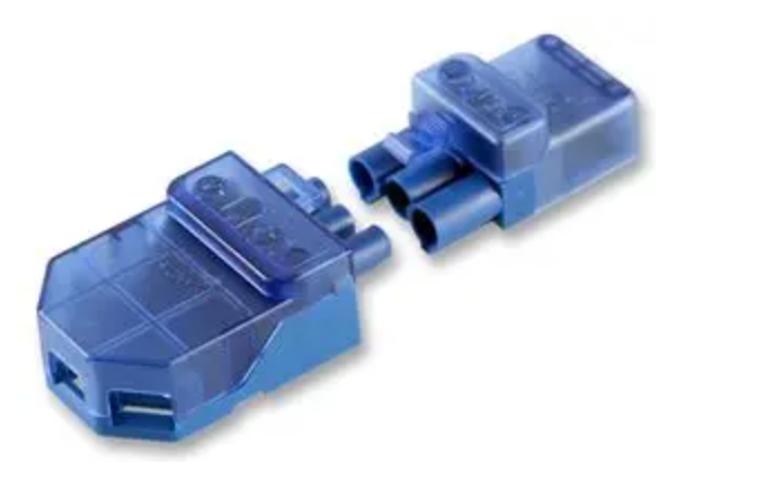

Hi
I moved into a new house and in the fridge space in the kitchen, instead of a normal 3-pin plug socket, there is just a wire coming out the wall with a '3-pin push connector' (image below) on. Does anyone know how I'm meant to plug my fridge into this? Am I to cut the normal plug off the fridge and connect the push connector to the fridge cable instead? Or somehow connect an ordinary 3-pin socket via the push connector? I've not seen this before so am confused about what to do?

Hi,
Your options are many, although a photo of the actual wire coming out of the wall and the socket, may help us narrow your options down.

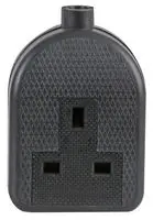

The actual socket/plug may be more like these:
These are more appropriate connectors than the image you link to, with built-in cable strain relief etc.
