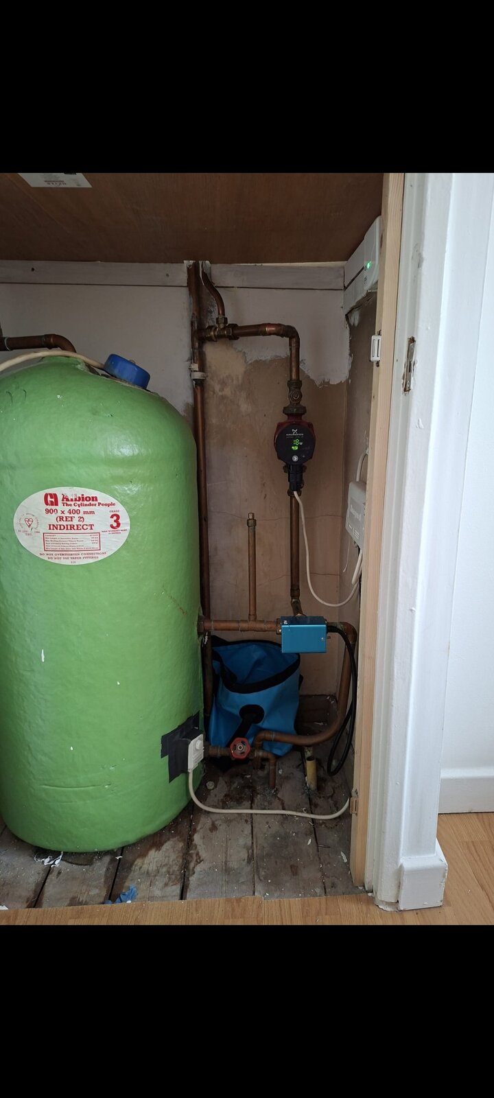

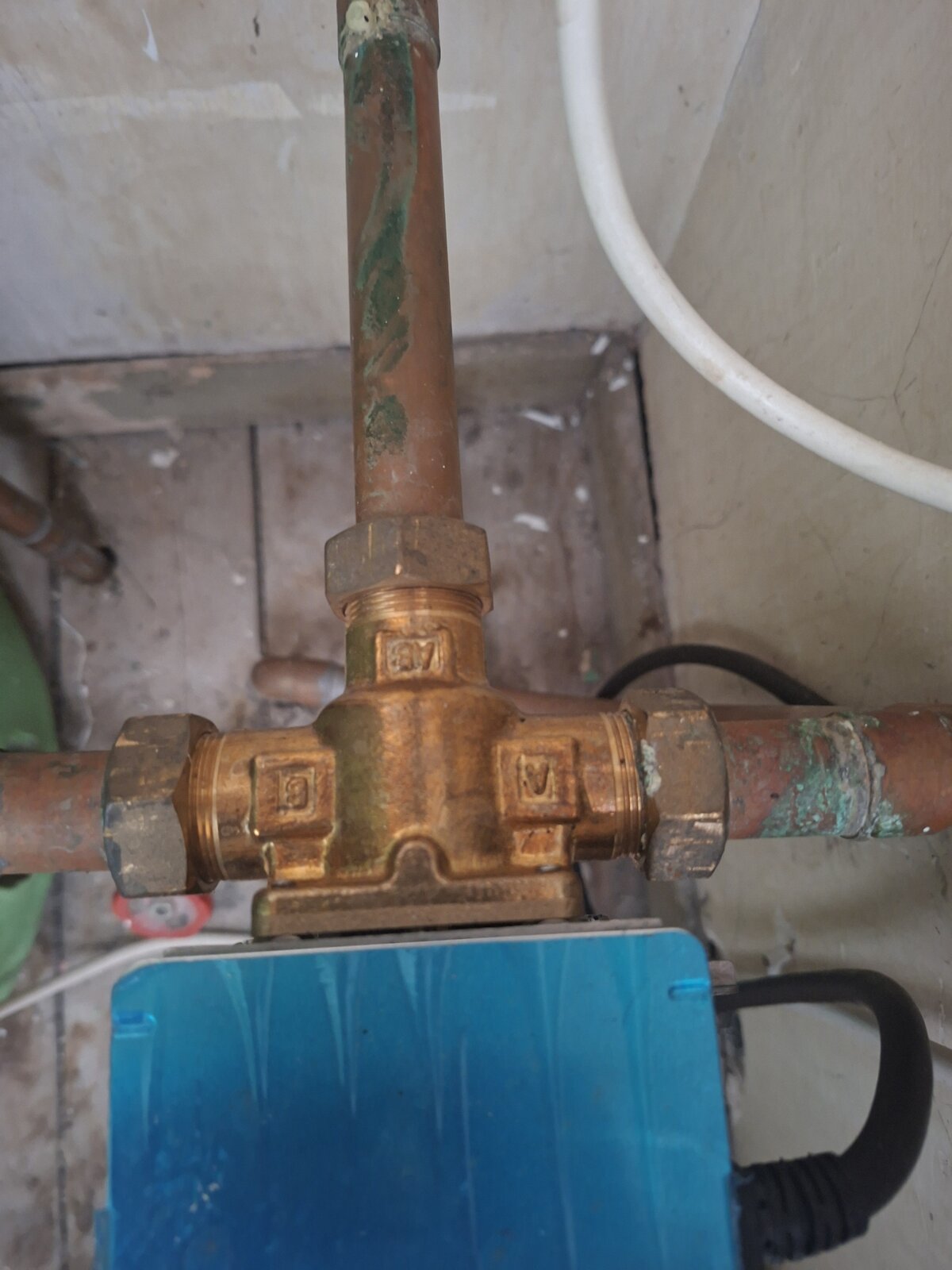

Can anyone advise is this 3 port valve piped correct.
B is going to the cylibder is this correct ?
I had a boilor break down. 3 port got changed then got banging in pipes mainly above pump.
T is not blocked. I got this changed. All radiators heating up hot and bled. Thermostat got changed. Pump lowered down.
I can only think the new 3 ports shuts faster than old one causing back hammer ?
Any ideas

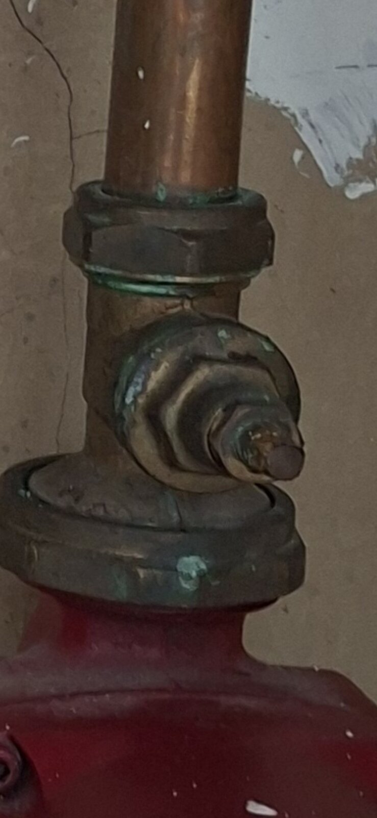

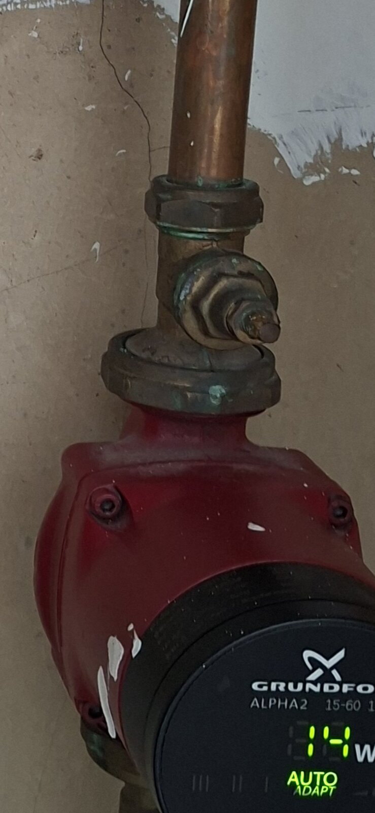

When a engineer changed a 3 port valve 2 months ago this bamging started. I am not at the property.
But if they shut the pump valve to work on 3 port and not opened back up fully could this cause the banging
Is itva spanner to turn this valve. Anyone please ?

Its to slow down the flow around the coil if needed , going on that picture I would say the cold feed to the cylinder is going to be on the left some where.
Yes a spanner will work on that valve , looks like it may have snapped to me .... or it might just be the angle of the pic

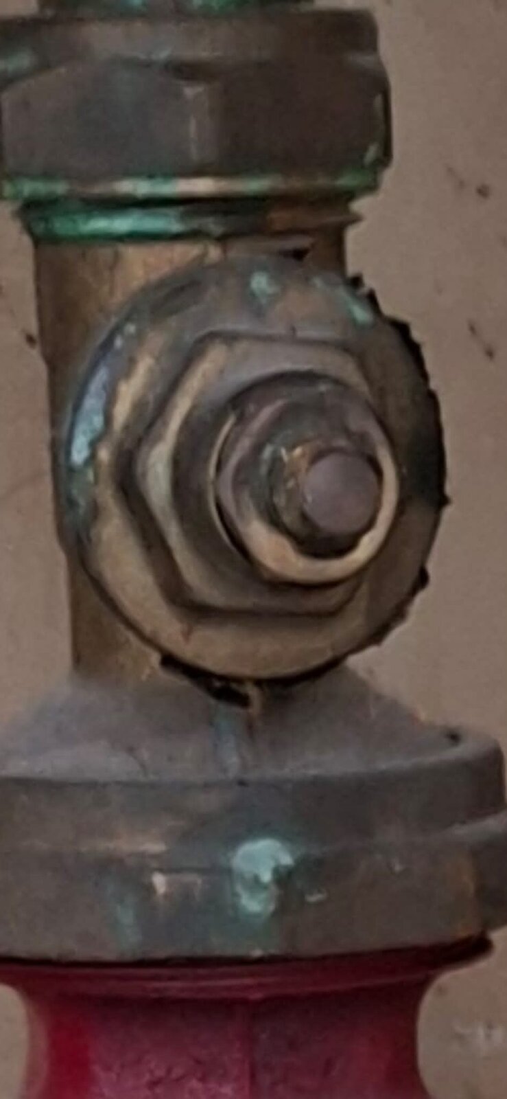

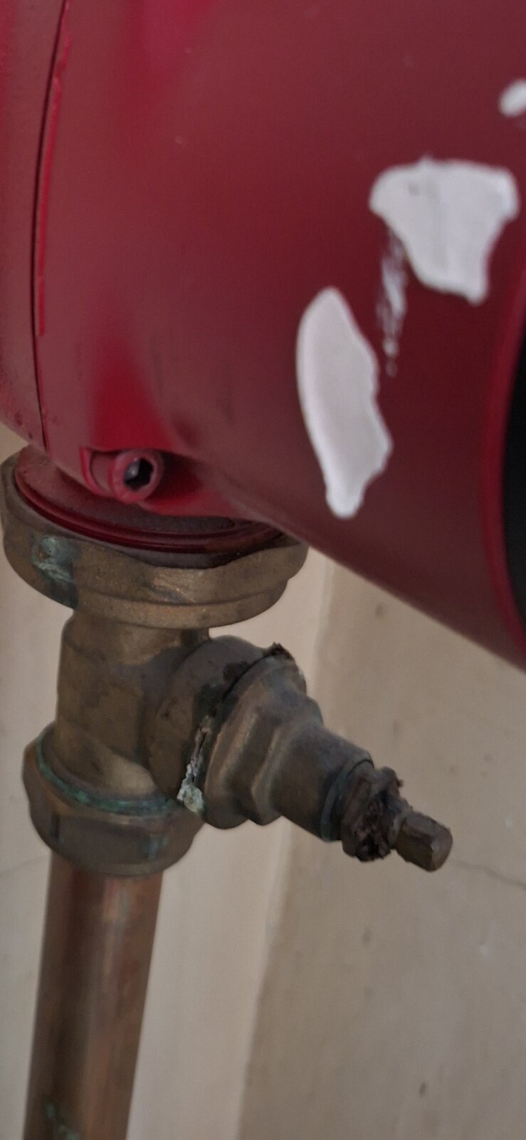

Here is a better picture. Could tjese valves be blocked up causing bamging.
Or if they got shut off to chamge 3 port could the valves of not bee. Fully opened or seized ?
Anyone help much appreciated. I have a bamging noise and getting grief of tennent

I'm sorry not following B is on hot water and A is on central heating ?
Are you saying there is something not right with the new 3 port setup ?
