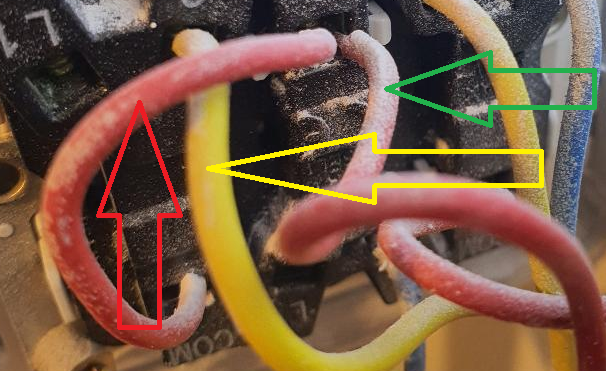

Hello,
I have a 3 way light switch, one feeds the upstairs light, one downstairs and one that feeds the porch light.
I wanted to get rid of the porch light as somebody always switches it off anyway and my hue smart bulb never works. I've also fed from somewhere else now.
My question is, how do I know what cables I need to unwire from the switch?
Here's a pic of the switch if this helps. Thanks

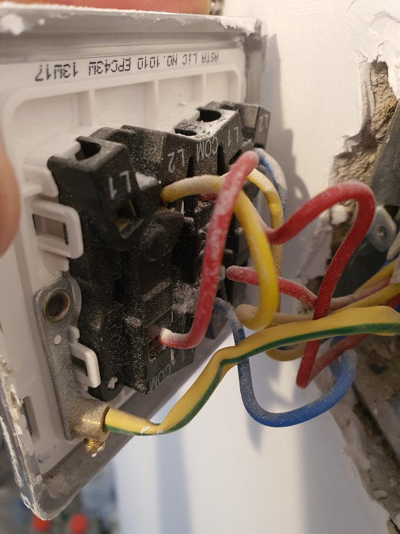

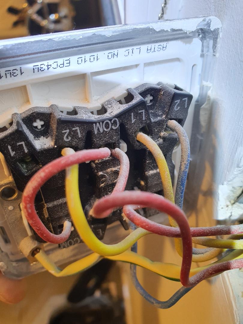

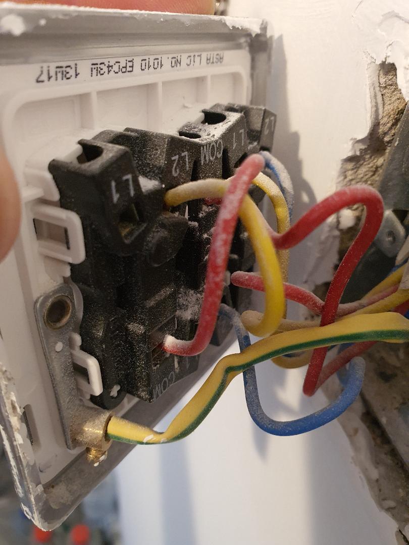

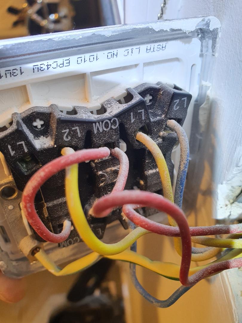

Sorry for the delay. Yeah, I could have mentioned this in my initial post..... The switch I need to decommission is the one to the far right, which would be the far left in the pic (the side where the earth cable is).
I'll grab a better pic tomorrow.
Let me know if this is any good.

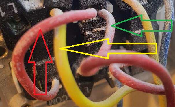

If all you want to do is safely stop the switch doing anything, the simplest way is to remove the red link [arrowed red] and make sure the red wire [arrowed green] is secure when the screw is done back up.
If you are replacing the switch with a 2 gang, remove the link then disconnect the yellow wire [arrowed yellow] and make it safe such as putting a choc bloc on the end. That will leave a completely empty switch.
View attachment 231240If you are replacing the switch with a 2 gang, remove the link then disconnect the yellow wire [arrowed yellow] and make it safe such as putting a choc bloc on the end. That will leave a completely empty switch.
That's brilliant, thanks very much for taking the time to reply. I will sort out at the weekend. Is it safe to test the other end of the cable afterwards with a multi meter?
Set it to acV higher than 240, test before and after.
