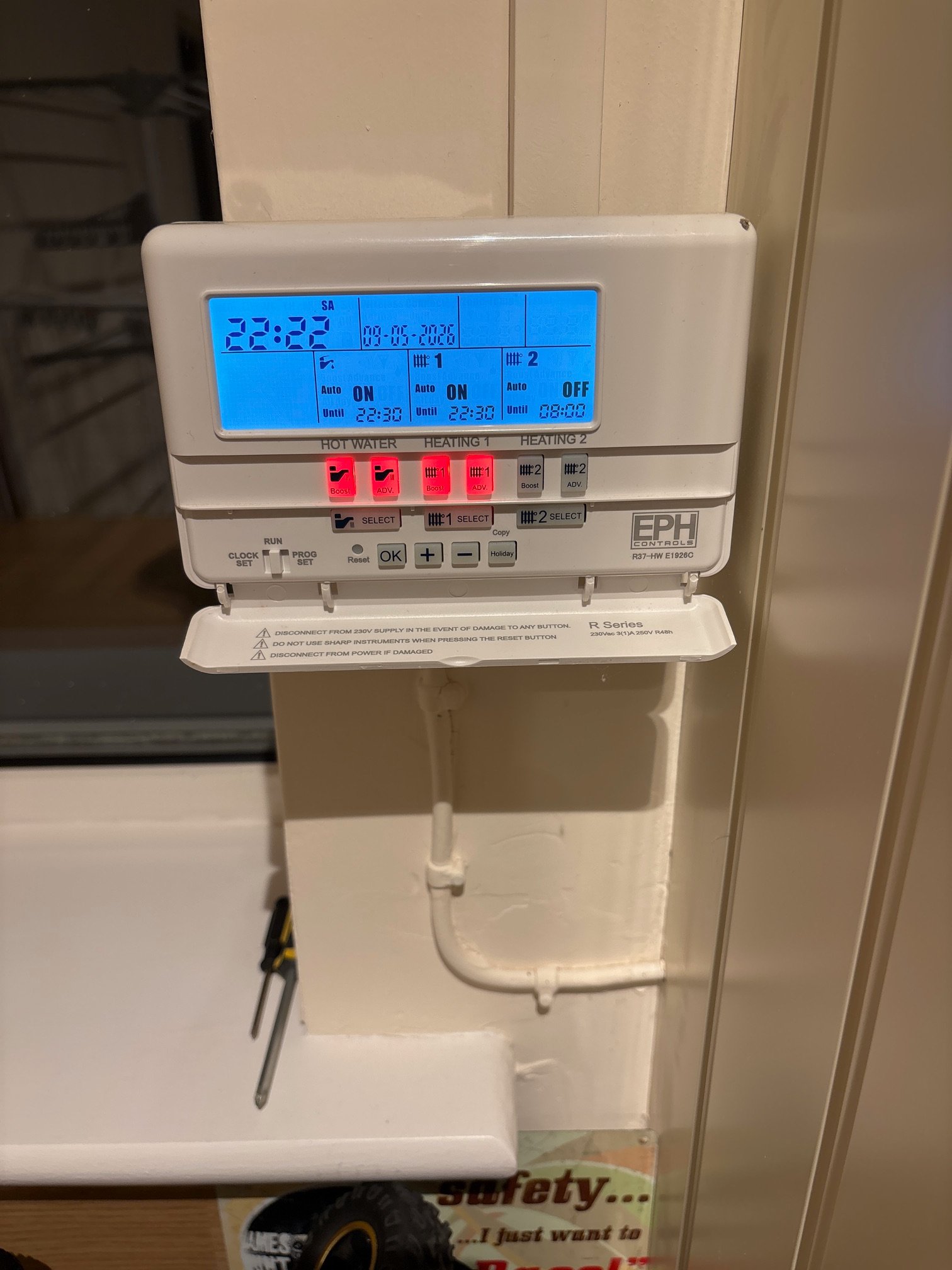

Here's Tados ' reply if you're interested:
Hello,
Thank you for contacting us.
From the information you provided, I understand you have a triple-channel programmer.
This programmer controls two heating zones and one hot water zone. However, the tado° Wireless Receiver X is a dual relay programmer and controls one heating zone and one hot water zone only.
So, your programmer is incompatible with tado°, and our devices can’t directly replace it, nor can we provide wiring instructions.
However, there are two possible options:
1. You can replace your current wired room thermostats with our wired Smart Thermostats X. For that, you will need one Wired Smart Thermostat X - Starter Kit + one additional Wired Smart Thermostat X. Your triple channel programmer should be set to always on so the Smart Thermostats X can control the individual heating zones.
or
2. You can ask your local professional installer to rewire your heating system so you can control both your hot water and your two heating zones with tadoº. Keep in mind, we don’t provide installation instructions for wiring the tadoº Wireless Receiver X in this case, but your electrician may use our professional manuals for assistance.
For this setup, you will need one Wireless Smart Thermostat X - Starter Kit + one additional Wired Smart Thermostat X.

Here is Wisers:
Thank you for your reply.
The wired thermostat would need to be disconnected, or otherwise altered to stop it from interfering with Wiser. Please see the link below:
I have a wired thermostat connected to my boiler - What do I do?
For the Wiser side, you need two thermostats (and the 3-Channel Hub -> Hub + Thermostats = Kit 3) to control two heating zones. You cannot assign one thermostat to control both heating zones at once, and generally this would nullify the benefits of having separate heating zones to begin with. If you would prefer to have a single thermostat controlling the entire home, it is best to adjust the plumbing so that it is only a single zone system.
If you have any further thoughts or queries, please let us know.
Have a great day.
Kind regards,
I have the attached.
