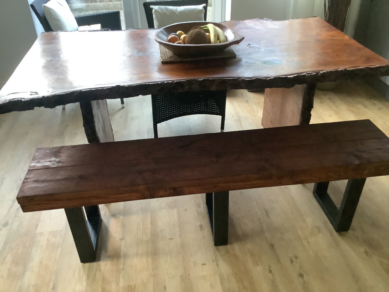

Bench in pic is two scaffold boards.

Thanks @foxhole how did you join them? Dowels and PVA? Did they need planing? I had assumed scaff boards would need drying and then resawing or some other edge finishing before joining.

Secondhand boards cleaned up with these on a grinder .
Then light sanding with orbital sander .
They are just butter together , the metal legs have screw holes which keep them together , offcut of board can be used to join in lieu .
Dyed and oiled .
