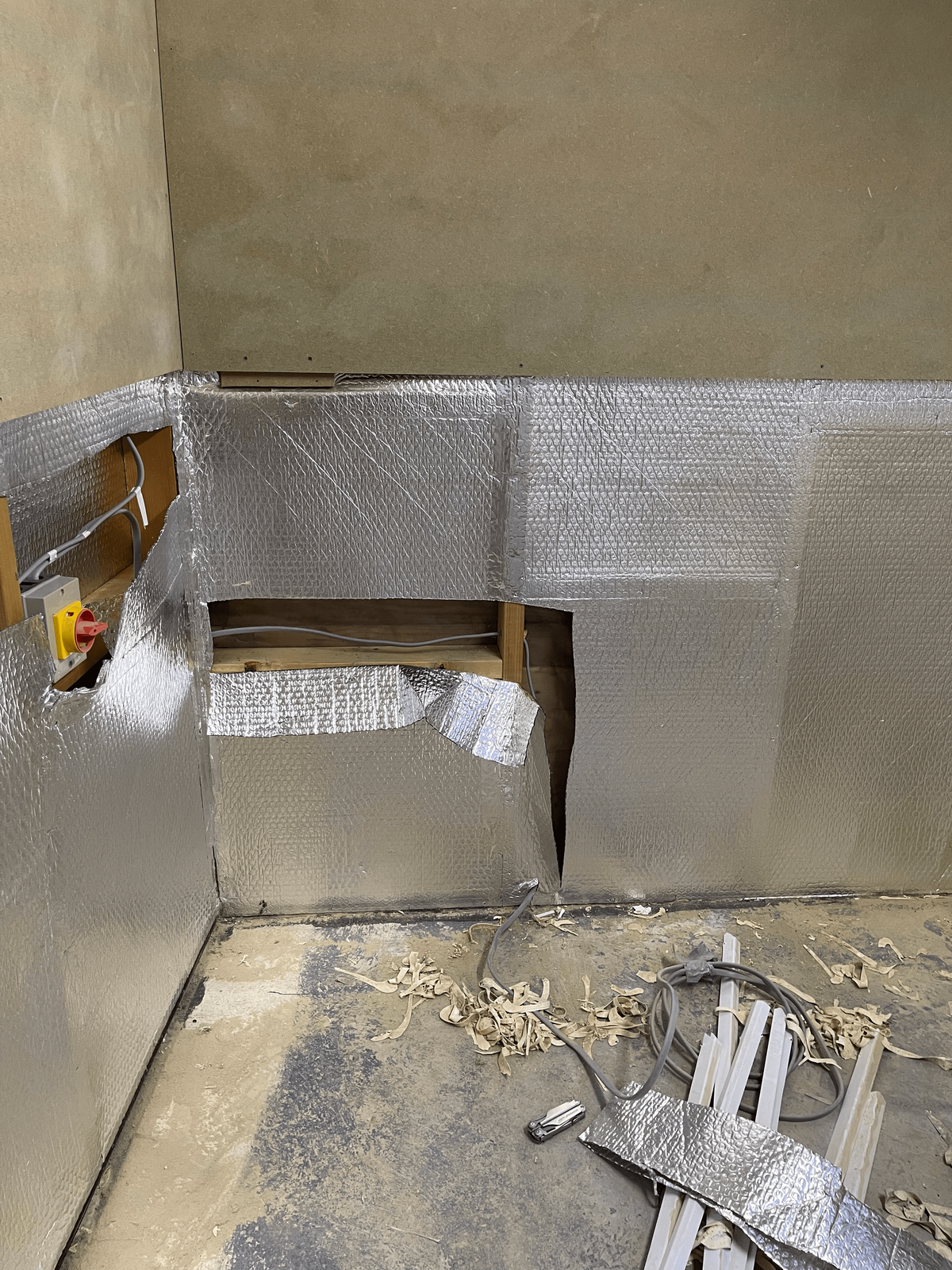

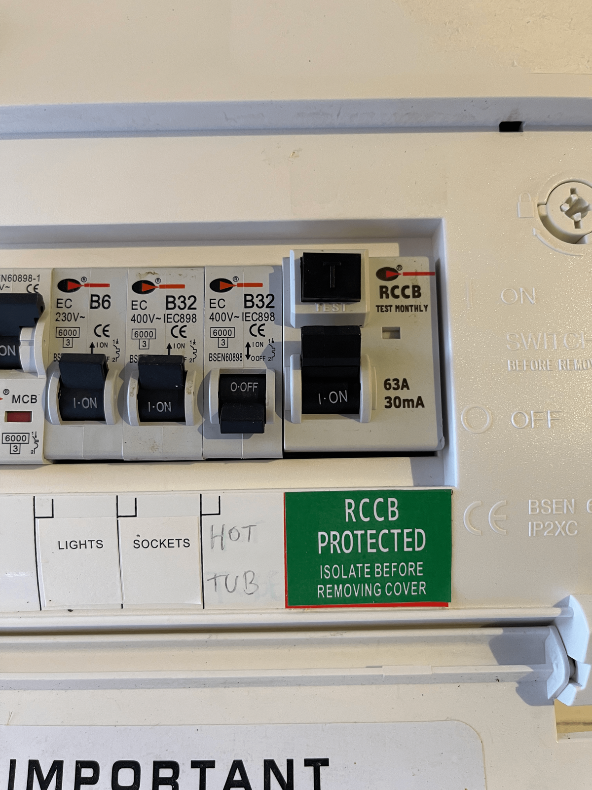

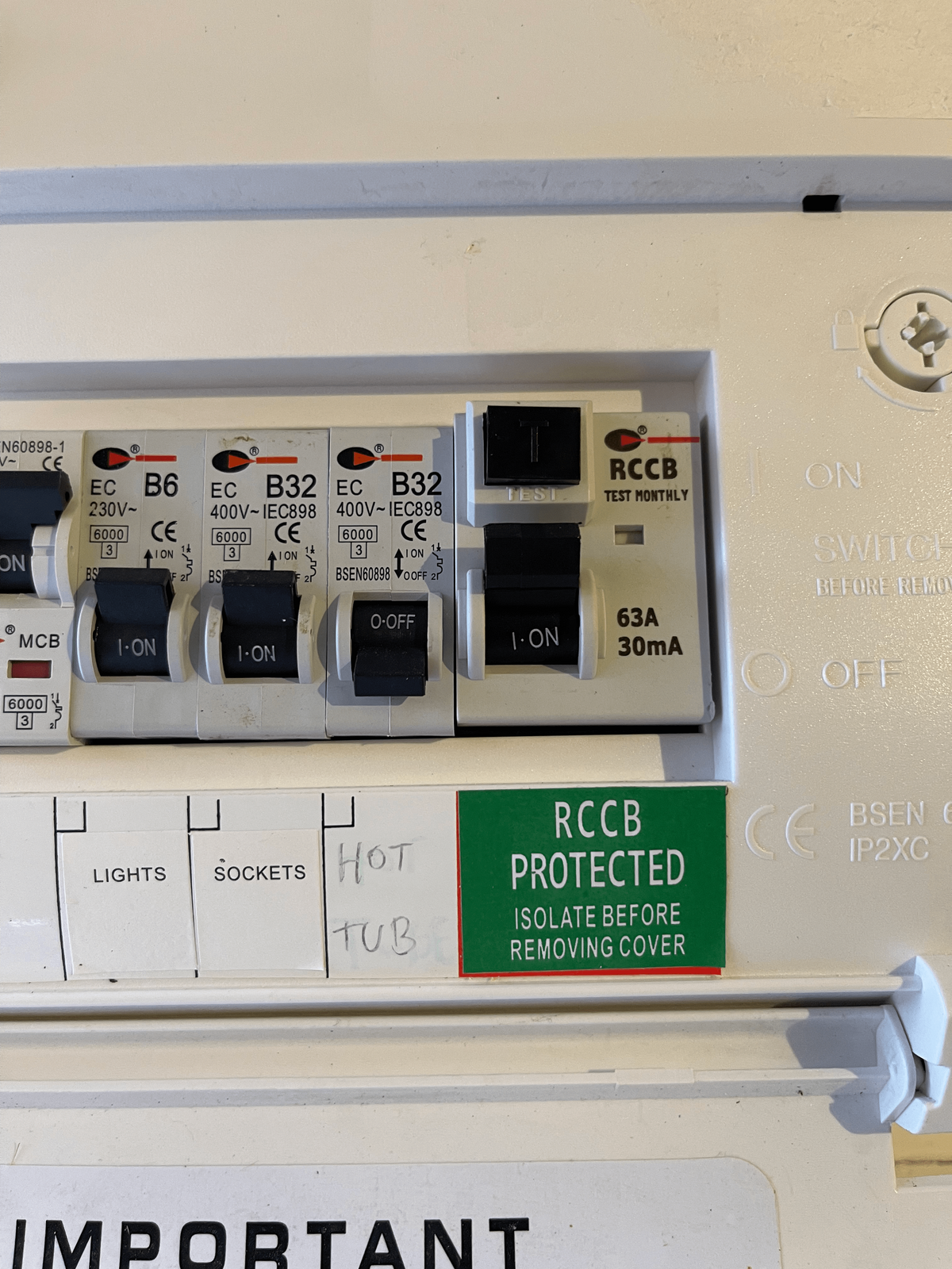

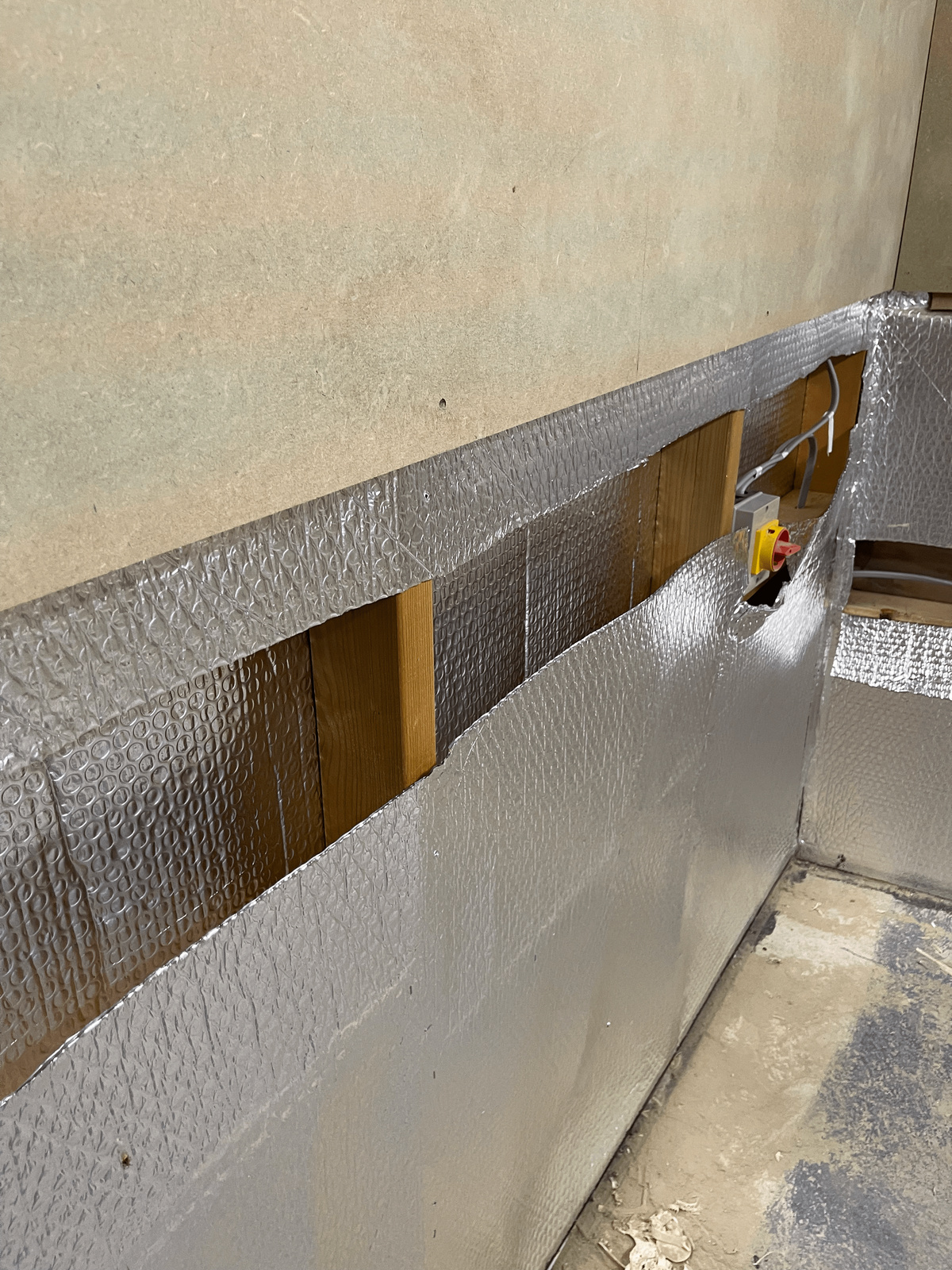

New to the forum and looking for a bit of advice on electrics. The house we bought had a hot tub in a shed in the back garden, we aren't hot tub people so it got yeeted and on to a new home. The room it was in is going to be a bit of a workshop/crafting space and needs rewired to suit. What remains are the 32A RCD in a consumer unit in the out building (below)

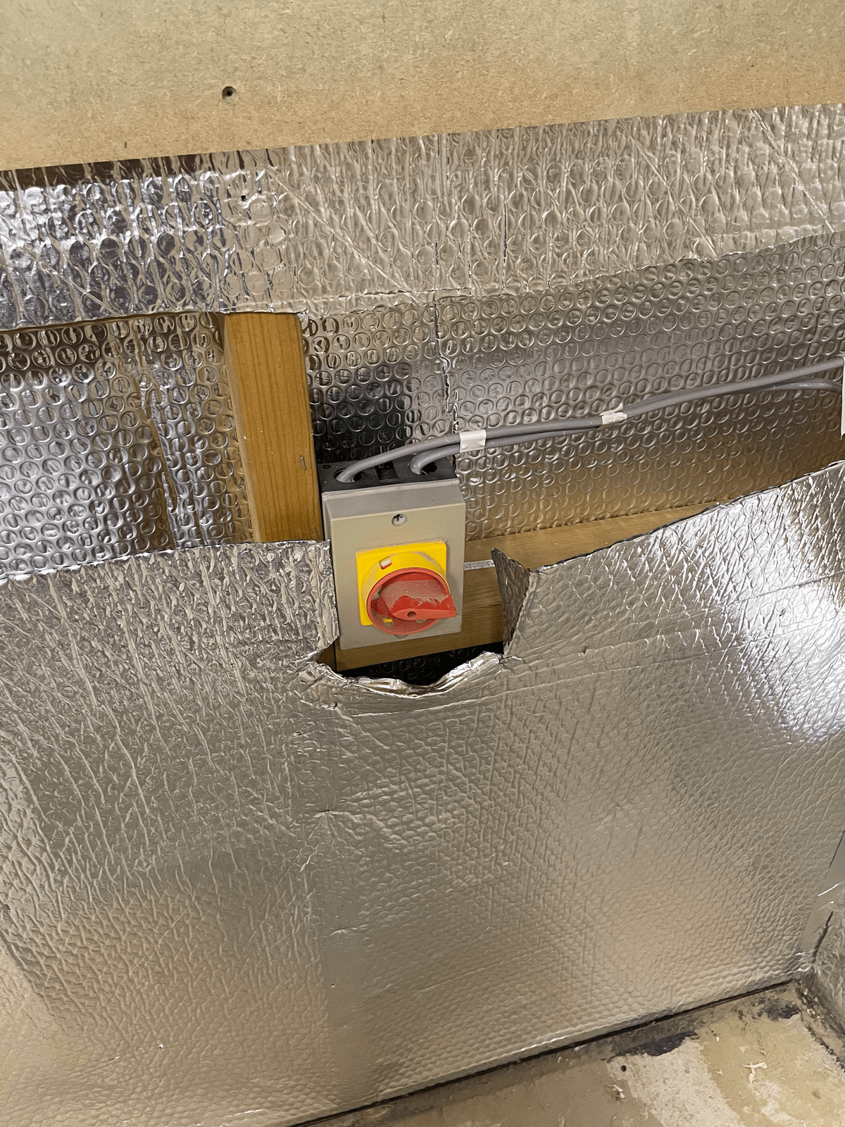

and a 32A isolation box and some cabling (below)

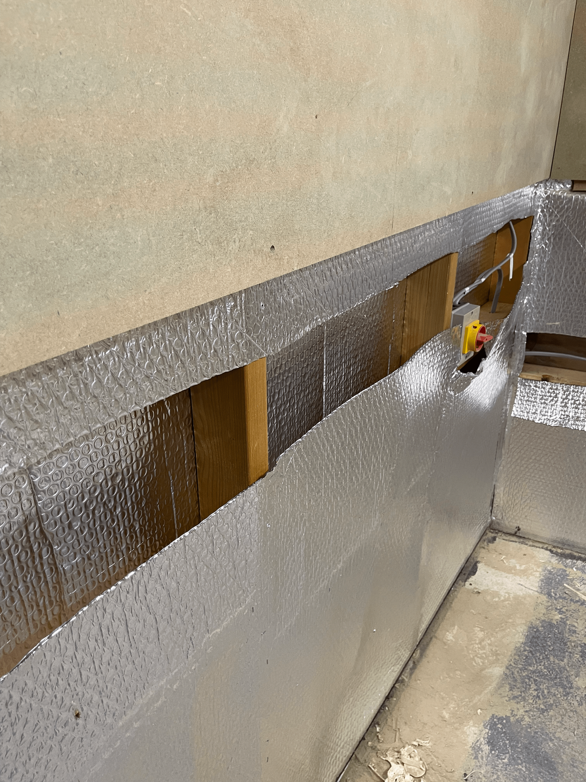

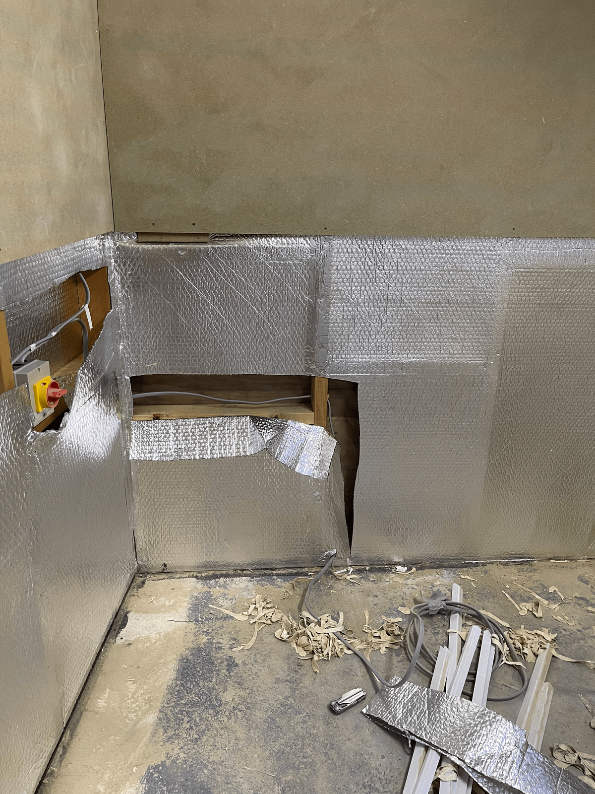

What I want to do is put 2 sockets on each wall shown below.

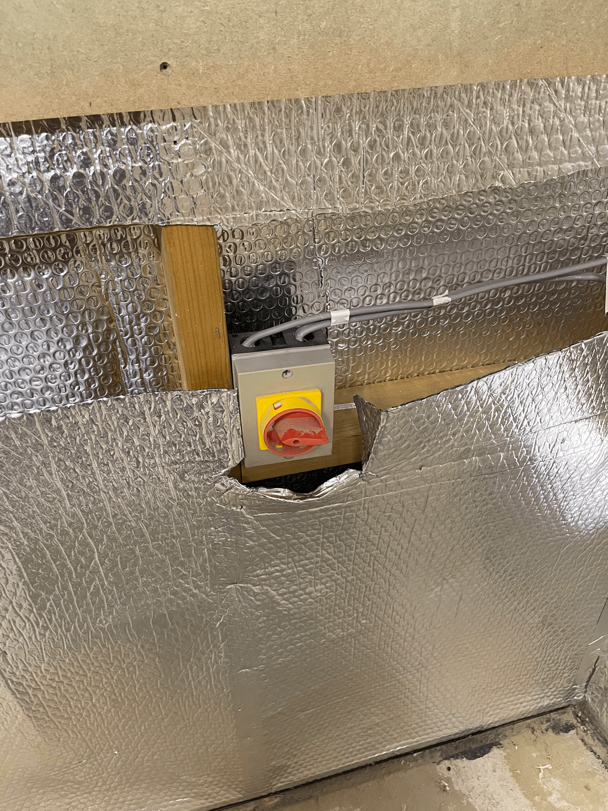

My plan is to make use of this as a radial circuit and replace the 32A wall isolator with a 2 way junction box and have two sockets on one side and the other two on the other using the spare cable I have that was plugged into the hot tub. In my head is the following diagram below

I will need a junction box rated to 32A but will this work on a technical level and be up to the standards that the regs require. I'm not an electrician however have done some electrical based stuff as part of my job but have received training in that however when it comes to electrical installations I have some knowledge that is needing some confirmation.

Well, lots to consider. But first, your diagram would be OK, but the connecting cables cannot be smaller than 4mm². You may have problems using large conductors in to the sockets.
The way that i would do this is to chuck out everything but the 32A MCB and create a ring final circuit using 2.5mm² cable.

To confirm that CU is in the outbuilding and supplied from another CU (in the house?) by what protective device and what cable?
What is connected to the other MCB's marked Lights & Sockets?
You can do what you propose, but that RCD is an obsolete Type AC and will need to be replaced with a Type A.

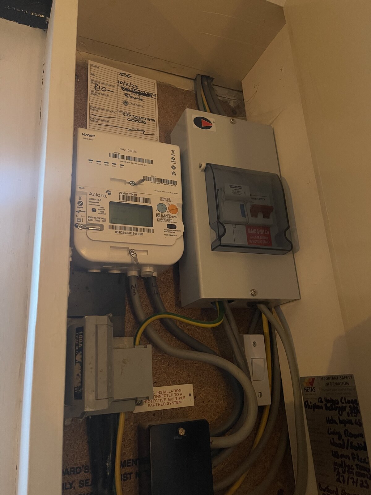

So i thought that assumption was right however I don't think it is. There doesn't appear to be a MCD relating to the out buildings in the CU in the house (we have two out buildings-one is more of an office type space which has two "rooms" the one that i'm needing to add sockets in, the other is a shed) Both out buildings have their own CU's in them supplied with big chunky black cables (don't know the gauge but about 15mm in diameter maybe more. The other two MCB's marked lights and sockets control the lights in the whole out building and the sockets in the "office room" of the out building. I want to change the one marked hot tub to a new socket radial in the other room of the out building.
Probably fed from switch fuses, rather than from the house CU then. Post a photo of the meter area and any associated boxes.

So this is the meter cupboard and I can confirm that the big white box does indeed isolate the power outside to the shed(s). Good to know for the future on that one and if I want to be absolutely damn sure that power is dead outside I can properly shut it off.
After some consultation with more electrical inclined people at work (I’m more mechanical biased) my proposed solution is the one already mentioned by Taylortwocities but I’ll retain the 32A MCB in the sheds CU, retain the 6mm2 T+E into the room (to remove this would be a massive pain) but remove the rotary isolator and replace with a wago junction box, which I’m right in thinking would be classed as maintenance free provided I use the right connectors and right box. This then allows me to connect the 6mm2 T+E and create a ring using 2.5mm T+E to connect the sockets up to the wago box.
