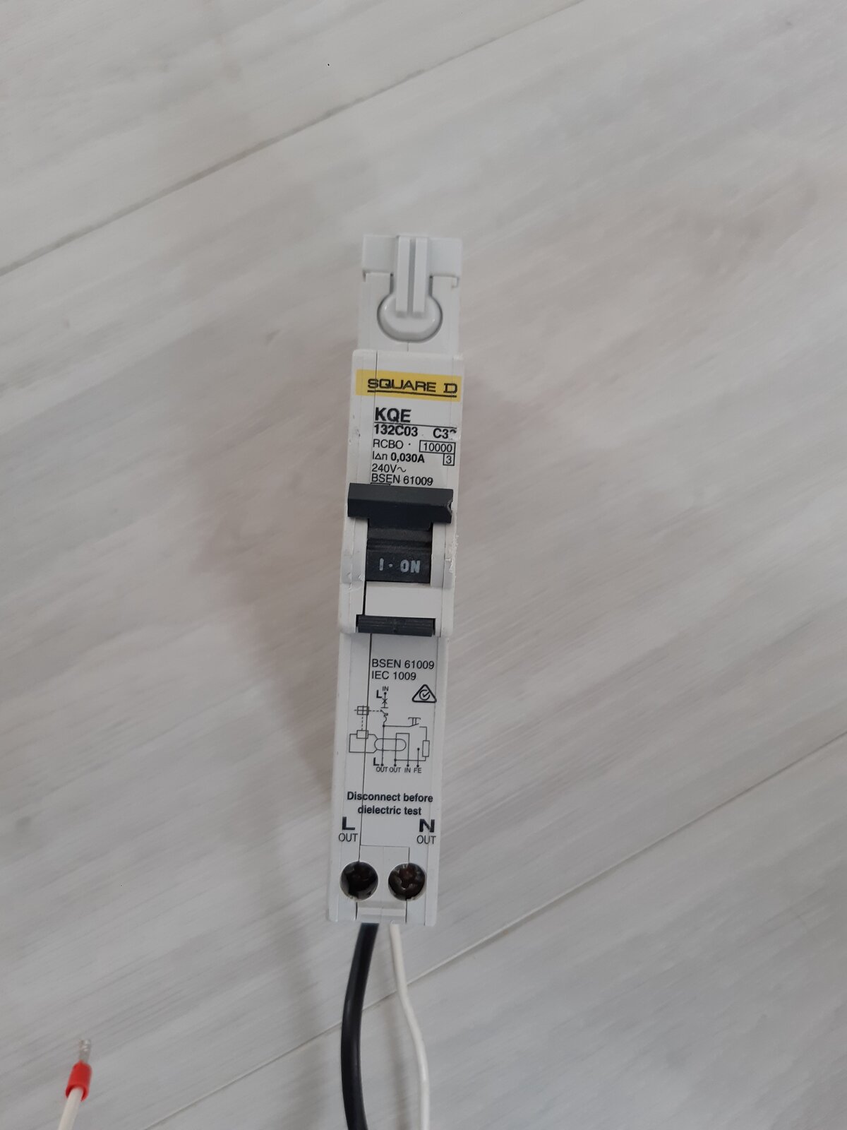

32 amp RCD in one of the power circuits at home does not stay on i.e. not working even if all the sockets are off. I have just replaced it with another working one and still the same. Then I replaced it with a normal 32 amp MCB and this one is working. this gives me the indication that there is no leak between the natural and the live but still can not understand why it is not working. Any help will be highly appreciated.
32 amp is not a common size for a RCD, for a RCBO yes, for a MCB yes, but it seems you may be using wrong names.
Can you start again, so we know what your talking about?
this is the one that is not working
32 amp RCD in one of the power circuits at home does not stay on i.e. not working even if all the sockets are off. I have just replaced it with another working one and still the same. Then I replaced it with a normal 32 amp MCB and this one is working. this gives me the indication that there is no leak between the neutral and the live but still can not understand why it is not working. Any help will be highly appreciated.
You have a leak to earth. Are any of your sockets outside/under a sink or anywhere else liable to get wet?
That is an RCBO, it is a MCB and RCD combined. Since an MCB works seems not an over load but earth leakage, and it is not easy to find, I have just treated myself to a tester,

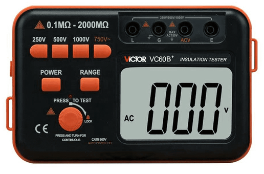

on the right so I can test how much leakage there is, think it cost around £35 it was about the cheapest I could find, and also one of these 1663671331253.pngcan be used, the VC60b shown again around £35 and you have then got to learn how to use it, and since it uses 500 volt it can be shocking.
So in the main you look for likely problems, which includes unplugging anything not in use, as a neutral is rarely switched and a neutral to earth fault can trip the RCBO, and if you can't easy find it, then likely cheaper to get an electrician than to buy the equipment to test with, even if your willing to learn how to use it.

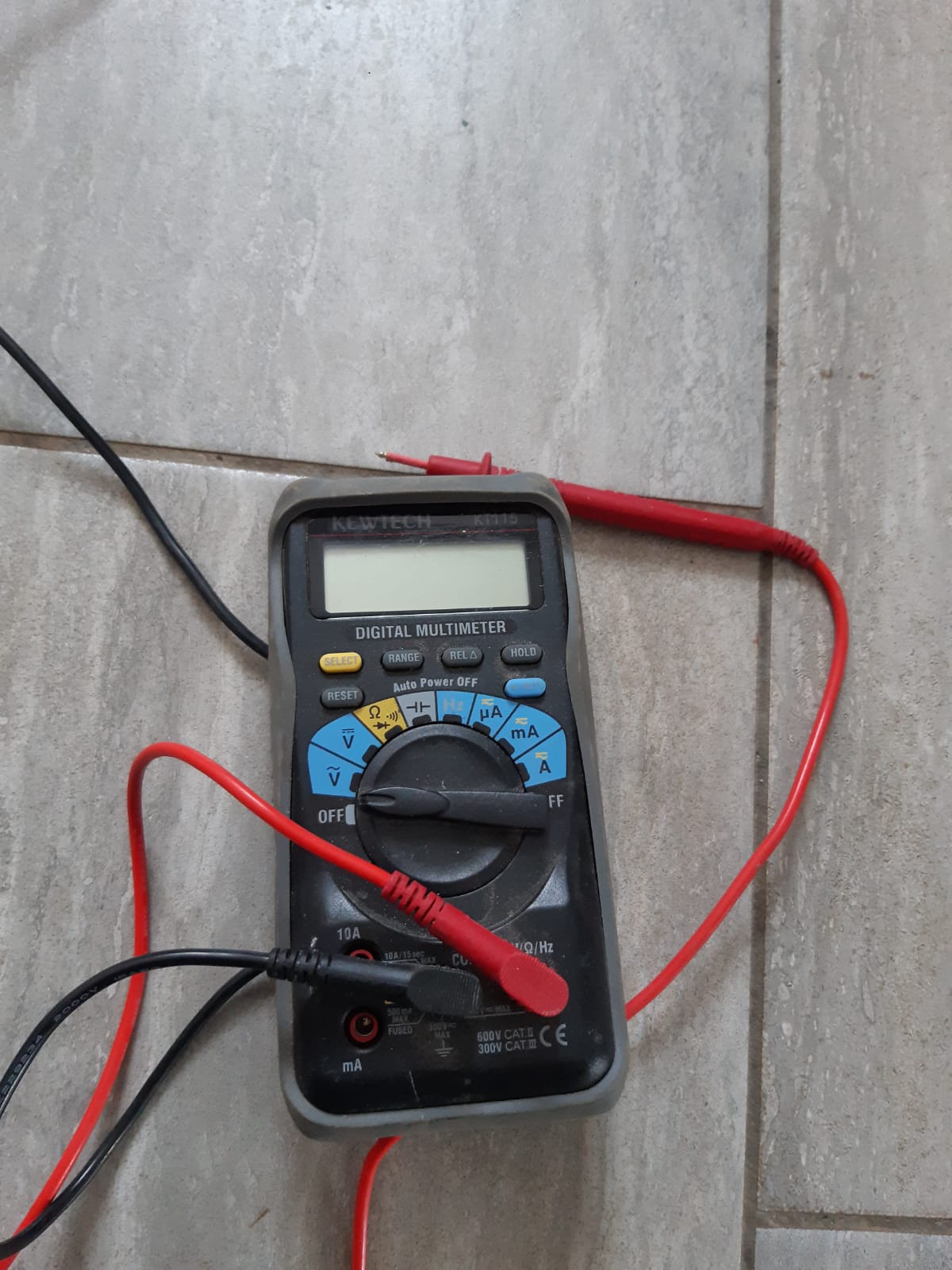

I have this tester and know how to use it if someone let me know what to test.

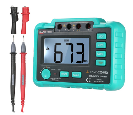

I actually bought an insulation tester to do daughters house, this 1663678174663.pngone, but meters no good if you don't know how to use it.
