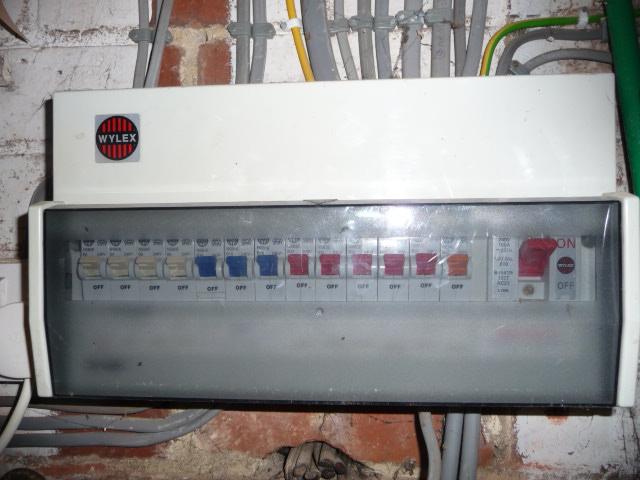

It looks like some sort of TN-CS conversion done by the DNO, possibly to earth the sheath of their supply cable. There doesn't appear to be any of the earthing leaving the supply head area to your side of things so you could quite easily be on a TT system.
Can you post a pic of your consumer unit?
Can you see one of the green/yellow wires between the consumer unit and the earthing on the DNO cutout?
Is there anthing else in the meter tails between the meter and the CU?
There is a real possibility that your installation does not have an effective means of earthing, my advice is to get an electrician in to check this out as soon as possible.
I guess I should get it checked, though I remembered I had a full structural survey including an NICEIC report back in 96 before I bought the house; I looked it up and has "TN-S" ticked. But re-reading it now, I notice it suggest a full re-check after the recommended rewire, so maybe it's time to do that now
I just realised I never posted the upshot of this -- I got an electrician in who did put in an earth between the breaker box and the master supply. The 37v problem was finally traced to a miswire in the double pole switching units in for the lights -- though not sure exactly why this caused it. Any how, problem got sorted . Thanks to all for their advice.
