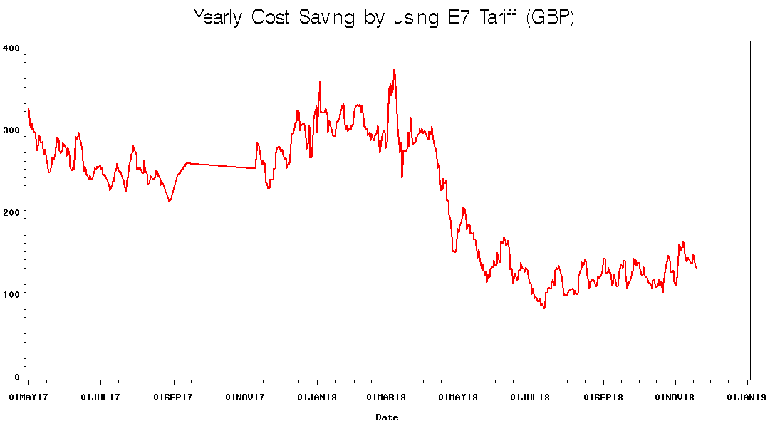

    Talking of "spending less with an E7 tariff", I don't know how widespread it is, but in April my supplier (E.ON) changed its tariffs such that the 'best available E7 tariff' deal resulted in my saving as a result of having E7 (with no appreciable changes in total usage, or day/night usage patterns) falling to less than half of what it had been previously (the unlabelled {which I've only just noticed!} y-axis is £/year saving) ...
    Kind Regards, John

    E7 and it's variants including the old 'white meter' rates were introduced at a time where overnight demand for electricity was low, most businesses being closed overnight.
    It made sense then to offer a lower price to increase demand, rather than have power stations idling and wasting away fuel.
    Today it's far less relevant, as night demand is higher than in the past, many industries use power 24/7 and future overnight uses such as large numbers of electric cars charging are likely to result in the demise of E7.

    Yes, that seems to be what's happening. It was really the suddenness of the change which surprised me. In the 30 years prior to April 2018, the day/night ratio of prices we've been paying has remained largely unchanged and then, suddenly, the very marked change I illustrated - but it is beyond belief that the general increase in night-time usage has arisen suddenly and recently.
    As for the electric cars, yes, as I've suggested before, if it ever happened (not in my lifetime, I'm sure!) that most cars became electric, we might even reach the stage at which 'reversed' dual-rate tariffs made sense - i.e. if daytime became the 'low demand' period of the day!
    Kind Regards, John
