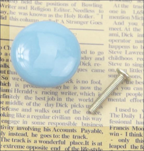

Anyone know a good place to buy 41 cheap blue cabinet knobs? Sheesh the cheapest are £45. Am I stingy in thinking this is a lot just for cabinet knobs?

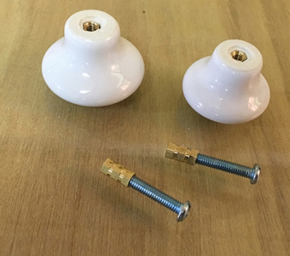

Wow thanks Jon, I would never have found that site without you. They sell them with two different kinds of bolt and I don't know which is right for a standard UK Magnet kitchen cabinet?

I've no idea. Did you see the 50 day delivery time ... hopefully they won't take that long to arrive!
In my experience, pine knobs normally use regular wood screws.

With regards to your earlier question about machine screws, door are typically 19mm thick. You might have problems with a 22mm long screw. If it is available, 25mm might be better.
