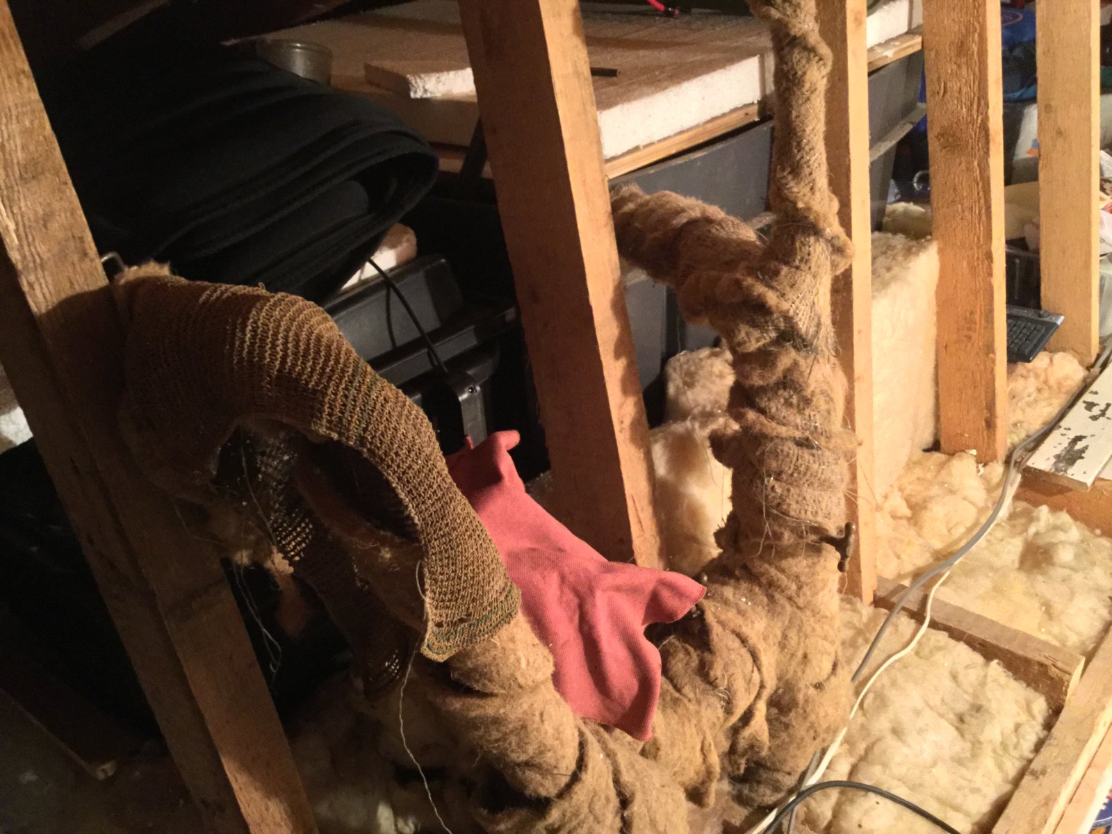

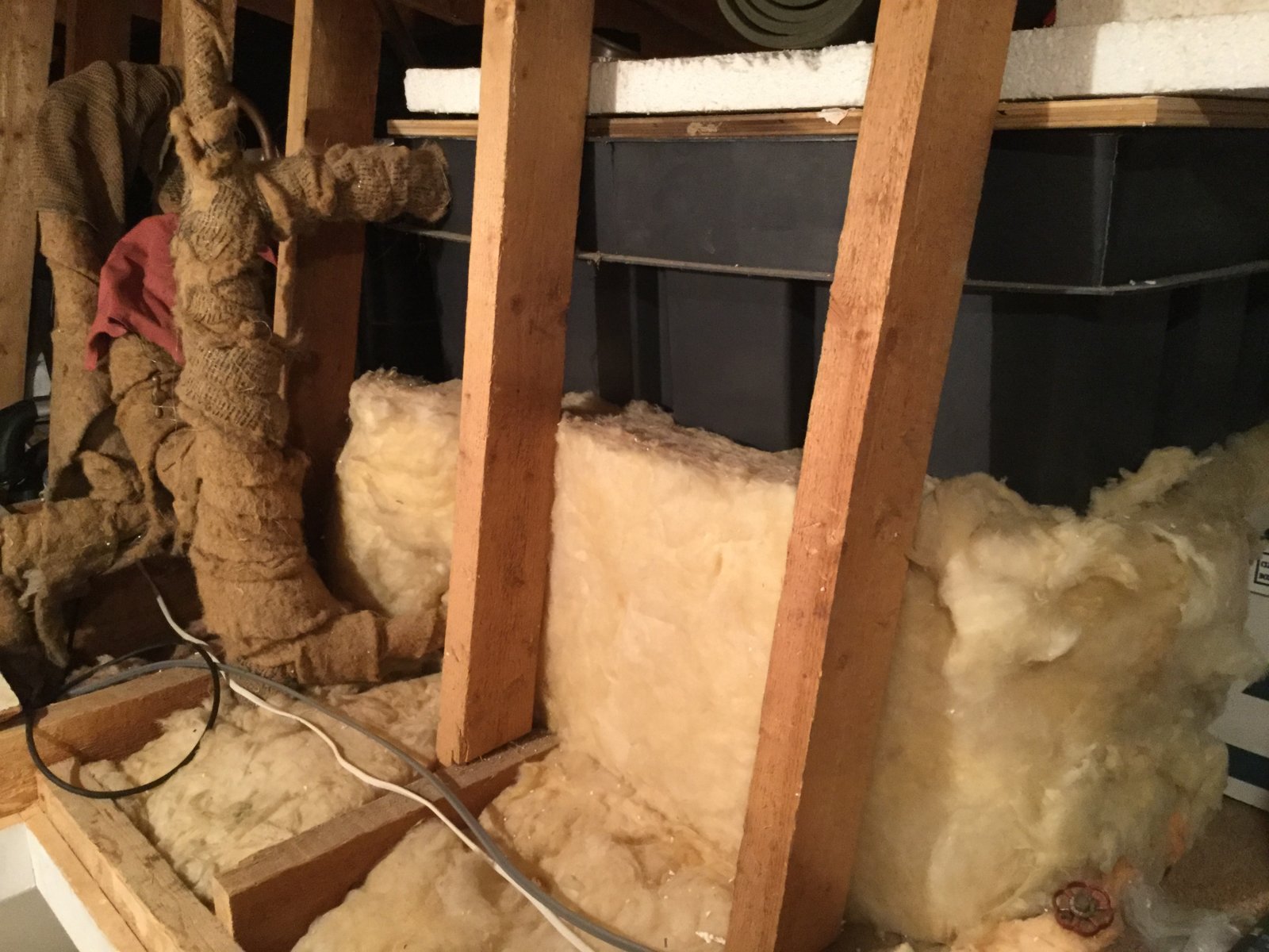

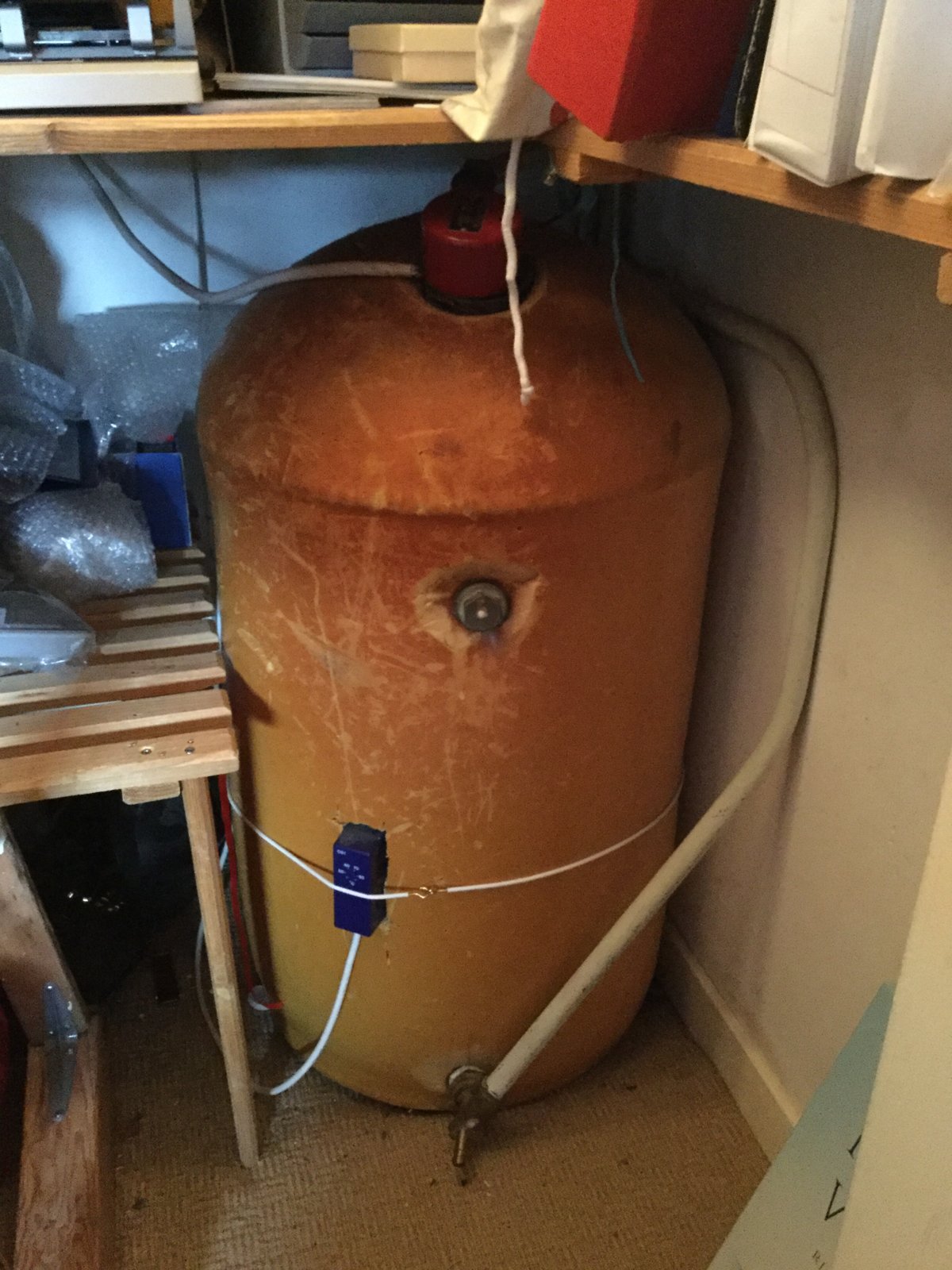

If the roof tanks are plastic they should be OK - look at " bylaw 30 kit " which would upgrade the insulation and cover the tank and make the overflow insect proof. If the hotwater tank is covered with spray on insulation it too should be fine - they tend to leak around the bottom - slowly so you'll see any water before it does damage- then change it. A picture of the roof tanks and the hot tank etc. And the size of your hatch would give a better idea;)

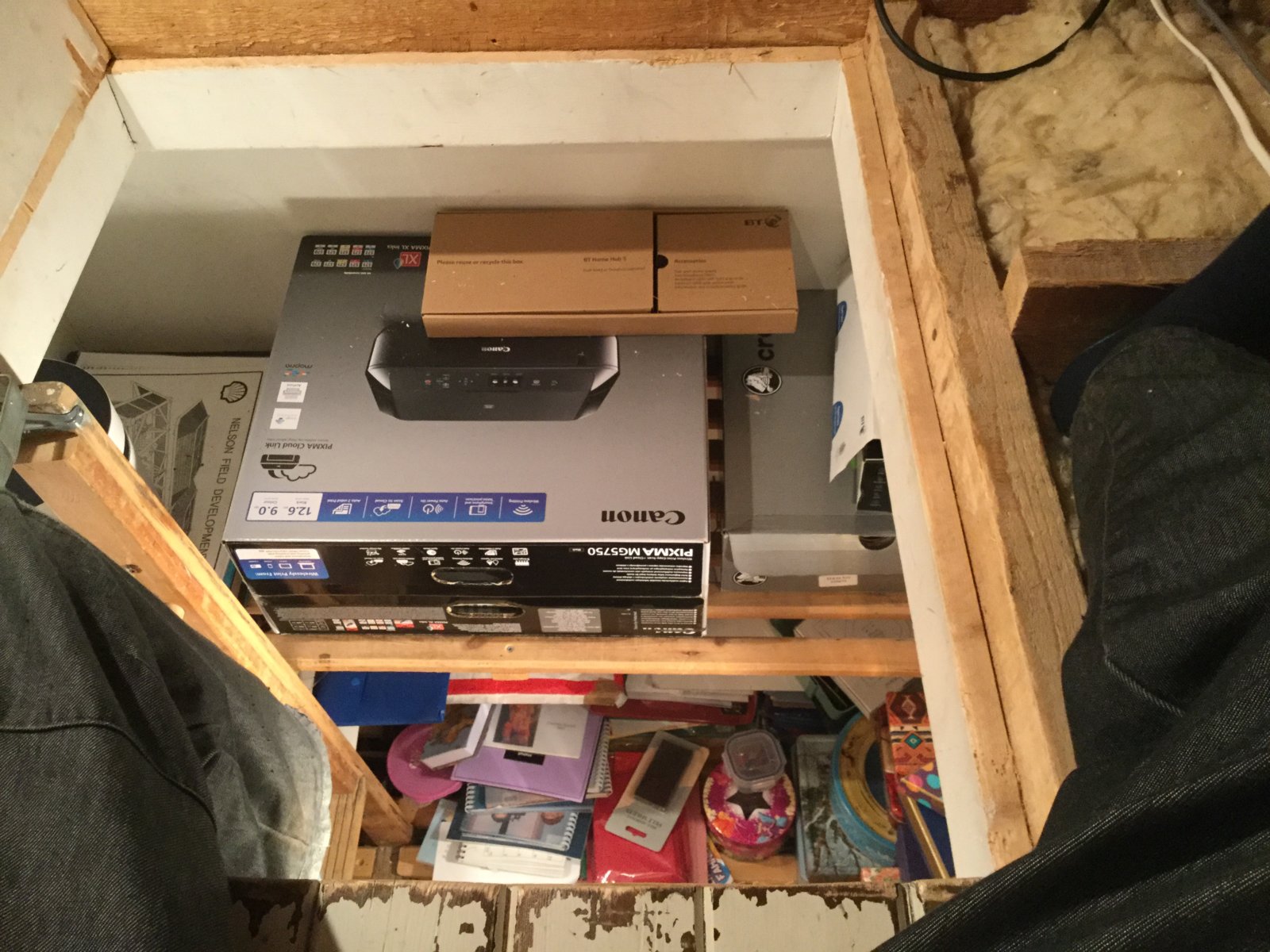

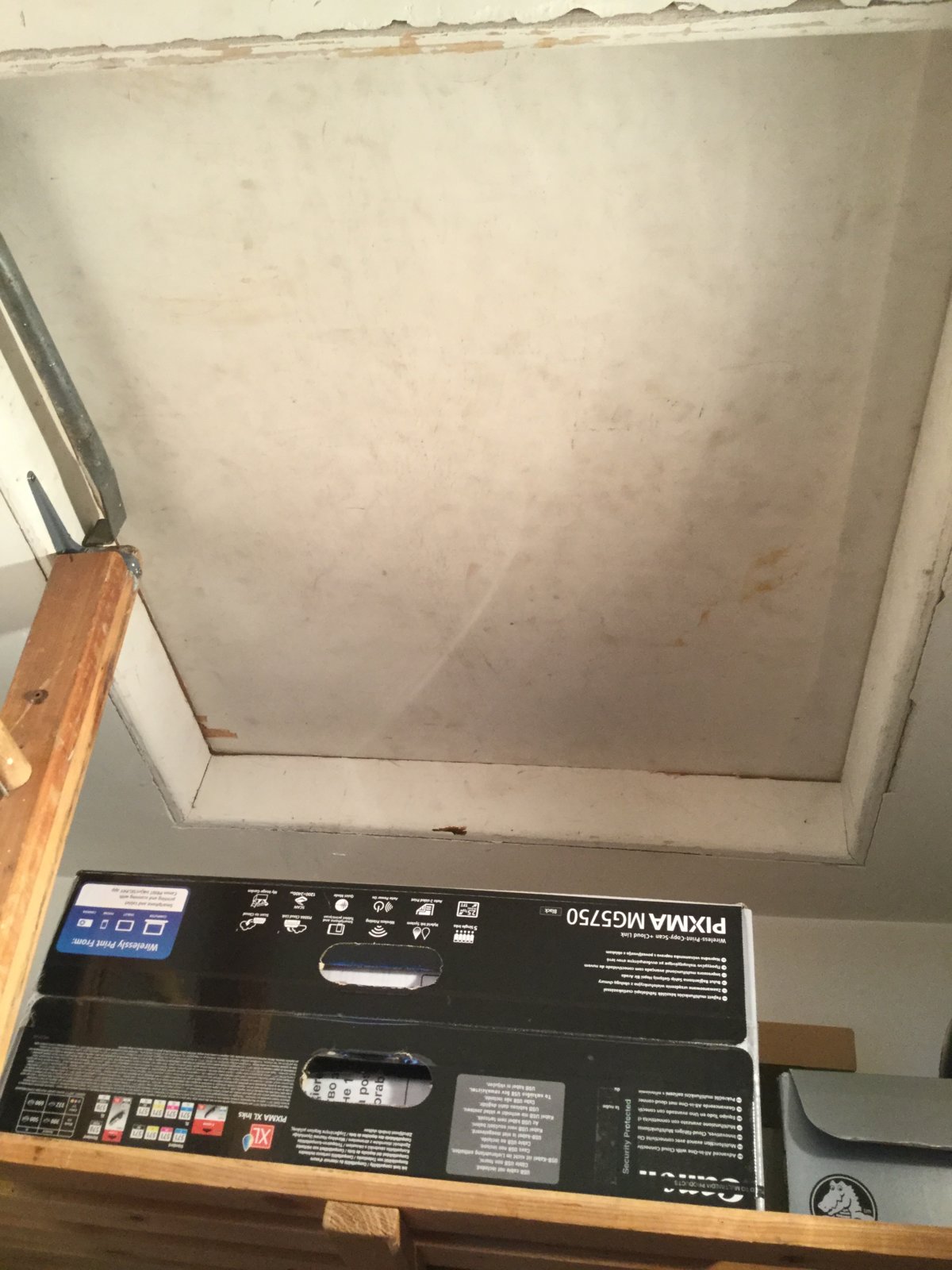

The hatch is 740x840, however I think the challenge would be getting a new tank past the roof trusses. Looked in more detail at the loft tanks, they are both looking fine, a bit of sagging in the sides on the CW, both are open topped and no insect kit as you would expect
