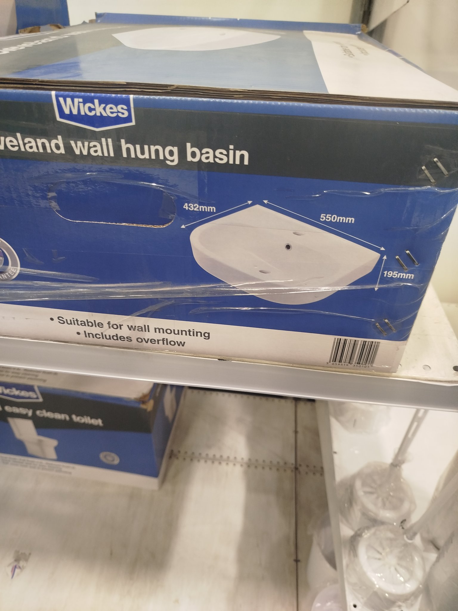

I have a basin that is 550mm wide, and as big as one that usually fits on a pedestal. However it says it's wall hung. It has small bolt holes probably only big enough for the smaller fisher fixing kit with plastic bolts. Any one fit something similar wall hung? Thanks

Are there fixings with it? Are there holes in it suitable for fixings?
It's marked up as it comes with suitable fixings - typical M10 screw bolt fixing with a 14mm wall plug, plastic shanked washers, penny washers and nuts - that should all be fine, if it's going into a solid wall or nice fat batons, anything else then it'll need special fixings.
It's got holes for bolts but there small holes imagine only would accept the small fisher bolts
This is the fixing instructions that come along with that basin, it's also marked that it comes with the required fixings which will normally be - M10 screw bolts, plastic shimmed washers, steel washers and nuts, as is normal for a wall hung basin

So the hole in the basin will be large enough to take the shanks of the plastic shims, which will be wide enough to support the basin, again as long as they are screwed into something solid. That and a little silicone laong the back will help when sealing to the wall.
Thanks just never fit one that heavy without a pedestal. It would be on a breeze block wall
