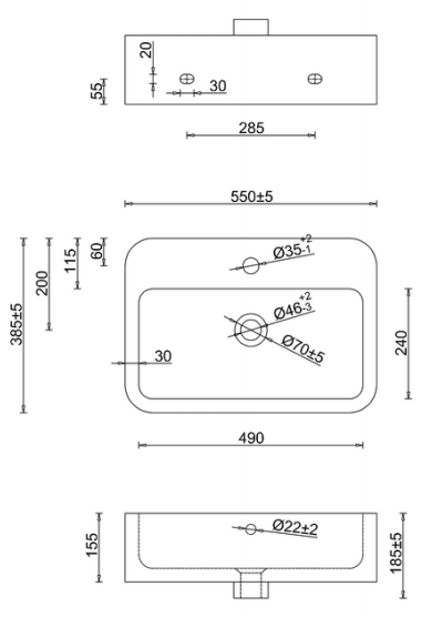

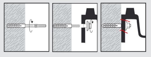

The wall will be rock solid as I'll be the one building it and it'll be stupidly over spec'd. Really my only concern is that the porcelain will fail at the loaded points if the basin was intended to have a pedestal to take some/most of the weight (see red lines drawn on the diagram below).
Since I'm building the wall, I guess I could bury some decent L brackets within the frame at key points (these would end up behind the tiles) and rest the basin on those. Only issue with that is that it makes the installation very specific to the basin I have bought (tricky to replace with a different model later on if I had to).

The Fischer fixings are definitely the ones to use.

Thanks. The holes in this basin are large and the recommended fixing kit is to use heavy duty bolts like the Fischer ones. This might indicate that the sink was intended to be used with or without a pedestal (a pedestal is available to match the sink). As for apron to hide waste, I don't believe it features this but does come with a rather spanky looking chrome bottle trap that must surely be intended to be on display.

I think the key here is where the holes in the basin are placed and the thickness of the ceramic as Burnerman mentions. Higher up towards the top of the basin then more ceramic to hold the weight, further down, which seems to be the norm on pedestal basins, less ceramic to hold the weight.
I think it's a suck it and see TBH :)
Good observation. If the bolt holes are at the bottom edge of the basin's rear face then the game's a bogey.

Diagram of basin below. If the first elevation is upside down then we're probably good as that means the bolt holes are approx 2/3 of the way up the rear face of the basin.It looks like it must be upside down as the drain connection gives the orientation.

Stopped by the bathroom shop on way home last night and took a look at the display basin. Mounting holes are towards top edge of rear of basin, ceramic is reasonably think (similar to other dedicated wall hung units in the shop), so it looks like a goer.

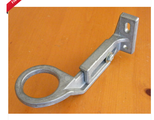

To be totally sure though, I picked up one of these on line:
Sits neatly hidden beneath basin and translates some of the downward force on the front of the basin into a rearward force against the wall behind the unit. Should really improve rigidity and overall strength of install. Chuffed.

Yup, given the holes are towards the top and have plenty of ceramic 'meat' around them and coupled with the support then it looks like it shouldn't have an issue.
