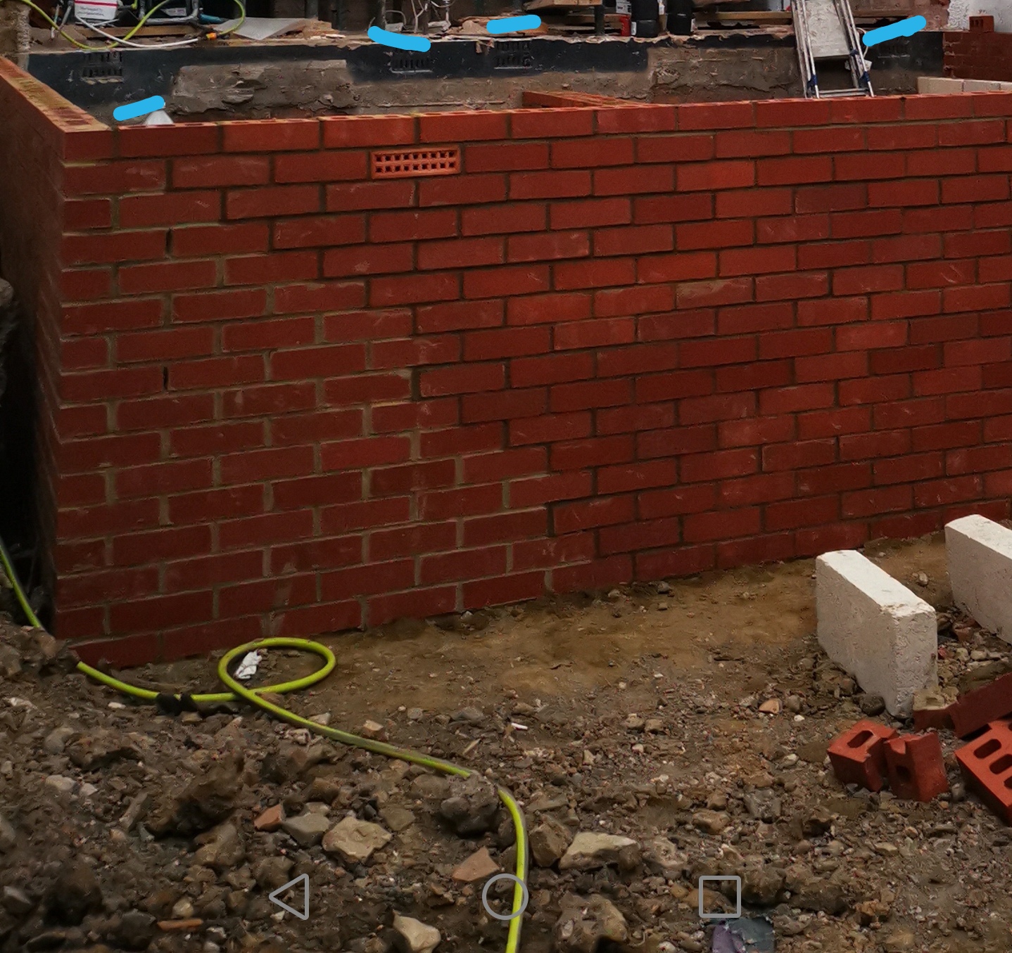

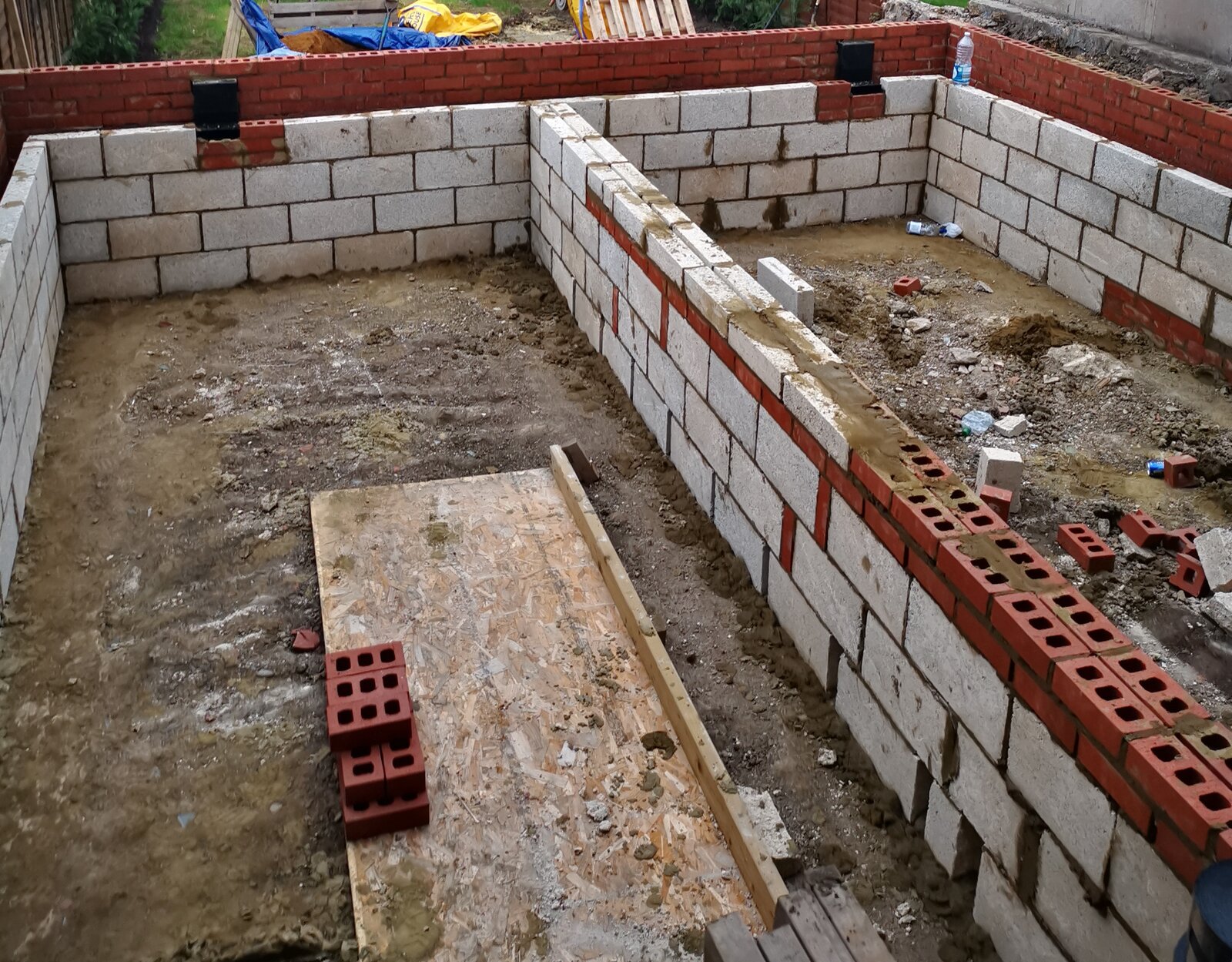

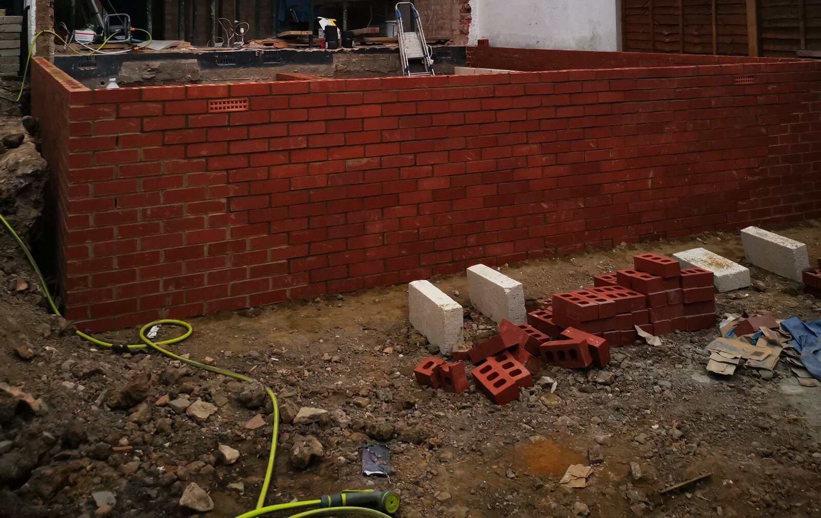

Hello all,
Thoughts on this please
Suspended floor with block and beam. 2 vents only at the front - is this sufficient?
Also a sleeper wall to support the beams mixed with engineering bricks and concrete blocks - thoughts?
Many thanks in advance for your input

Have asked their opinion of course but thought I'd get some input from here too. Any thoughts about mixing concrete blocks with engineering bricks for the sleeper wall & perimeter supporting walls too?
Mixing is no problem at all, saves cutting the blocks down.
Air bricks seems a bit light, but as long as the free area is enough, it would be ok.
There isn't any timber there so it should be less critical.

I'm curious to see what the builders will do about the vents from the existing house - I'm not if you can see it just in the back of the house. There's 4 air brick openings. Would there need to be a channel that feeds into each of the dead spaces unde the blo K and beam. Each area is 2.4x5.7m. Im not an expert of course but one air block vent seems to very light intuitively. Thoughts?
I've made attached the pic to show it clearer

The block and beam have been lowered to ensure there is enough space for insulation and screeding etc to make the floor level flush with the existing house. Concrete t beams are 3m hence the need for a sleeper wall to stagger the beams to cover the approx 5.5m span of the house

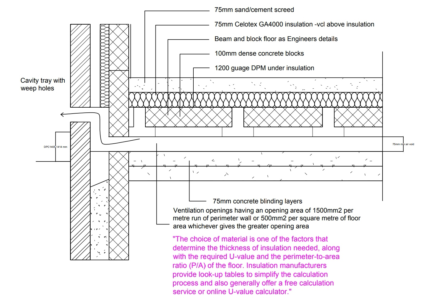

I'm thinking to do the flush patio also as a suspended floor with a block and beam so it makes sense to think about your suggestion with the storage at the front of the patio for that segment of void (the void under the extension will go to waste I guess - the side will be a flush walkway too) . The vents are going to get covered it seems so will need to ask them to think how they will channel the whole thing from existing through 6m ex + 3m patio.
This is block and beam spec attached for our project. Any suggestions or would anyone do anything differently.
