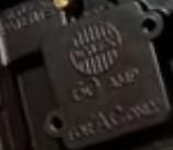

I also noted wylex (Crabtree and Volex) don’t make 45A Mcbs

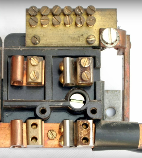

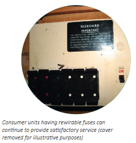

Wylex fuse box first fuse some times can be over 30/32 amp Wylex heavy duty.jpg some had a reinforced first fuse, but whole unit only 60 amp Wylex 60 amp.jpg and although you can fit RCD protection as I did here Wilex-board-with-RCD.jpg in real terms today it would cost more than a new consumer unit to do, I only did that as at the time consumer units with built in RCD's were not made. I have items in my house which the manufacturer says should be RCD protected, I think most houses will with some item stipulate RCD protection, plus the problems using any plastic water pipes without RCD protection and fitting the earth bonds, the electrical safety council may say the old Wylex box can still be used fuse-box-1.jpg but in real terms we all know it has reached end of life.
