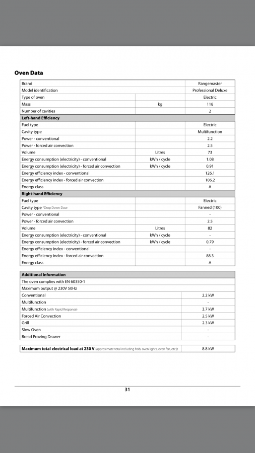

Hi I have bought a rangemaster dual fuel oven which max load is 8.8kw. Think this is when everything is on at once. The instructions say 10mm max but I have a 6mm cable. Will the 6mm cable be ok ?

Anyway - 8.8kW. Even if we assume that's at 230V, that's 18.5A after diversity.
6mm² ought to be fine, but I guess due diligence on checking the rating of the protective device should be done....
10mm² is commonly used as a sub-main for a whole flat to supply everything.
8.8kW @ 240V is 37A - after diversity this is 18.1A so clearly 10mm² is overkill no matter what the manufacturer states.
we need more information, but it's possible that this is a dual-fuel cooker. It might, for example, have a 2.5kW big oven and a 1.3kW little oven, and it might have four or five gas rings with an output totalling, let's say, 5kW
That's one way it could reach 8.8kW, but it would not all be electricity.
My dual-fuel cooker is somewhat like that. I have an idea the max electrical load (undiversified) is about 20A
This is only a guess. If it turns out not to be dual fuel, it will be very different.

The specification you have posted indicates that the total 8.8kW electrical load includes hob. If you don't have an electric hob, then the figure will obviously be much less.
Are there just the two ~2.5kW ovens?

Two ovens and a separate grill. Why would they include the gas burner in the electrical bit ? Very misleading of RAngemaster. So a 6mm cable is fine then John ?

On reflection, I think that they have just perpetrated a typo, and should not have written 'including hob'. The 8.8kW looks as if it is probably the sum of "Multifunction", "Forced Air Convection" (presumably the two ovens?) and "Grill", which comes to 8.5kW, plus a (somewhat generous!) bit for lights and fan(s).
Indeed, as has been said, that should be fine, and 10mm² would be rather OTT.

I think that's a mistake, an earlier manual revision maybe, it doesn't say that here...
https://www.manualslib.com/manual/7...onal-Deluxe-100-Dual-Fuel.html?page=34#manual
It says...
3.7kW Main Oven
2.5kW 2nd Oven
2.3kW Grill
Maximum total electrical load at 230 V (approximate total including oven lights, oven fan, etc.): 8.8 kW
So, 8.5kW. I don't quite see how two fans, 1 or 2 15w lamps and the LED display make up the other 0.3kW though!
