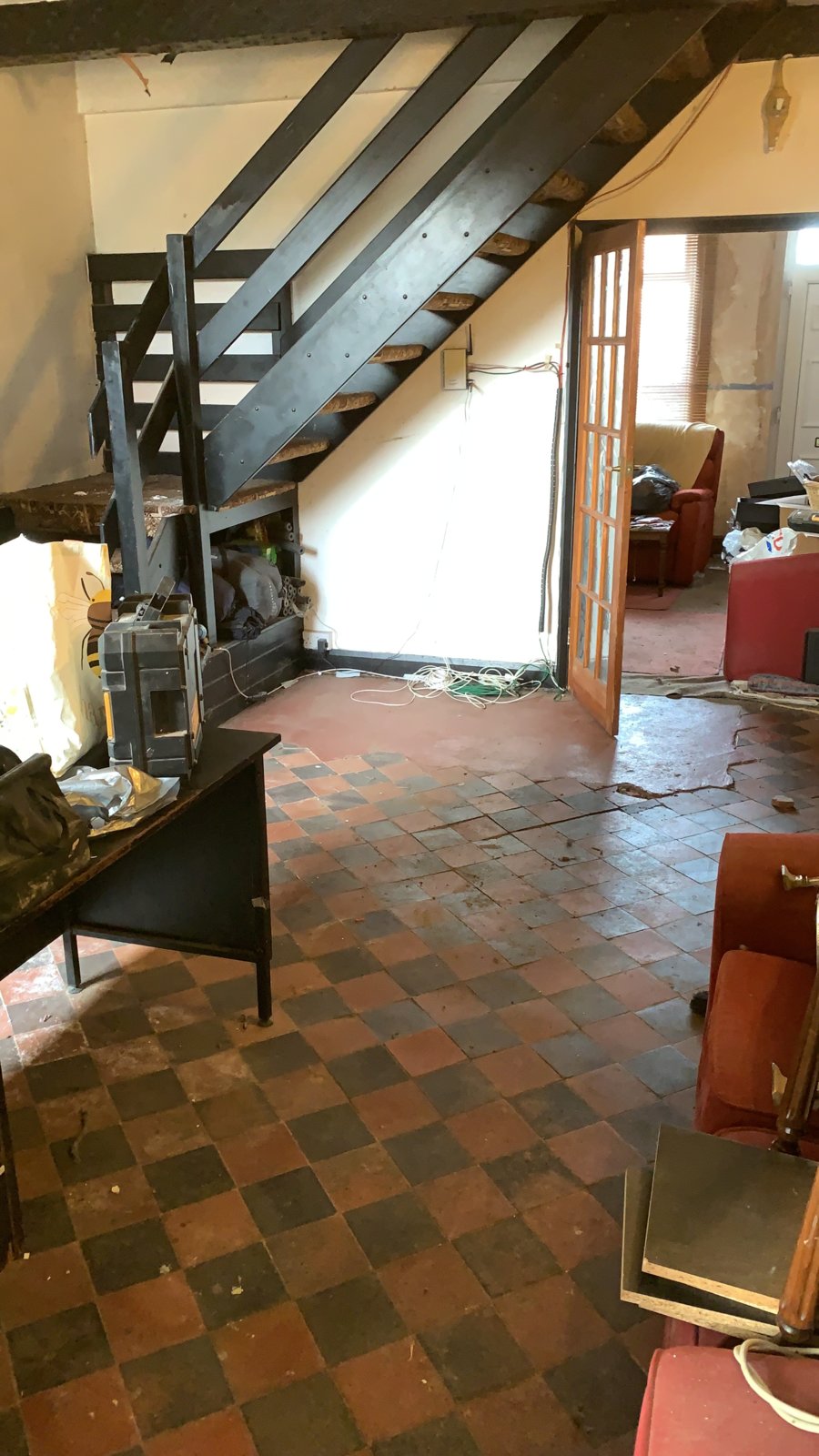

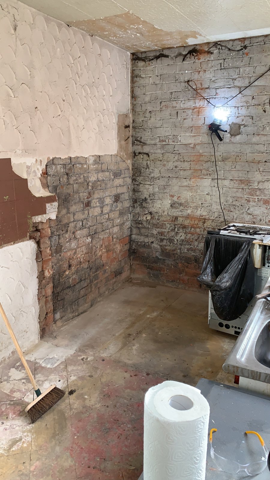

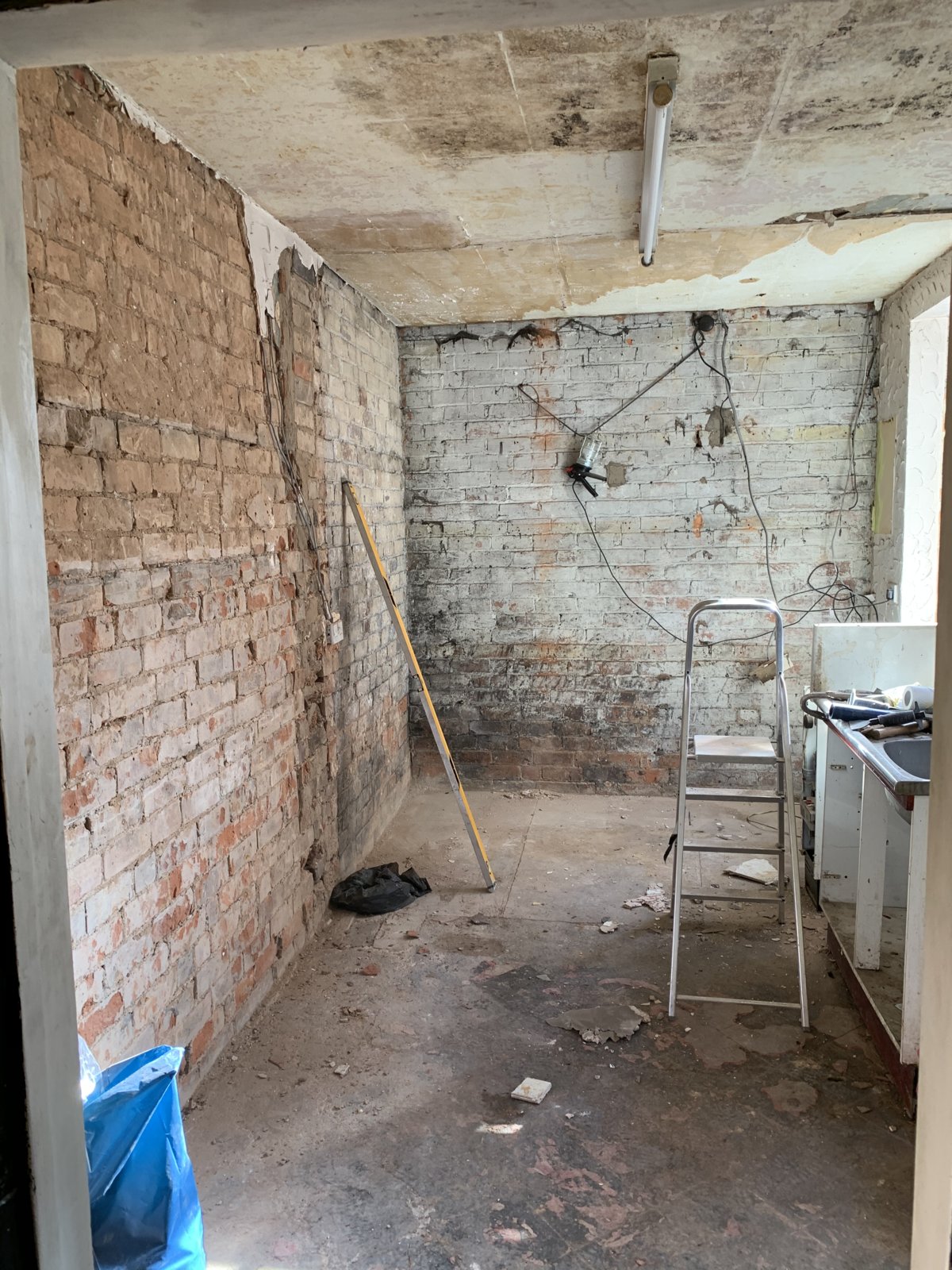

157E83B7-7EDB-411F-9082-84A581591813.jpeg E190A9C2-705C-4225-815B-9A4BA17F94DA.jpeg 047A45AE-2369-44AD-B01F-3FF91F97999D.jpeg
here are the pics of the kitchen with multiple substrates to go over and the reception room that it flowed into (not having a door) with approx 20mm thick tiles and areas of solid painted concrete.
Note there is salt coming through in some areas (under the desk mainly) but the previous guy who quoted said that wasn’t an issue.
To be honest mate I wouldn’t risk doing it.
That needs a dig up and new sub floor
Maybe get a Ashpalt base at 20mm
buy if you go down the screeding compound way then I’d use ardex over Fball.
So grind off / scrape anything loose
Clean clean and clean with de greaser so no contamination
Then a coat of ardex NA to get the basic levels and smooth
Then ardex DPM1c
Prime with ardex P4
Fit UFH matting
2 coats of ardex NA needed then at approx 4-5mm each coat
Then LVT flooring. I always recommend moduleo or quickstep Livyn dryback.

seriously?! :eek: There’s no chance that digging up the floor is happening. From everything I’ve read today the fball and Ardex stuff are designed for situations like mine. There’s no damp in the floor.

No, but again (excuse my niaivety) isn’t that was the 1200 pro is for, to apply to damp floors? According to the wording on fballs website it is.
Stopgap 1200 Pro. ... Stopgap 1200 is suitable for application over damp, clean, uneven concrete and sand/cement screeds, prior to application of Stopgap waterproof surface membranes or Stopgap Isolator Membrane.
Yes it can go over a damp floor. If it’s solid. But the tiles might come loose in the future.
You can’t put a smoothing compound over any contamination so make sure it’s clean.
Thanks for confirming. The only tiles left are small remnants that just won’t budge, so I’d imagine they’ll never come loose.
I’ll brush, mop and vacuum the floor prior to applying either the stopgap 1200 pro or Ardex NA. Those 2 seem to be the most popular choice for my project.
