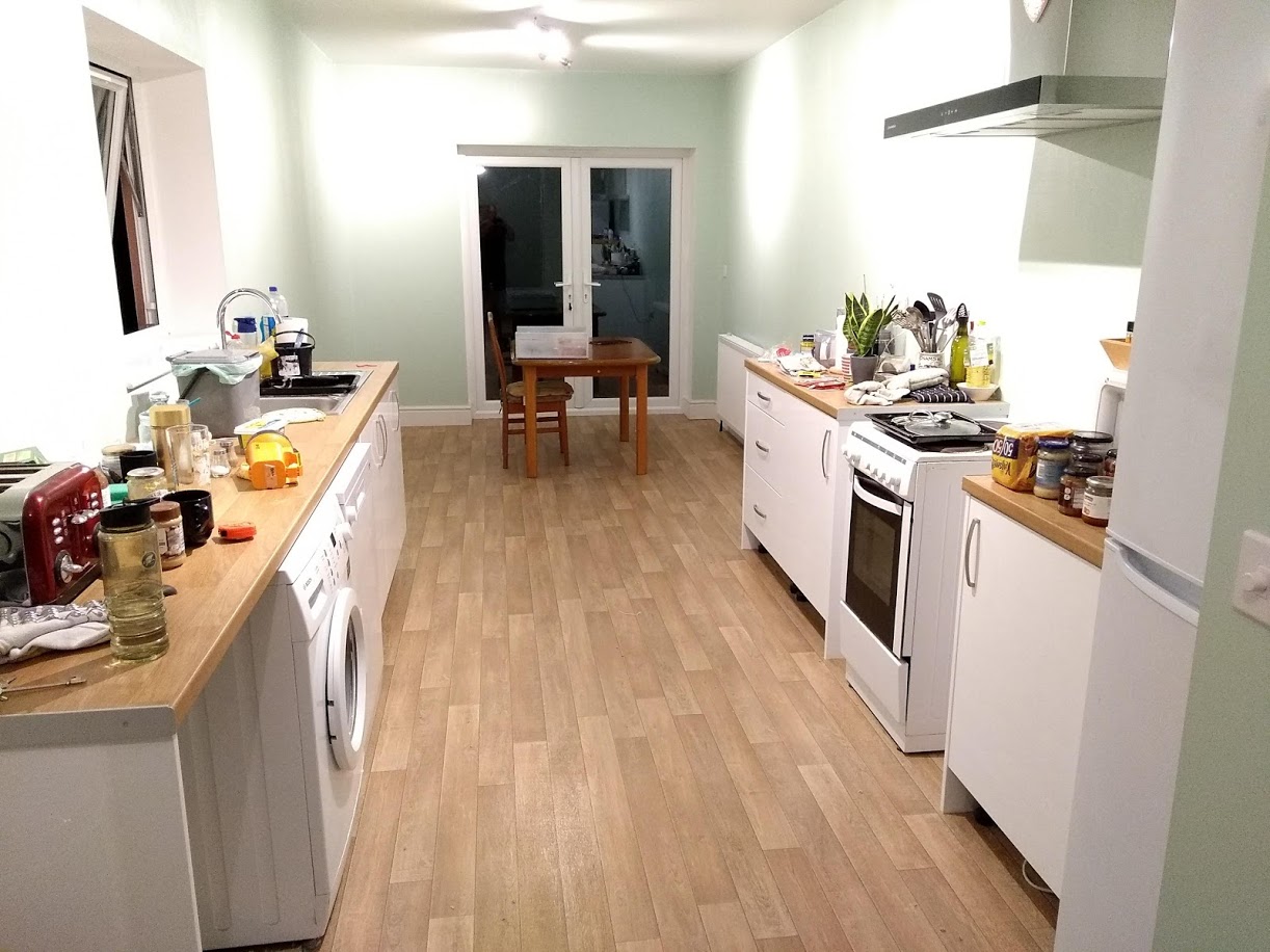

I had a new kitchen built this year. Not sure what the actual cost was, but units and sink was about £1600, fitting around £600, worktops £150, extractor hood £130. I kept all same white goods. Electrics probably about £750 (had heat detector too), plumber, not sure as also did other new rooms, but maybe £1000 for the gas and water (I had new radiator too). A plasterer quoted £650 for a bedroom, I ended up paying about £800 for that ... probably similar for kitchen, flooring, maybe £1500 for tiles? (I had cheap vinyl for £500). This is a 7m by 2.7m kitchen. £1000 for oven and hob and unit? So about £7500 so far. But that does not include stripping out old (a days work for a couple of guys, £300). Skip another £200. So... about £8500?

My kitchen ... more in there now - have large corner unit, tall display cabinet and a small corner unit there now, and will put in a range cooker when I find some more money. So, if you are planning to move, think about fewer fitted units and more free standing cabinets etc. Free standing cooker may be a better option too, although you need to remember the £100ish cost of disconnecting it again.
Is there some more kitchen behind you, as that seems like a hell of a lot for 3 units and an end panel.
5 units, sink and tap, 5 end panels. We didn't get the cheapest, about range 2 i think. Drawer unit and sink added a fair bit i think.
