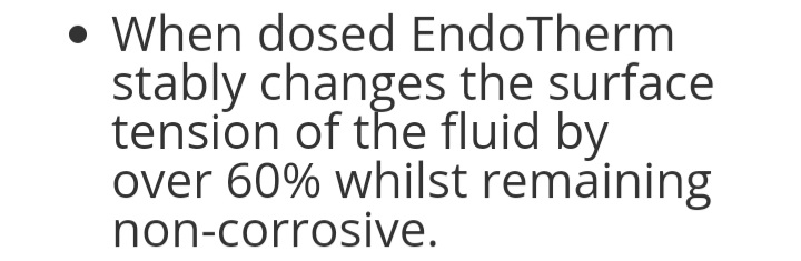

I can not find any constants relating to this claim:
What temperature is the water?
Is the surface tension calculated at a water/air boundary, or water/solid boundary?
What does a 60% "Change" mean? (Presumably reduction!)
For example, the surface tension of water (at an air/water boundary) can be reduced by 10% simply by raising its temperature from 20 to 60°C (i.e. by turning the C/H on)
www.engineeringtoolbox.com
...and a greater than 65% reduction in surface tension from 0.073 to 0.025N/m (at an air/water boundary at 20°C) can be gained by making the water soapy (adding a simple surfactant).

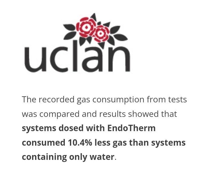

Their website has a case study section detailing case studies and highlighting the effectiveness of the product.
And I am not disputing these.
However, all the tests listed in the independent testing section seem to make the claims of a 15% energy reduction, based on a comparison with a system using water only (no inhibitor), for example:
The endotherm product is not an inhibitor. An inhibitor will need to be used in addition to it. And as I mentioned in the now deleted thread - the MSDS for Sentinel X100, lists nitrilotriethanol (a surfactant) as a constituent
To conclude, why can't we have some scientifically rigourous comparisons with properly inhibited systems, so we can judge for ourselves whether a product with EDIT (misspelt) Glucoside as the only listed chemical on the MSDS, and costing £30-£70! Per 500ml -

There was a recent thread on here questioning the efficacy of a central heating additive called EndoTherm; that according to their website:
It works by:EndoTherm is a unique, multi-award winning energy saving additive independently proven to save up to 15% on space heating energy consumption.
- Due to the surface tension of fluid and imperfections in materials inside heating systems optimal thermal contact is not made.
- When dosed EndoTherm stably changes the surface tension of the fluid by over 60% whilst remaining non-corrosive.
- This increases the thermal contact which improves heat transfer rate and efficiency.
Surface Tension - Water in contact with Air
Surface tension of water in contact with air for temperatures ranging 0 to 100 degC (32 to 212 degF) - in imperial units (BG units) and SI units.
