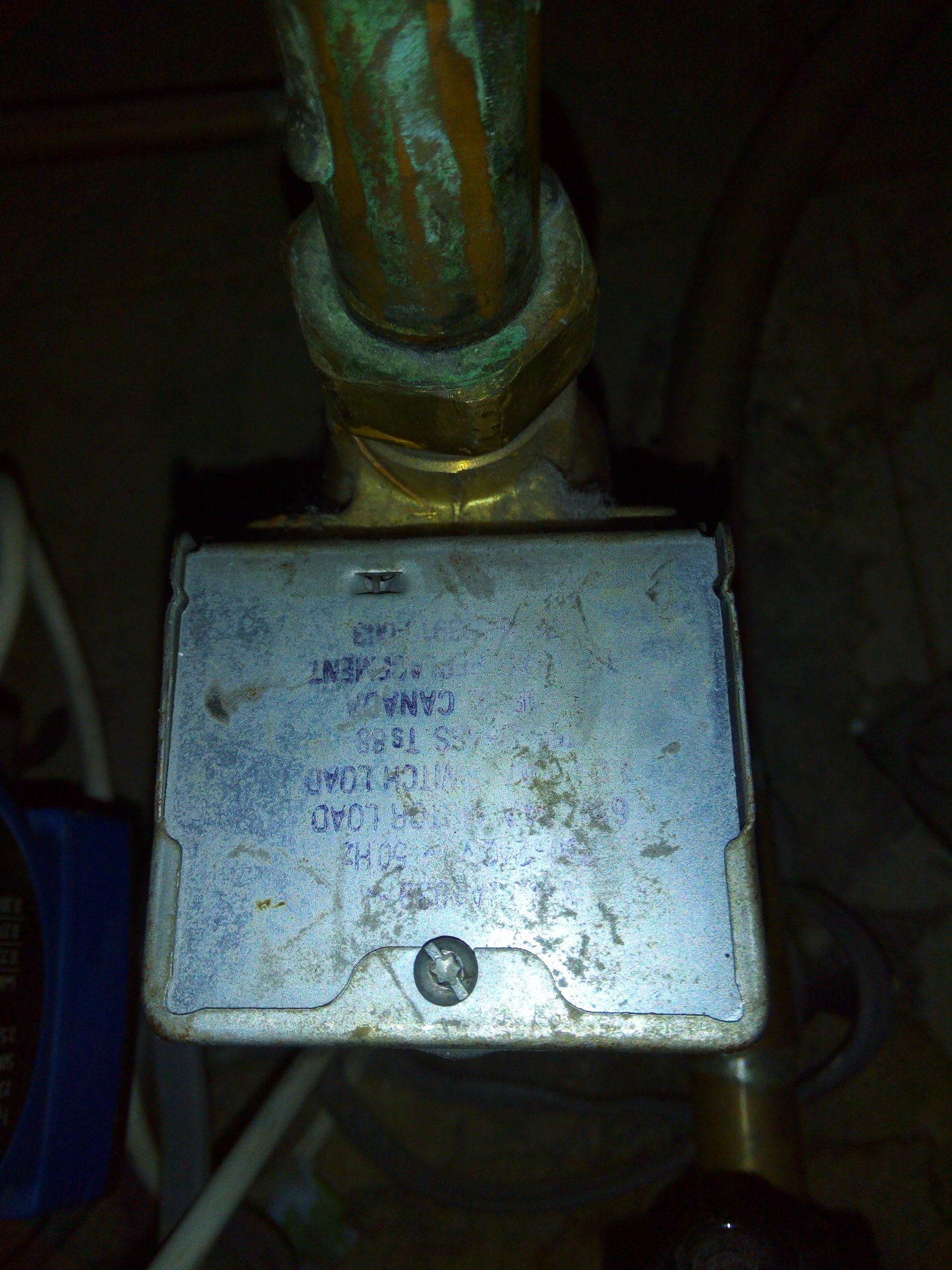

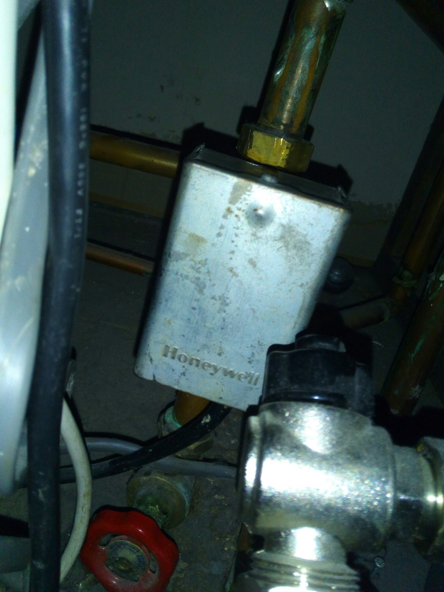

Photo's are always useful. ;)
If CH is working ok, then the problem lies with water not getting around the HW circuit. When moving 3 way valve to manual, do you find resistance, and/or hear the workings 'whirr'? (Make/model of valve can be handy, some are more troublesome than others.) Try running system on HW only, what happens? Switching heating off with HW on and calling then you should see or hear valve operating to close off the heating port and put flow through to HW.

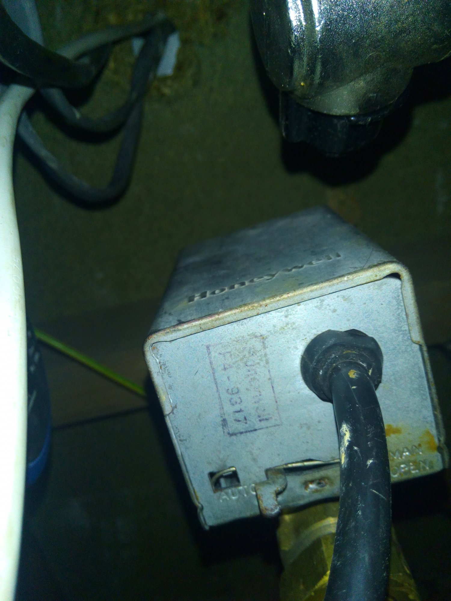

I'm an absolute noob with these systems; I'll get some photos. It's a Honeywell diverter valve - can't get in to see the model - but it must be 20yrs old. There was some resistance felt when moving to manual - with everything switched off I could hear the mechanism moving ('whirring') as I moved the switch.
The last pic might show the arm back at 'auto' - it's currently on 'manual' though.

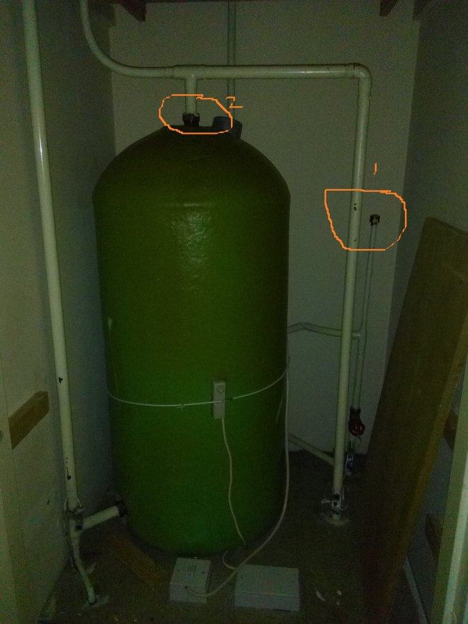

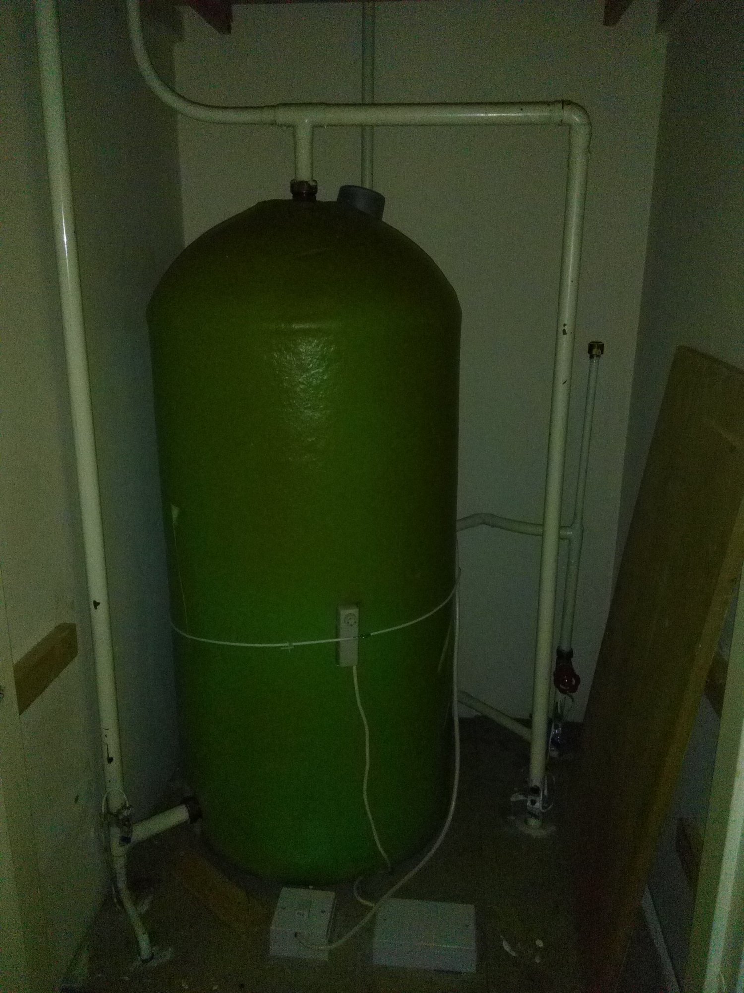

The balancing valve - now you've got me - is that in the airing cupboard too? Ditto the HW coil circuit - I can't identify which one that is. Pic of a/cupboard:

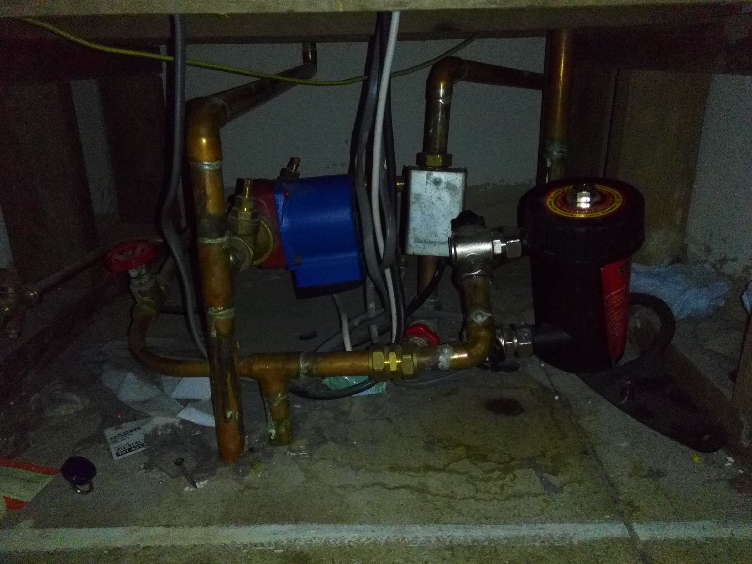

and under the tank:

Honeywell usually good valve. but at that age, possible its faulty. However, opening it to manual and I'd expect both HW and CH to operate, albeit with no thermostatic control other than the boiler stat. However, current symptoms do seem to suggest valve has stuck open to CH.
Cylinder stat is at correct setting by sound of it, look at the 2 pipes that connect to the side of the cylinder, on the R/H side in your picture, one about half way up, the other directly below, near the bottom. Is that gate valve open? (Not sure why its there by hey ho...) Secondly, the bleed on the top of the 15mm pipe sticking up. With system off, open it gently, do you get water from it?

The gate valve on the R/H side was half-open, I've opened it fully - what does it do? (just out of curiosity)
Re the bleed - do you mean on that random pipe (1) or off the top of the cylinder (2)?
1 is the air bleed, this will vent any air collected from the coil inside the cylinder. If this pipework is full of water then point to valve being suspect.
2 is the outlet for the domestic hot water, it enters the tank on the L/H side at the bottom, supplied from storage cistern in the loft, and goes from the top, pipe going to the left will be the vent over the cistern, and to the right to supply hot taps. This is completely separate from the CH water (that should be!) circulating through the coil inside the cylinder.
