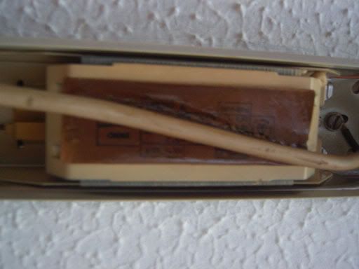

When wiring flu's, don't do this:
The routing and type of cable is obviously wrong, But also, it was two core flex...

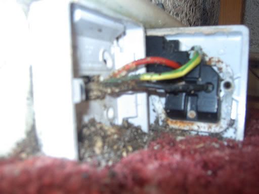

And watch your property for damp:
When I removed the socket, several live woodlice crawled out...
Forgive my autofocus, which is playing up a lot lately...
that backbox looks like its half hanging off too!
the mice that come out of alarm panels are the best ones :)
