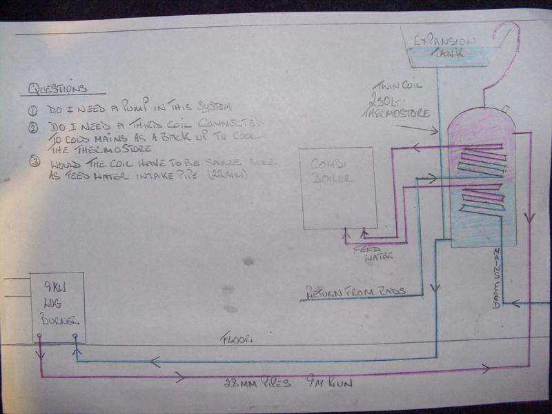

My apologies if this has been covered before I have had a look and can not see anything similar, I would like to change my existing log burner for a log burner with a back boiler, however i don't want to connect this to the radiators and the hot water directly, I would like to build a system that is independent of the existing heating system which is a modern gas fired combo system and leave it a alone, simply all I want to do it to give the mains feed water and the radiator return water a leg up back into the combo, I have included a simply basic drawing for what I would like to do.
I can't run the pipes up and over from the back boiler to the thermostore so they have to go under the floor to the other side of the house 9m away where the thermostore is 1.5m above the boiler, do I need a pump in this system
Can your combination boiler accept pre heated water?
Like about 90c maybe.

If you don't have a gravity circuit how is the heat going to leave the back boiler when there is no electricity?

I agree, but there are other ways to move water without electricity, but apart from that minor issue would you agree to the rest of the system in principle
When that store is boiling at 100° C then where is the heat from the wood stove going to go to?
We don't know the output of your stove to the water but suppose it is 5 kW then it will heat up a 250 litre store pretty soon!
