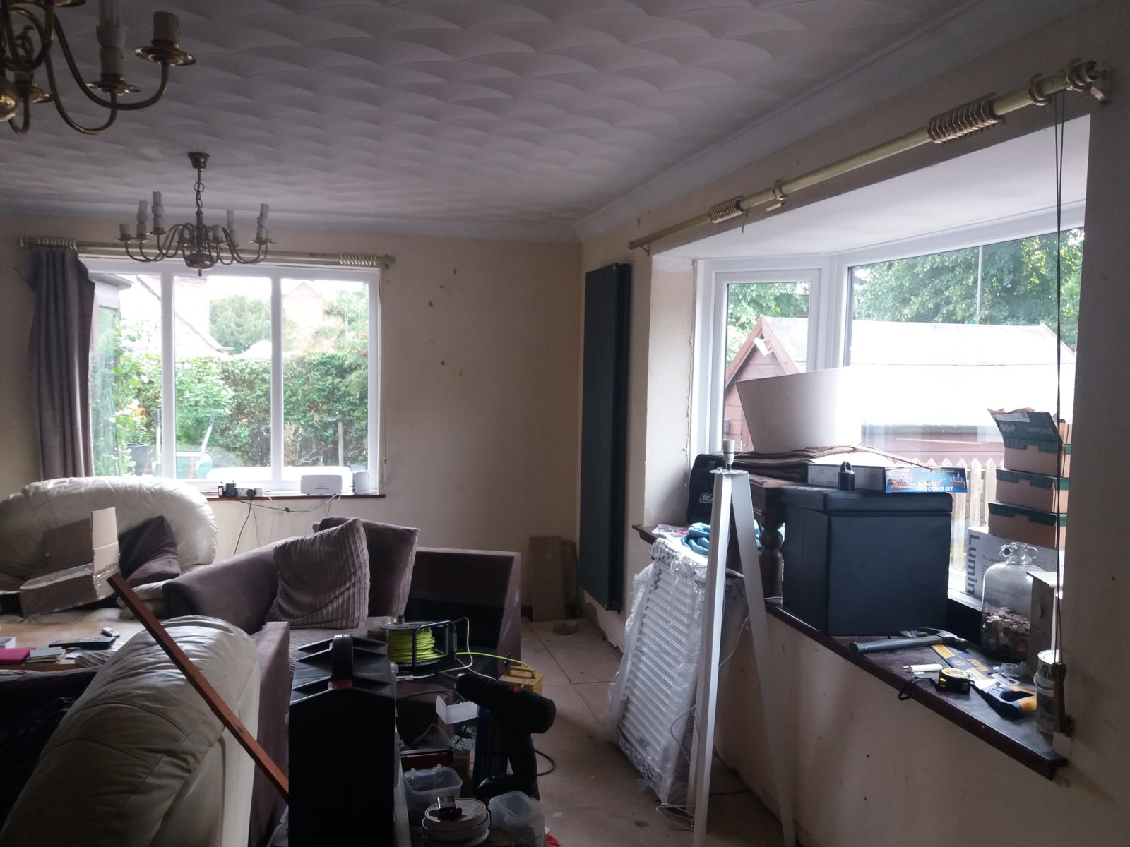

Hello all.
Ok, been struggling with this for a good few weeks now. I've read so much stuff about this, but there is such a lot of conflicting advice I'm hoping you guys can put this to bed for me.
I've got 2 windows in my lounge (pic below) that I'm trying to decide how to alarm.
The easiest way would be to fit a pir but due to us having a dog in the near future it seems even the pet friendly dual techs aren't really recommended.
Now if we fit shock sensors, as there is 6 panels it will end up costing quite a lot and there will be a fair amount of wires to then run to each panel. If this is the best way to do it, well so be it I guess that will have to be the way it's done.
So other options..... with a glass break sensor mounted above each window, or possibly on the roof between the 2 windows. But are they any good? If they are, is there a good make of one I should buy?
Otherwise, what about beam sensors? Couldn't find much info online about them.
Thanks as always everyone, I'm sorry if this is a bit of a boring topic. Lol.
Alex

I am not a fan of pet friendly detectors, mainly because they mainly be cutting out detection below a certain level around 4ft mark, kids and vertically challenged or crawlers wont necessarily activate the alarm.
Glass breaks rely on a thump then the glass breaking for it to activate, so not a big fan of these either, given some of the breakins I have seen there was no thump before the glass was broken.
The question comes to where your pet is going to roam when the alarm is set during the day and on a night.
As for shock sensors, the new wireless Texecom Micro shocks are fantastic and could be stuck to the frame, or inside the window frame, but these wouldn't be as cheap hard wired shocks, but they aren't as bulky either.
On the bay window you may need more than one shock, the other window you may get away with just one., centrally placed along the top, but its hard to be certain without checking as part of a site survey, sensitivity of the shocks can be adjusted.
You don't state what alarm you have already if any and have asked about one room only which seems strange as bedsits are usually 1 room and houses multipul rooms?

always better to hardwire rather than wireless if you can, you have good brand cable wise so that's one less thing to worry about.
My entry level panel is the 48 metal or 64W for installs, this gives more flexibility.
The biggest issue with wireless systems is radio jamming and during a jam the wireless devices are defunct, but its not quite as straight forward as that, as its possible during radio jamming that some wireless devices will work, if they fit into a slot where the jamming doesn't coincide with a signal from the device.
Hybrid systems is a good compromise, in you can protect the home with hardwired devices where its easy to do so and wireless for those harder to reach places.
I know a few people swear by certain pet wise detectors as being good, bosch tritech and more recently Orisec petwise detector I have had on test in a property has proven to be okay but they don't sell to GP, but again the customer has it in a place where the petwise sensor is compromised by kitchen units where the cats love to jump up on. but the rest of the house is on AMQD's and the cats don't activate the sensors at all because the sensors don't face curtains or places where they will get above the activation height. so if a sofa is near the wall the pir is facing away from, the cats in many cases can jump up on the sofa and not be detected, if you look at pir coverage patterns it may make more sense to you.
Now for the biggest shock of all, if the dog is a small bread, ie doesn't get much bigger than the average domestic cat, normal PIR's can be used with relatively reliably, what you do have to be aware of is the size of the animal and whether it will jump or climb onto surfaces.
So a petwise sensor facing the stairs a cat would be picked up around when it gets above a certain step usually around 1.2M high on a normal detector its much lower than this, however you can adjust the height of many sensors to increase this distance a little.
without knowing the type of dog, and a full survey I would look at perimeter shocks wireless (just wired shocks on windows can look messy plus invalidate warranties if screwed into new frames and normal PIR sensors in the rooms, and look at possibly manually masking the lens or look at Pet wise sensors at the most at risk areas for the pet to activate the alarm.
I guess this is what you pay an alarm engineer for to work out best placement and devices, rather than second guess whats appropriate.
CAUTION: if using shock sensors on the perimeter and no pir coverage every door and window needs to be covered as no device on a window or door means once there are in the property they wont activate the alarm!!!!

Ok, so the texecom 48 will be on the list, it's hardly much extra so as you say, could make expansion easier later on. :)
The dog we don't have yet, but will be a Labrador (it needs a home having not quite passed it's exams) and we will give it free run of the downstairs. Now the trouble with labs is they like a good feed so they can get to being quite chunky. Also as you can see from the bay window, despite trying to discourage it, I will bet someone walking up the drive or a knock at the door will have it on its hind legs up at the bay window sill barking. So again, sadly, I think any PIRs are out.
Every door will have door contacts on, wired is dead easy as the floorboards are up in most places so I can run the cables to them and mount the contacts at the bottom of the doors neatly and keep the cable on site to an absolute minimum.
As for the windows, I am prepared if you think it's worth it, to channel conduit into the walls up to the windows to run wires. IF you think it's worth it. If not, wireless is fine. The window sills on both windows and in the kitchen will be coming out and replaced, so I could spend some time hiding the cable if again you think wired is better than wireless.
As for the alarm engineer...... whilst I appreciate exactly what you're saying, if I'm brutally honest, I don't trust 'tradesmen'. I appreciate on here there seems to be some really good guys and gals who clearly are worthy of the title trades people, but this house we bought in October of last year looks like the worst DIY house ever...... and as I have nearly every receipt for everything the previous owner had done (retired reverend - now passed away) and I have spoken to our lovely neighbours we knkw that he has done absokuteky nothing himself. Everything in this house has been done by trades people. And they have ripped him off. It's embarrassing in fact.
I go the gym with a lot of trades people too.... and i'd say 50% of em can barely the their shoe laces. Haha.
Also whilst it would be nice to have an installer come and do it, i love the research into projects, and I love the sense of satisfaction you get when you finish it yourself. I used to build cars for a living, I think I'm just one of those hands on sorts :)
Your in a great position to rip channels in walls, that's your choice.
With the likes of the ricochet wireless micro shocks/contacts you can stick them on or inside the frames, I have my office window and doors with them on and you cant see them at all, the wireless shocks are easier to adjust than there hard wired equivalents. There is a guideline in the manual for the type of fitting and the sensitivity selection is brilliant. I recommend them to all my customers, if the windows and doors are new, they can be stuck on securely with the double sided sticky that's provided, if you later want to screw them on then its easier enough. The hard wired units are so bulk in comparison and have to be screwed on to get best results.
Maybe price it up and look at the dimensions of the devices and make your decision, hardwired is always considered better than wireless, for a start no batteries to replace, but hardwired devices haven't really changed much is shape or design, 8 core cable is probably thicker than the micro contacts.

Ok, I shall have a read of the wireless ricochet sensors. How many would you suggest I need for those windows? The bay window is made up of 2 opening ones (the smaller ones on the angle) and the large fixed one in the middle. The other window is 3 fixed panels as you can see.
I'm presuming a shock/contact sensor on the 2 openers, and a shock sensor on the big fixed pane.
Then one shock sensor in the middle pane of the other window? Is that right?

in general it depends on how much the vibration travels along the frame, old sash windows vibration travels well usually and they rattle in the wind, so have to dumb down the sensitivity to stop false alarms.
The advantage of wireless, is you could test and see what you get and more without worrying about running new cables.
so I would go around thumping windows with the bottom of my fist to see how much the vibration travels, this is a guide only mind.
That's where I would look at starting, you would be surprised how the vibrations travel on the large windows.
We had a window taken out that was fitted by a well known national firm and it appeared to be fixed in with the bare minimum of fixings, the lad that replaced the window put in very long screws and way more than double that was in the original window from what I remember, the window frame was also slightly bigger than the original no air gaps as such, I am guessing he measured it tighter than the national firm did, who used cladding to cover the somewhat large gaps between frame and wall. this window doesn't carry vibration as well as the one it replaced, because in my opinion its better fitted.
