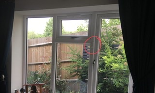

I have some texecom micro-w shock sensors. When looking for advice on where to fit them it is scarce. Lots of conflicting advice about whether to fit them or not, much of which is based on old technology and police only reacting to sensors inside the property. I have PIRs as well but like the idea of the alarm sounding before an intruder gains access. I have already purchased the sensors, job lot of new Wireless sensors, £15 each including vat and delivery. The first three I have positioned as shown on the attached photo, red circle, and testing shows they work. This is based on where I think it should go and a texecom photo on twitter.
So, any advice on where I should be putting them? Windows are upvc. The sensors are very small and inconspicuous.

Positioning for wireless reception, avoid large areas of metal.
Positioning for optimal performance and minimum number of devices, then the testing regime is critical to confirm.
vibrations travel down the frame, they become more noticeable away from the areas where the frame is fixed to the wall.
So central, as for test Texecom have a you tube video that may help you with testing the device correctly.
I would probably try the rea under the little window and test, the points starting with the closest and furthest points from the device.
Thank you for the advice on location and testing. It seems I am on the correct path. The three I have already fitted I ended up setting them at sensitivity 3, a bit more sensitive than the recommended sensitivity 2 for windows.
