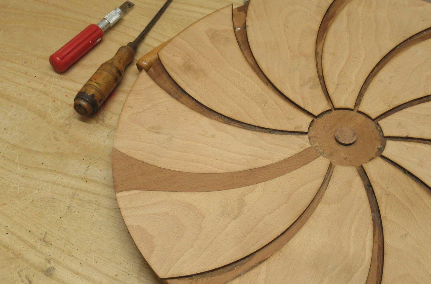

A Spiral Table

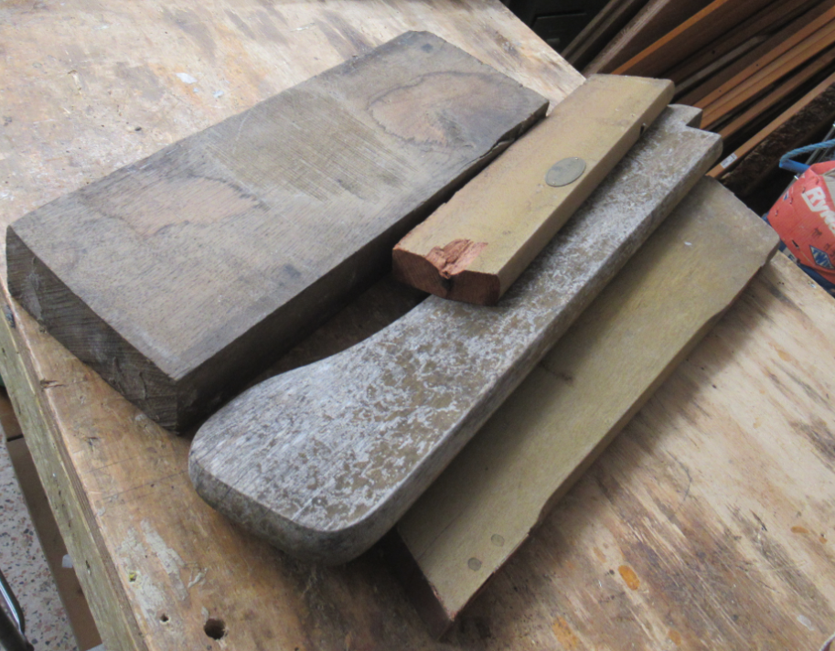

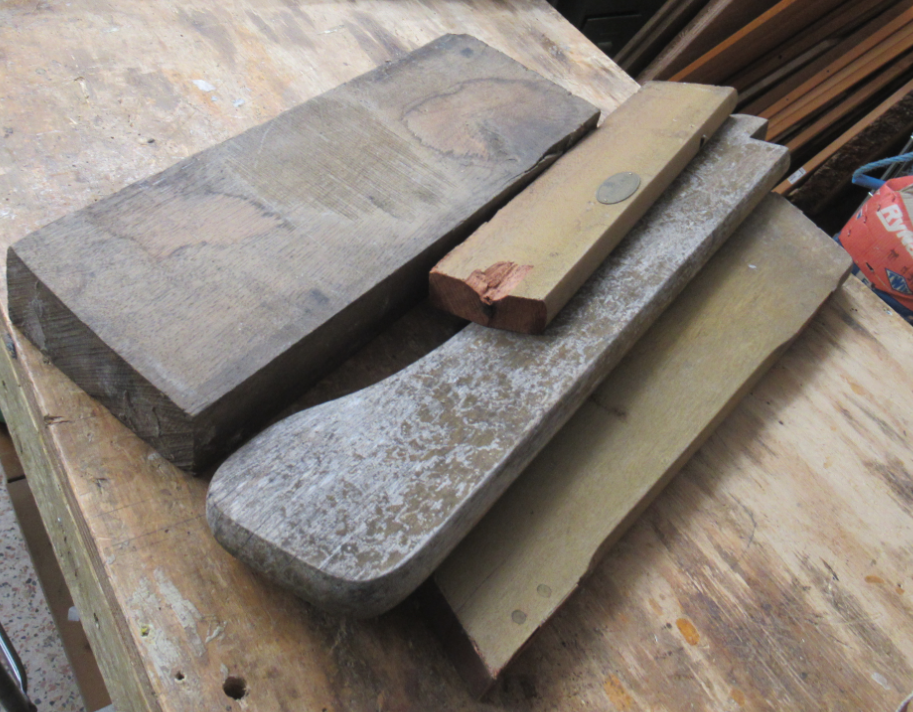

ahh ok that makes complete sense ---a man after my own heart but here its as an example 6mm thick cut from for example a big chunk off oak perhaps 4x2x9" long no good to man nor beast but cut into sort off tiles say 30x60mm or 45x90 including some end grain for extra variety and gleued onto 12mm ply to make patterned small table tops /pot stands coasters what ever just to use up beautiful wood rather than just burn
Aye, thats a big part of it for me, making something nice out of stuff that getting thrown away. So free wood and access to a wonderful workshop with top quality machinery (providing I do ll the maintenance) I can spend hours making stuff

Hmm - we don't like it, looks like a fan blade or jet engine
oh bugger!

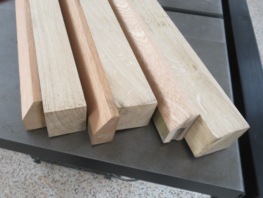

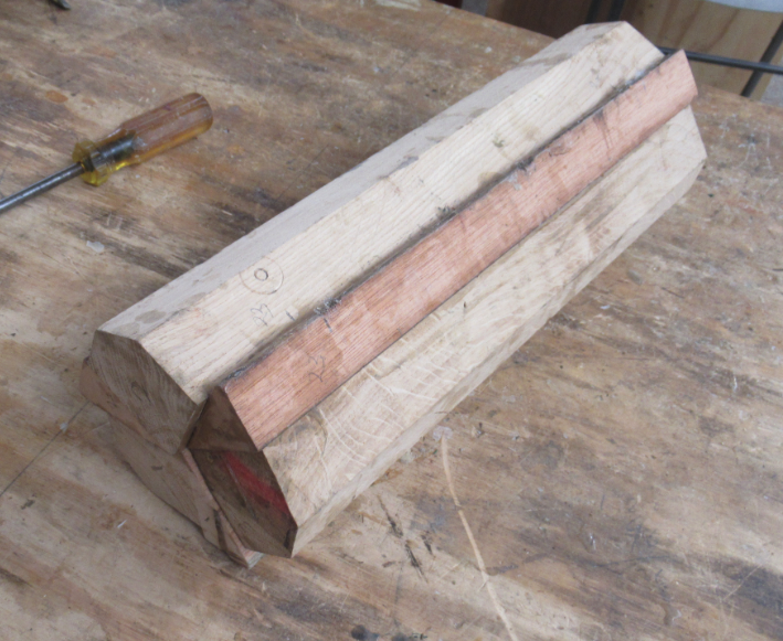

so here is some teak and a chunk of Oak - jeez that Oak is heavy, seriously heavy

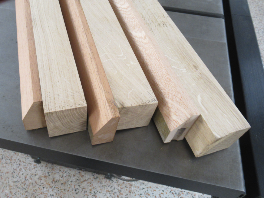

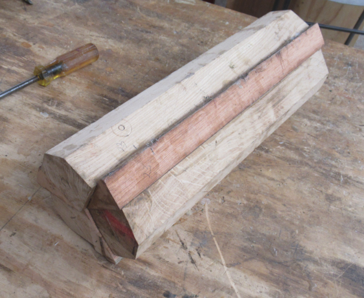

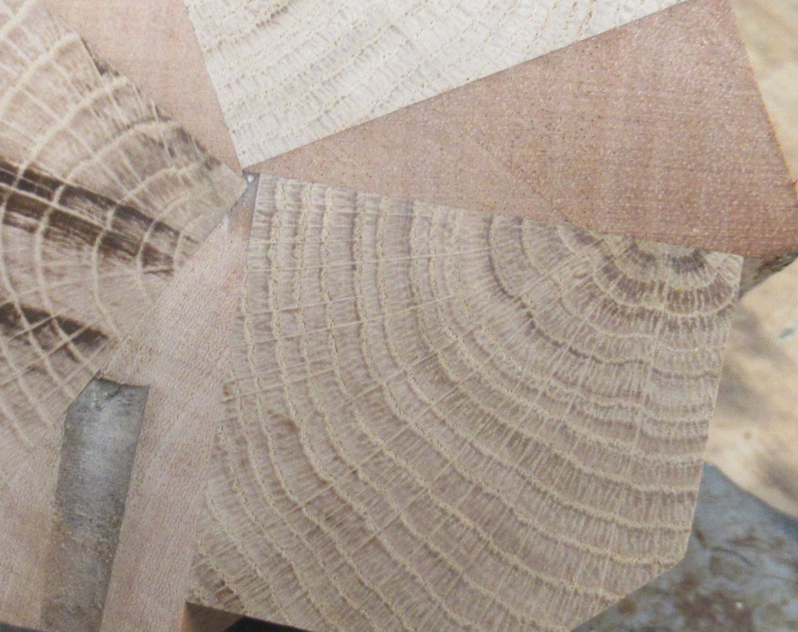

hopefully it will be come apparent what I am doing. have cut some square bits of Oak, then glued Teak onto it, then planed one edge of it down to 120° - if I have been accurate they should all join together into one piece

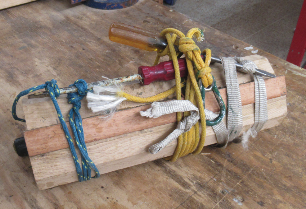

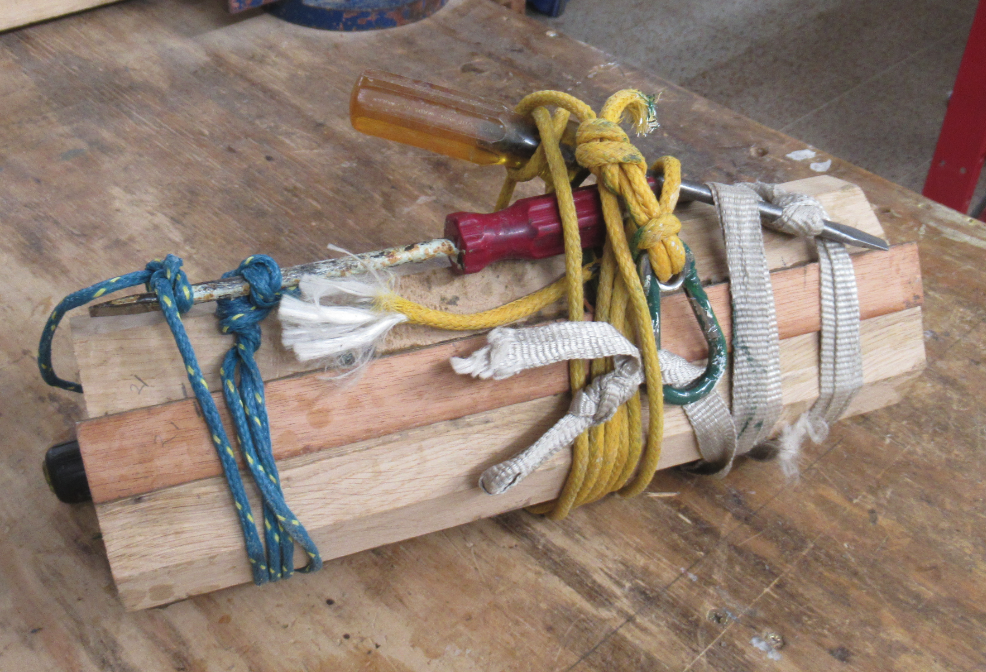

and then glued them all together, clamping them together is difficult so just used Spanish Winlass's amazing how tight you can make these
and with the ropes off

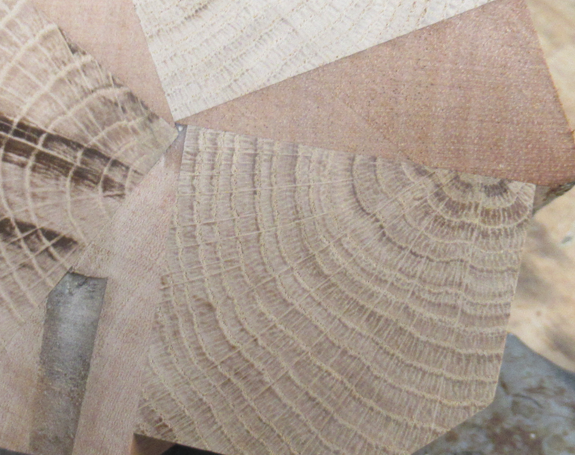

and look at the end grain on the Oak - isn't that something.
can see all the medullary rays, beautiful feature of Oak - can even see all the porous holes that distinguish it as a hard wood

and twisting cords 'ropes and string with screwdriver how we all started out as fred dibbiner said "back street mechaniking "

Quarter Cut Oak - mate of mine has some of that but wants it for himself, it was flooring he lifted a few years back, can you imagine that, a floor made from 1¼" Quarter cut Oak, could make something really special out of that

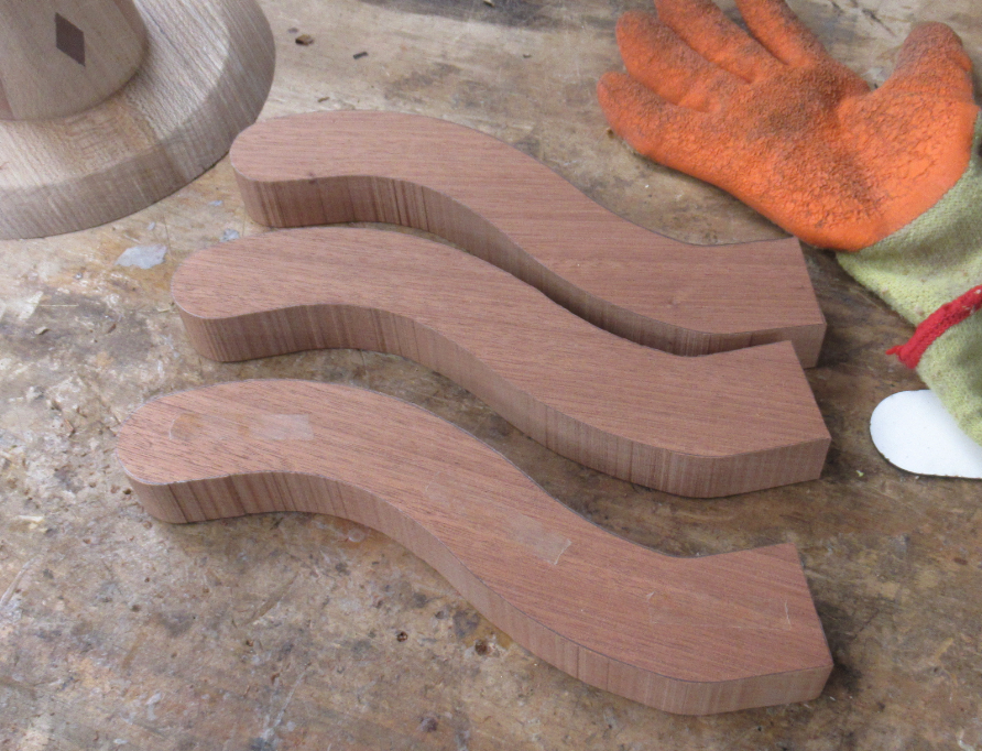

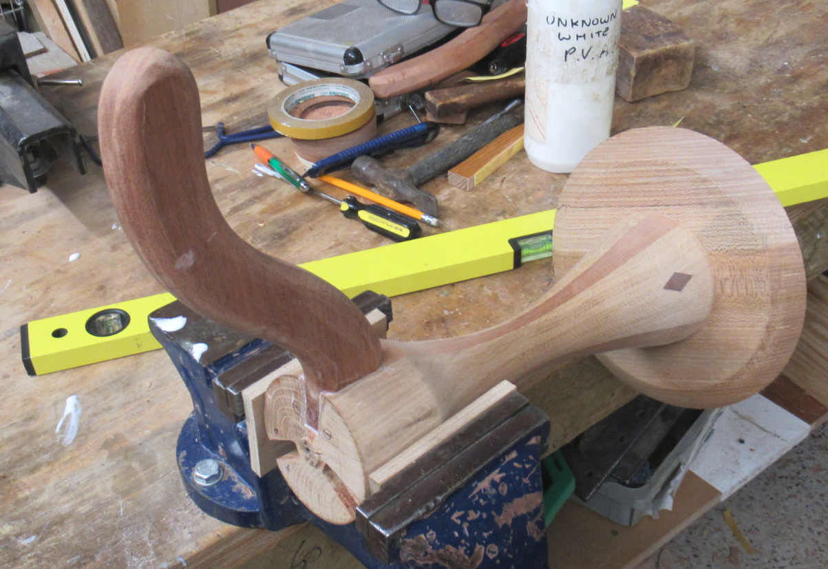

Anyway, onto the pedastal leg

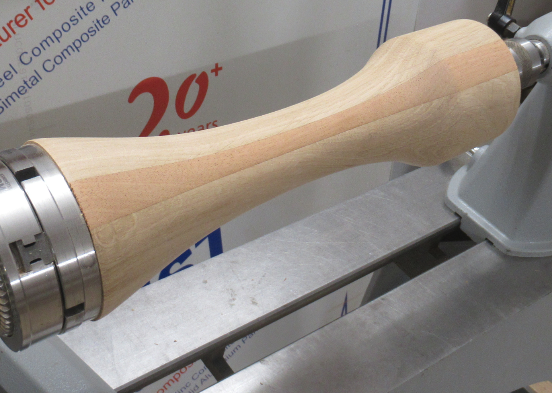

Got it onto the lathe

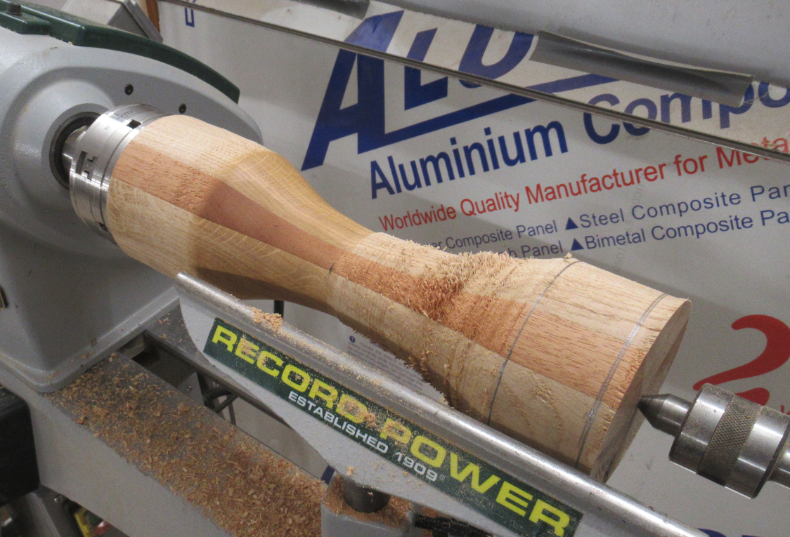

starting to take shape
I hope the teak darkens a lot more than the Oak, I want a good contrast
bit of a disaster on the next stage that I have managed with many hours of work to turn into a feature
see where the diamond inlay is. When I was turning the piece a small hole appeared in the wood, I thought it was a fault in the wood, but then another hole appeared in a simillar place - it was the end of the screws that was holding the piece to the chuck plate - couldn't quite believe such a schoolboy error
Anyway, turned it into a feature with some black Walnut

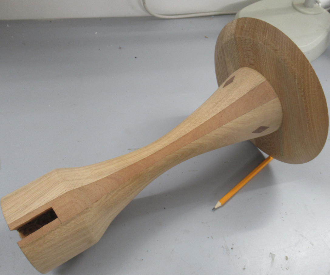

got the end morticed too
then got the feet cut out
and the first one glued in

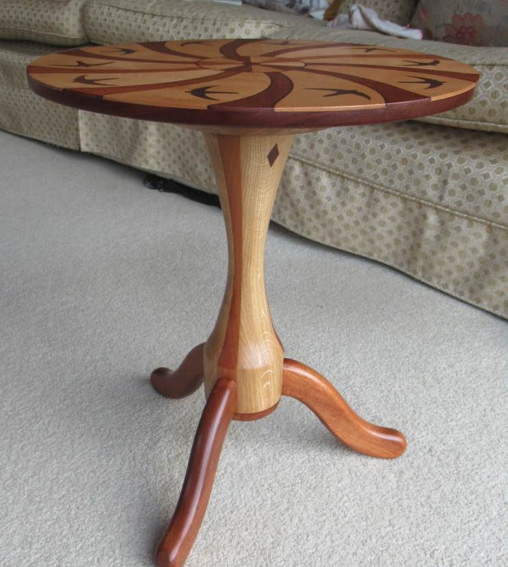

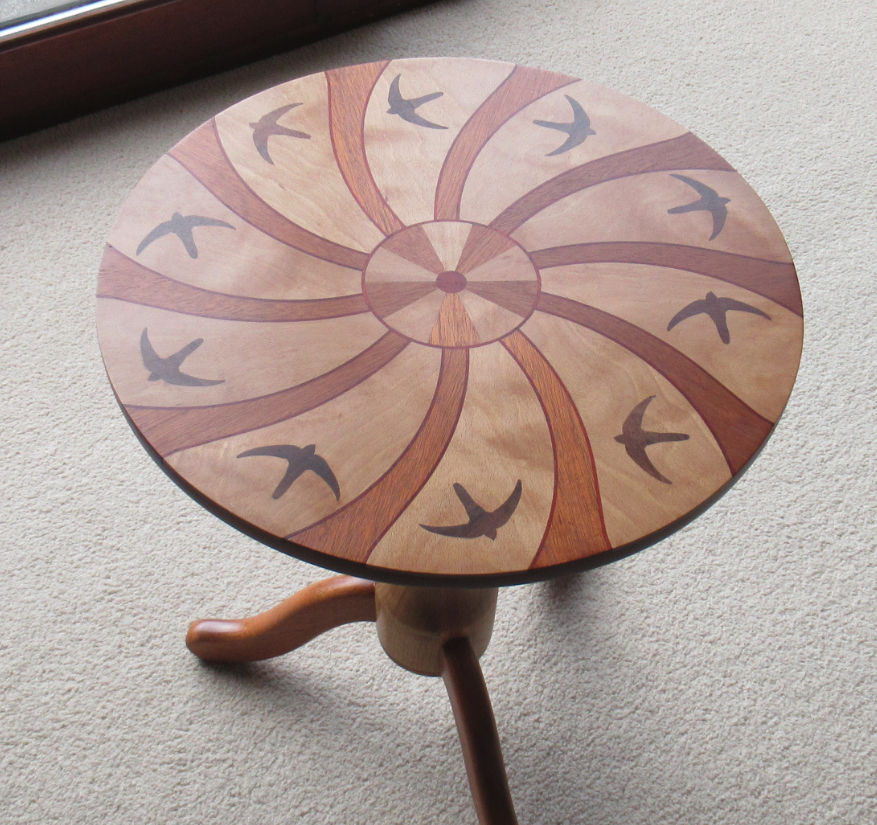

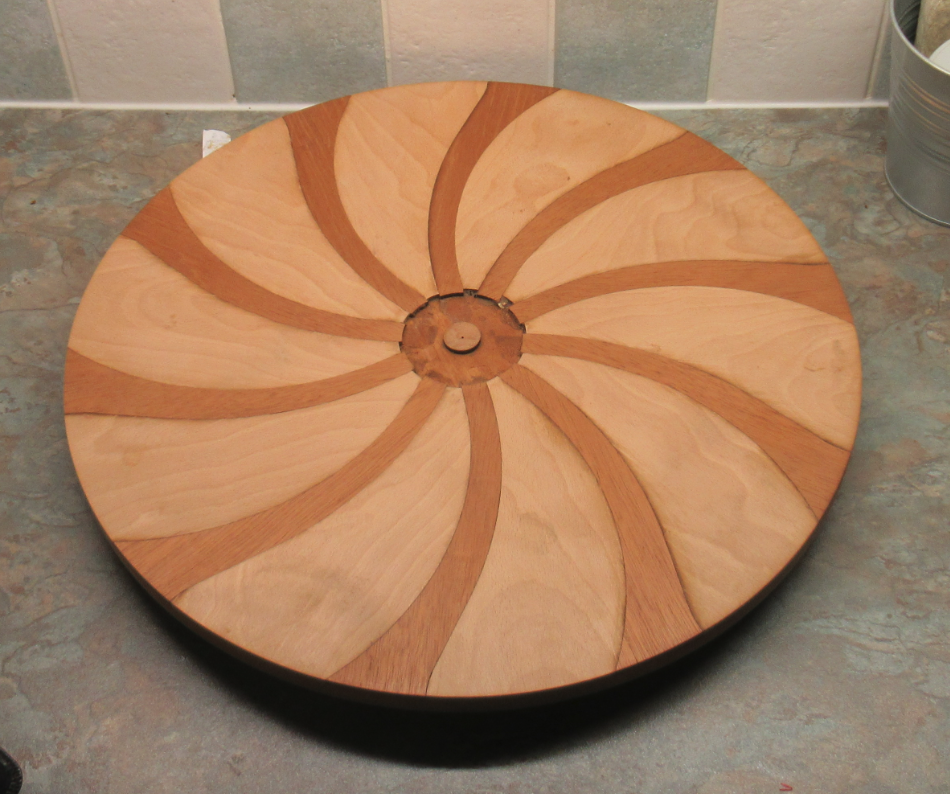

A bit late but finally finished (top needs buffed up in a weeks time)
made entirely out of scraps of wood that were destined for kindling or the skip
only think bought was the danish oil
quite magnificent well done
your skills in that area are far greater than mine so i am in awe again well done
i thought your thoughts and planning were a bit disjointed as i read it ----shows you how wrong we can be you had a full game plan i could not fully see again brilliant
