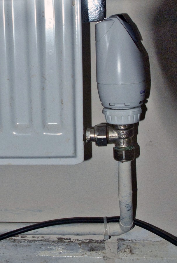

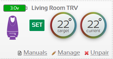

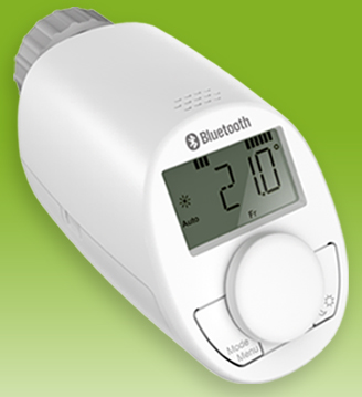

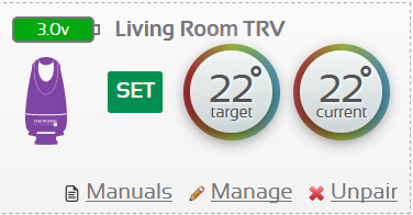

My thermostats all have the target set on them, but at least 6, do not show current, 61dmtMm13BL.jpg this head shows only the target, same with wall thermostats,

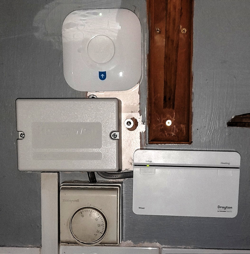

they rely on some other method of telling the occupants how well the heating is working. Even those which do allow us to see the current, IMGP8041.jpg one can only see the current TRV_report.jpg with a PC, tablet, or phone. There were HMI devices (Human machine interface) EVO-home1.jpgwhich did not need phones etc, to see what is going on, but these seem to have gone out of favour, being able to sit in one's chair and say hey google set living room to 22°C is all well and good for those who have the ability to use the new technology, but some people still use thermostats like this, 1768224958847.png one shown is actually in my flat, and no amount of talking to it will alter its settings. And located in the kitchen, that is not really the ideal place to control 4 rooms. Since the flat, where this is, is not used much, it has never been upgraded, it does seem odd, Thermostats_tonemapped.jpg to see the old unit, still used, nested between the Nest and Wiser hubs, but this is the problem when someone makes a broad statement, there will be so many homes where the statement is not true, and we risk leaving people cold by giving miss-information.

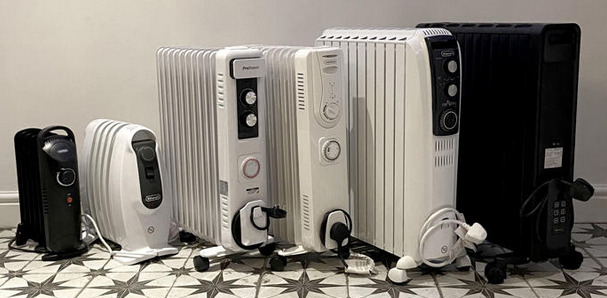

I had this talk with my daughter, she had a 3 kW oil filled radiator, but it is half the physical size of my central heating radiators which are rated at 2 kW, so best output one can expect is 1 kW very soon after switching on it is going to start cycling on/off, the picture shows 1768227326427.png an array of units, all with some thermostatic control, so that 13.8p and 69.2p per hour are pointless figures to quote, as set to say 20°C they will all use the same amount of power, OK less than the central heating, as central heating sends some heat out of the flue, but the fuel costs 5 times as much, to oil or gas.
