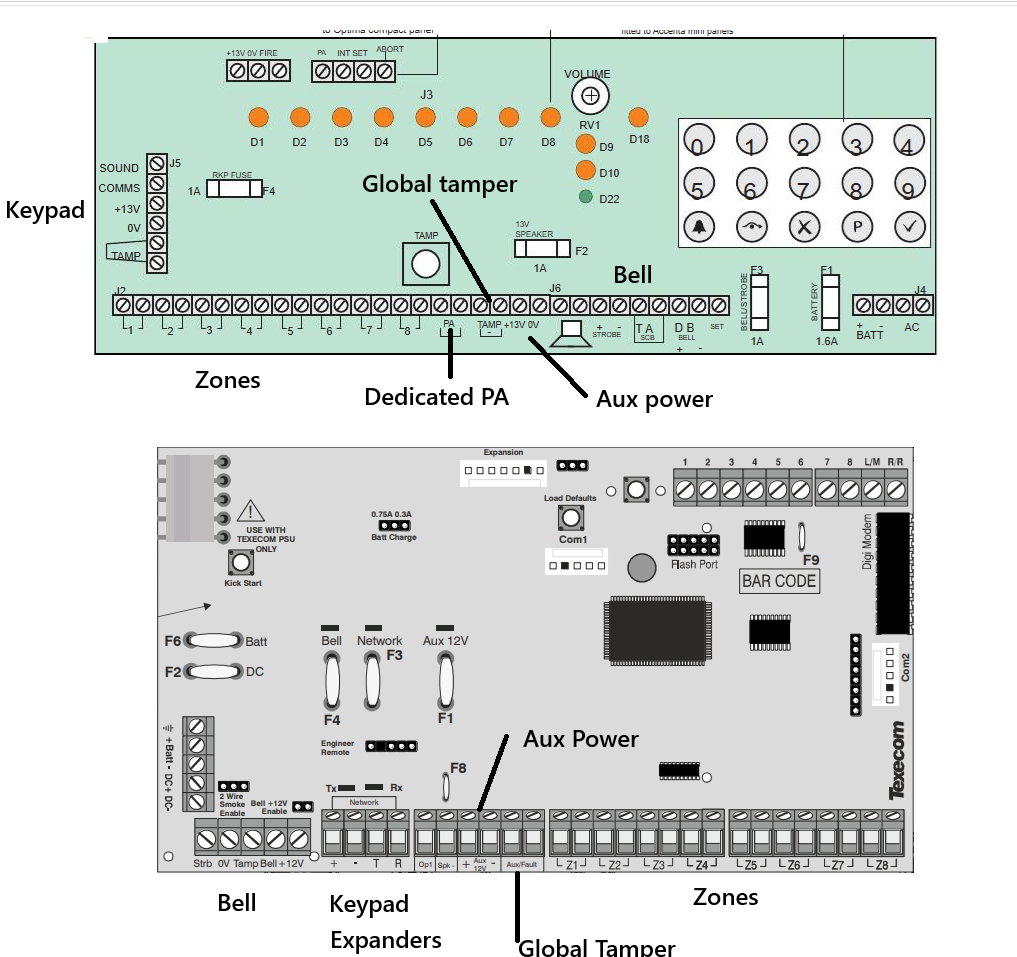

The Accenta 8 is a hard wired panel and everything is normally closed, wiring wise an Elite 24 would be very similar, in that 2 terminals per zone and a global tamper circuit.

If deciding on Texecom, I'd recommend using the 48 panel, this has the option for 4 wire zone connections, meaning instead of a global tamper-where all the the tampers are connected in series-each zone has its own tamper connection.
If you ever have a tamper fault, it will give the exact zone involved, with a global tamper you'd have to start breaking the fault down, using a multimeter etc, to identify which circuit has an issue.
Obviously the 48 is a tad overkill as far as zones go, but for the extra pennies it can prove useful if/when faults manifest themselves.

you need a minimum of 6 hardwired zones going back to the alarm panel, some accenta/ optimas had keypads that could take a door contact zone, but cant remember the model and don't think that applies to yours.

I cant asses your technical competency, them main concern should be the isolation of the live cables.
In terms of wiring what will be very different are the keypad wiring and the bell box wiring , pa buttons and fire sensors.
download some manuals for what you have now and the other systems
In terms of the Accenta
There are free versions around of the Accenta basically follow the same sort of wiring. apologies for the roughness but just put it together
